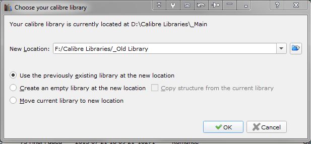

@ChadG - I would have copied the old library folder (lock, stock and barrel) to new computer, and used the Switch/Create library option to tell calibre it's there, viz:
Then select all the books in the old library (or the new one if fewer books), and use the Copy to Library feature to copy the books into the other library. The Copy to Library option should be in Book List context menu, or you can add it to Main Toolbar via Preferences->Toolbars
If you can backout what you did, maybe via restoring the new library from a backup - you could do something like the above. Let us know if that's not possible, and someone will have some suggestions what to do.

The 'Copy the entire folder' to the new Computer is the only proper way to get success.
Never` 'Add' (or Remove/tamper) with the valid contents of a Library folder from the OS. AND Thrice never, overlay the contents (empty and replace is OK if complete Library contents)
Note You CAN change the main Library Folder name as part the copy, You will need to use the Switch/Create menu to learn the new name (location)
The Library name is the Parent Folder Name
Old PC: Calibre Library
The New PC already has one (having 2 would be confusing, but you can , as long as they are on different paths)
New PC:
(the old one pasted)Calibre Library=>Old PC Library <(the name is your choice)

Switch to the SOURCE Library
Select books: (rightclick):copy to Library (option)
All that is needed is that you have viewed the Library With the current instal so it will be on the switch List of the Library Icon
