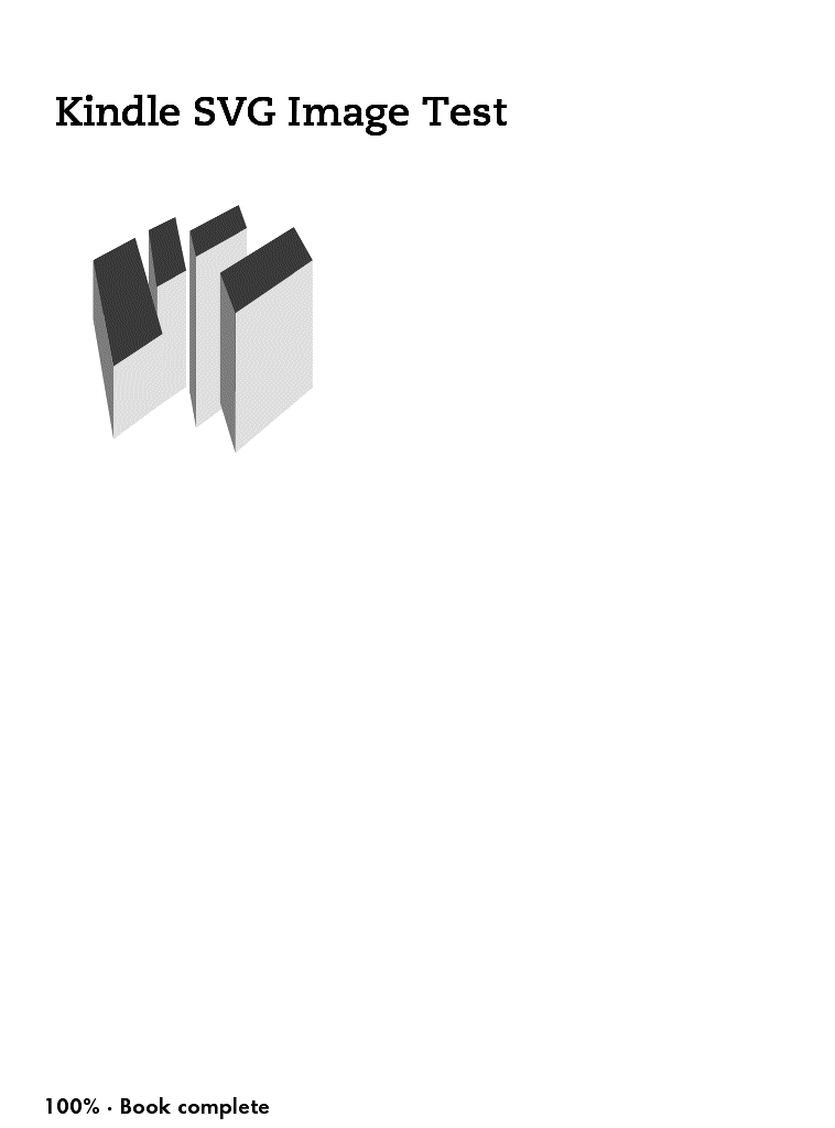

I just found out the hard way that SVG graphics don't convert to Kindle.
At least, the pages that used them did not appear whether I converted using Calibre or Kindle Preview.
I had habitually used the code Sigil makes for covers to do this; the covers work because Kindle actually ignores the cover HTML and just gets the image to use for its cover.
AlanHK is offline   Reply With Quote
Old 04-09-2015, 05:17 AM   #6
Doitsu
Doitsu's Avatar
Posts: 5,941
Karma: 24259515
Device: Kindle PW2
KindleGen doesn't support the SVG wrapper code used by Calibre and Sigil, however, if you mark the cover image in Sigil via Add Semantics > Cover Image, it'll be used by KindleGen (and Calibre).
Actual SVG image files are supported in AZW3 files. For an example, see the attached files.
More information about supported SVG tags and elements can be found in the Kindle Publishing Guidelines.
