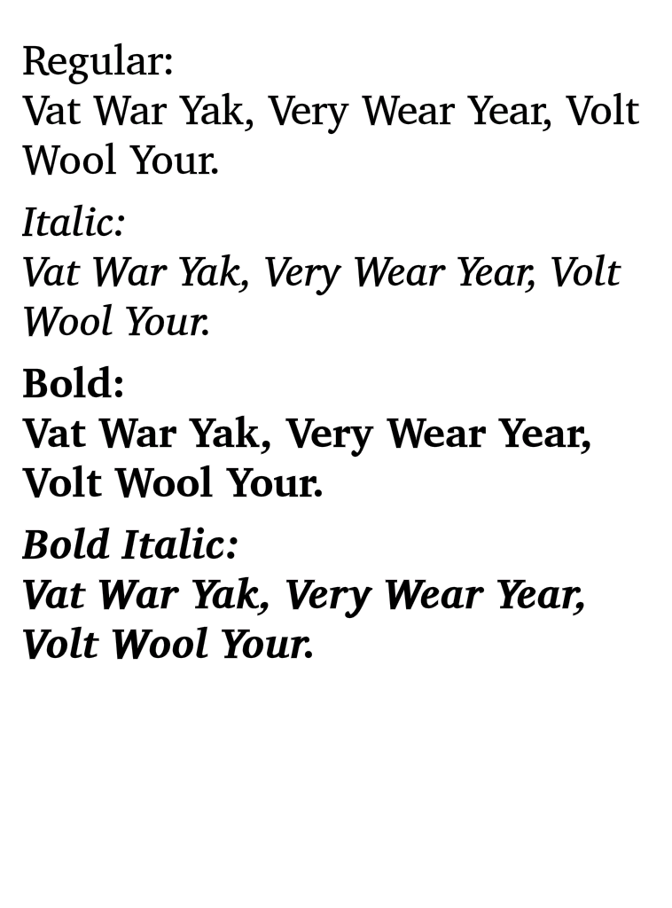

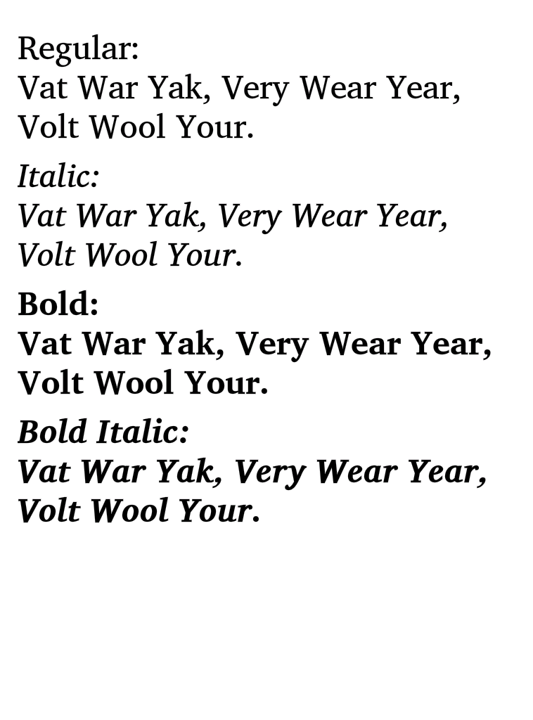

How to enable KEPUB kerning for sideloaded fonts
Until now all of the sideloaded fonts containing kerning tables that I had tried, whether OTF or TTF, functioned as expected in the EPUB reader but remained unkerned in the KEPUB reader.
But I found that converting the font to TTF in Fontforge with the "Old style kern" option enabled allows the kerning to work in the KEPUB reader too.
For example, I tried the Charta font from this thread with the KEPUB reader on my Glo (firmware 3.13.1), the first screenshot is with the font in OTF format, the second converted to TTF with the "Old style kern" option enabled:

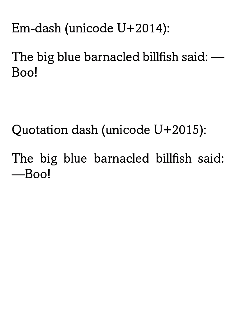

Sorry I didn't mean to imply that the quotation dash would avoid the kepub bug that adds extra space after some punctuation. But it does avoid another problem with using an mdash as a quotation dash, that of the reader treating the dash as a line break point.
The actual size and bearing of the quotation dash will be defined by the font you use, and with the kepub reader if the font lacks a quotation dash then it will substitute one from another font, which might not match the size of the mdash in the current font.
The screenshots attached show the difference between a quotation dash and an mdash, using the Amasis font in the epub reader (it works the same in the kepub reader except for the punctuation/justification bug) -- both readers allow a line break after the mdash, but not after the quotation dash:
(But in the end, if you want good typography then you need to sideload the book as an epub and use the epub reader. The kepub reader has some extra features like stats and image zoom, but it fails at basic stuff like justification, hyphenation, word spacing, etc.)
