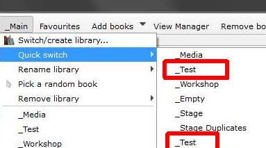

@theducks - psst - calibre can support two libraries with same name (must be in different locations), no need to rename with OS, can be done with calibre.
Attachment 136209
Psst! I know that.
The whole purpose was to make it clear WHICH you were working with at any moment
