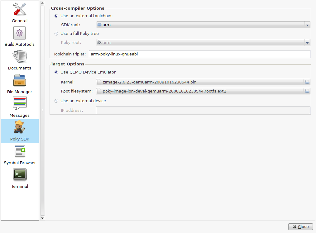

I'm using Hardy, but I installed the scripts from the Gutsy repo. I haven't had any problems.
I'm attaching my preferences screen.
See if you can start the emulator first. It's under tools, then "Start Qemu" when the poky plugin is enabled.
If that works, try to compile a program. Hello World from iRex's repo should be a good start.

The preferences I'm using are the same that you're showing.
Tools -> Start QEMU works!
Opening up the Hello World project from iRex works too!
Now I have to figure out how to build the project and test it with QEMU.
