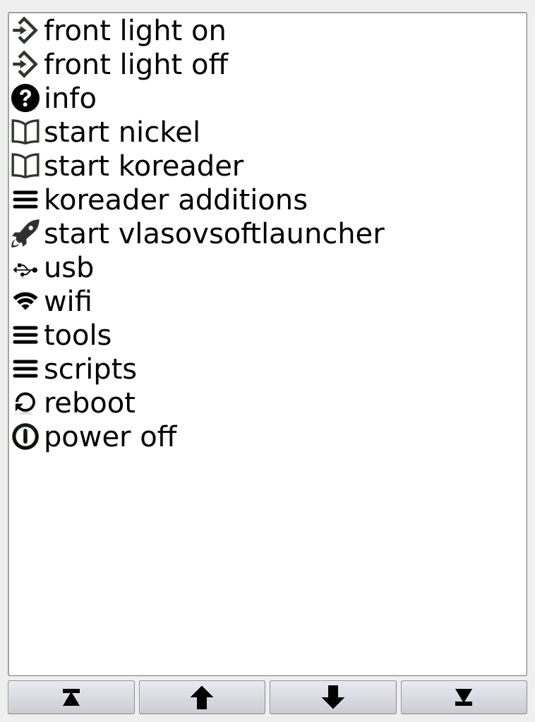

With these settings on my aura I can see the vertical part of "r" in vlasovsoflauncher. Default settings I can see only vlasovsoftlaunche.
The default font size must be too huge. I tried to go by information a gathered from users, but it seems this value is off. The screen shot shows the default look of the Glo.

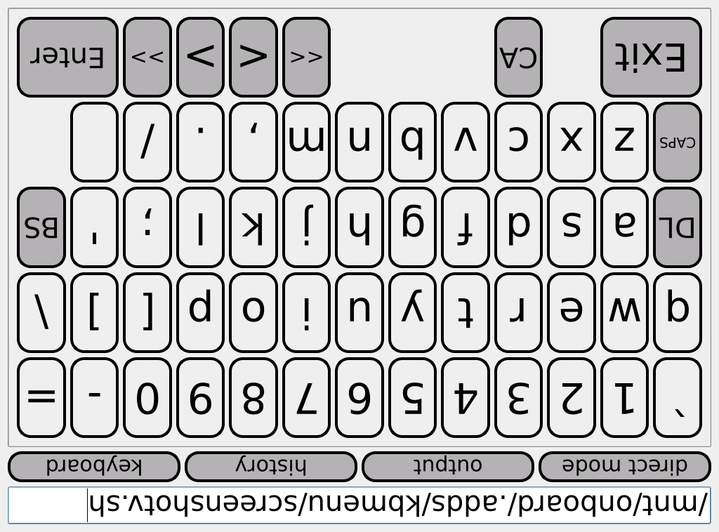

I try to produce something that is easy to handle (or so I say), if you do not have telnet access to your device.
  • copy screenshotv.sh (which you can find in the attached archive) into .adds/kbmenu.
  • safely eject the device and select "usb disable.sh"
  • select (from KSM home) "tools" > "start kbterminal.sh"
  • type /mnt/onboard/.adds/kbmenu/screenshotv.sh
  • press the buttons "keyboard" and then "Exit"
  • connect via usb to the pc and find screen_20150220_xxxxxx.log and screen_20150220_xxxxxx.png in the root folder
The content of the log file looks like this:
