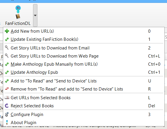

@Jimm: I think it would be nice if you could extend the default action settings in the "GUI Options" menu of the configuration dialogue. I would like to be able to get FFDL to check the emails by simply clicking on it, instead of defaulting to the add- or update-dialogue.
I use hot-keys for Add, Update, Config, Get from Email, etc. I suggest trying that.

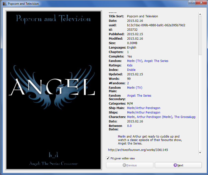

Do you by any chance know how to make an url clickable?
Like the one I have in the bottom for the story?
Name:	Skærmbillede 2015-02-16 11.20.49.png
Tanjamuse is offline
Old 02-16-2015, 11:42 AM   #3734
cryzed
cryzed ought to be getting tired of karma fortunes by now.cryzed ought to be getting tired of karma fortunes by now.cryzed ought to be getting tired of karma fortunes by now.cryzed ought to be getting tired of karma fortunes by now.cryzed ought to be getting tired of karma fortunes by now.cryzed ought to be getting tired of karma fortunes by now.cryzed ought to be getting tired of karma fortunes by now.cryzed ought to be getting tired of karma fortunes by now.cryzed ought to be getting tired of karma fortunes by now.cryzed ought to be getting tired of karma fortunes by now.cryzed ought to be getting tired of karma fortunes by now.
cryzed's Avatar
Posts: 408
Karma: 1050547
Join Date: Mar 2011
Device: Kindle Oasis 2
I think this question came up a few times before, and it's currently not possible in Calibre IIRC.
