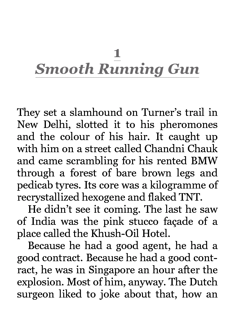

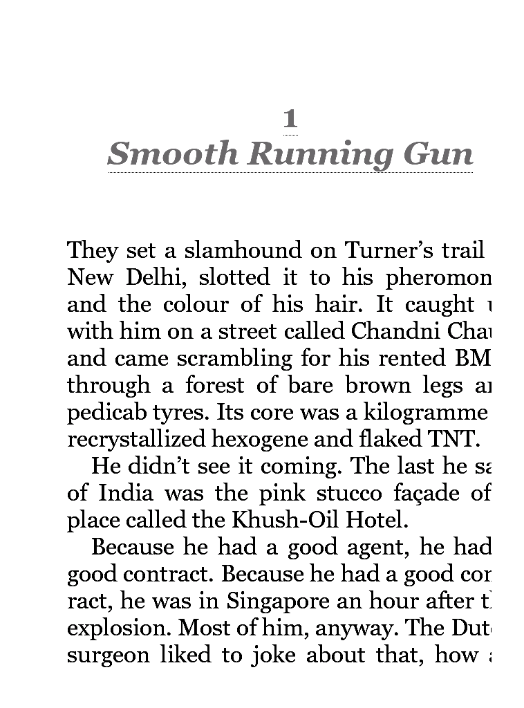

`KePub zero body margin/padding` patch
This patch is a work-around for the problem where the text of some KePubs gets shifted to the right and cut off at the right margin in full-screen reading mode. It adds the following clause to the device's built-in KePub stylesheet:
body{margin:0!important;padding:0!important}

Attached are screenshots from my Glo showing a Kobo synced KePub affected by this problem (this one) in full-screen mode with and without this patch.
ID:	135014   Click image for larger version
