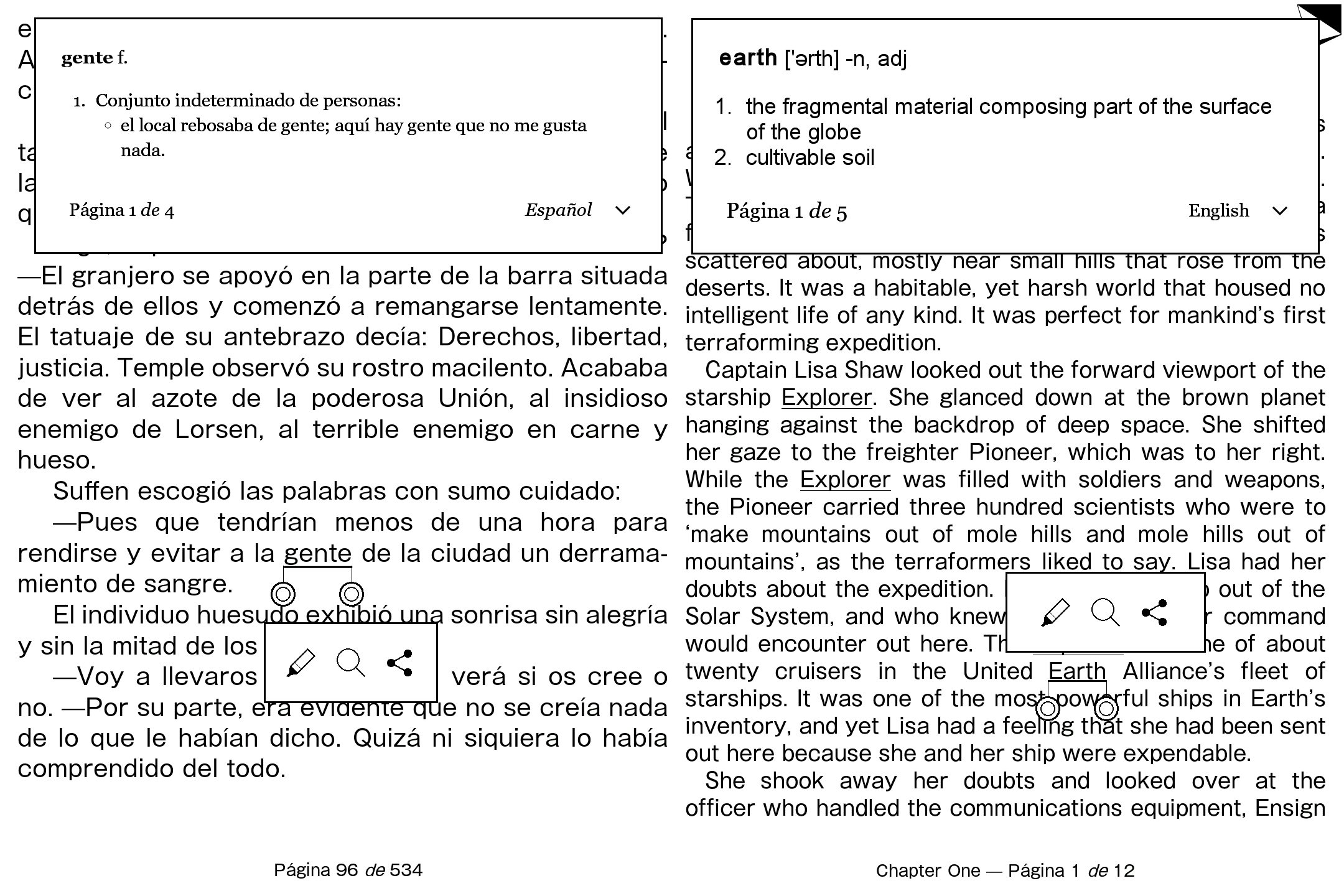

This is my settings. I used only five patches and I modified values to adjust the size of text menus and dictionary, change the font and change italic format.
My changes in the patches are marked in red.
libnickel.so.1.0.0.txt:
sourcefile=libnickel.so.1.0.0
targetfile=..\3.13.1_target\usr\local\Kobo\libnickel.so.1.0.0
// -------------------------------------------------- Dictionary
<patch>
name=Dictionary (Gothic)
note=if you use this definition, disable the two other Dictionary definitions
enabled=true
action=replace_string
position=BF4EC8
oldpart=* { font: %1px %2; line-height: %5em; }\n
oldpart=div.descriptionFont { font-family: %3; }\n
oldpart=ol { font-size: %1px; font-weight: bold; margin-left: %4em }\n
oldpart=ol p { font-size: %1px; font-weight:normal; }\n
oldpart=b { font-weight: bold; }\n
oldpart=i { font-style: italic; }\n
oldpart=b * { font-weight: bold; }\n
oldpart=i * { font-style: italic; }\n
oldpart=::selection { background: #FFFFFF !important; }
newpart=* { font-family: Arial;font-size: 36px; line-height: 41px; }\n
newpart=ol {margin-left: 4px}\n
newpart=ol p { font-size: 38px; font-weight:normal; }\n
newpart=b { font-weight: bold; }\n
newpart=i { font-style: italic; }\n
newpart=b * { font-weight: bold; }\n
newpart=i * { font-style: italic; }
newpart=::selection { background: #FFFFFF !important; }
combineparts
</patch>
// -------------------------------------------------- unspecified, increase by 50%
<patch>
//opciones inicio
name=?
enabled=true
position=C04A38
oldpart=TouchLabel[qApp_deviceIsDragon="true"] {\n\tfont-size: 36px;\n\tfont-family: Georgia;\n\tfont-style: italic;\n\tpadding-left: 10px;\n\tpadding-right: 15px;\n}\n\n
oldpart=TouchLabel[qApp_deviceIsAlyssum="true"] {\n\tfont-size: 39px;\n}\n\n
oldpart=TouchLabel[qApp_deviceIsPhoenix="true"]{\n\tfont-size: 28px;\n\tfont-family: Georgia;\n\tfont-style: italic;\n\tpadding-left: 5px;\n\tpadding-right: 10px;\n}\n\n
oldpart=TouchLabel[qApp_deviceIsTrilogy="true"] {\n\tfont-size: 24px;\n\tfont-family: Georgia;\n\tfont-style: italic;\n\tpadding-left: 10px;\n\tpadding-right: 10px;\n}\n\n
oldpart=TouchLabel[qApp_localeName="ja_JP"] {\n\tfont-family: A-OTF Gothic MB101 Pr6N;\n\tfont-style: normal;\n}\n\n
oldpart=#footer[qApp_deviceIsDragon="true"] {\n\tqproperty-leftMargin:60;\n\tqproperty-rightMargin:60;\n\tmin-height:140px;\n\tmax-height:140px;}\n\n
oldpart=#footer[qApp_deviceIsPhoenix="true"]{\n\tqproperty-leftMargin:40;\n\tqproperty-rightMargin:40;\n\tmin-height:95px;\n\tmax-height:95px;\n}\n\n
oldpart=#footer[qApp_deviceIsTrilogy="true"] {\n\tqproperty-topMargin:30;\n\tqproperty-leftMargin:30;\n\tqproperty-rightMargin:30;\n\tmin-height:99px;\n\tmax-height:99px;\n}
newpart=TouchLabel[qApp_deviceIsDragon="true"] {\n\tfont-size: 46px;\n\tfont-family: A-OTF Gothic MB101 Pr6N;\n\tfont-style: normal;\n\tpadding-left: 10px;\n\tpadding-right: 15px;\n}\n\n
newpart=TouchLabel[qApp_deviceIsAlyssum="true"] {\n\tfont-size: 54px;\n}\n\n
newpart=TouchLabel[qApp_deviceIsPhoenix="true"]{\n\tfont-size: 38px;\n\tfont-family: Georgia;\n\tfont-style: italic;\n\tpadding-left: 5px;\n\tpadding-right: 10px;\n}\n\n
newpart=TouchLabel[qApp_deviceIsTrilogy="true"] {\n\tfont-size: 34px;\n\tfont-family: Georgia;\n\tfont-style: italic;\n\tpadding-left: 10px;\n\tpadding-right: 10px;\n}\n\n
newpart=TouchLabel[qApp_localeName="ja_JP"] {\n\tfont-family: Georgia;\n\tfont-style: normal;\n}\n\n
newpart=#footer[qApp_deviceIsDragon="true"] {\n\tqproperty-leftMargin:60;\n\tqproperty-rightMargin:60;\n\tmin-height:140px;\n\tmax-height:140px;}\n\n
newpart=#footer[qApp_deviceIsPhoenix="true"]{\n\tqproperty-leftMargin:40;\n\tqproperty-rightMargin:40;\n\tmin-height:95px;\n\tmax-height:95px;\n}\n\n
newpart=#footer[qApp_deviceIsTrilogy="true"] {\n\tqproperty-topMargin:30;\n\tqproperty-leftMargin:30;\n\tqproperty-rightMargin:30;\n\tmin-height:99px;\n\tmax-height:99px;\n}
combineparts
</patch>
ID:	135231   Click image for larger version
ID:	135232   Click image for larger version

Originally Posted by tshering View Post
Thank you for your efforts! I attach the data in patch format. I left however all values unmodified, since I did not find the time to figure out nicely working values yet. If you (or anybody else) has values that work for him/her satisfactorily, please share them!
Just in case you are interested in experimenting with other css blocks too, I add all materials that I could easily find.
Originally Posted by Cecell3000 View Post
I have managed to increase the size of the popup window, but not full text. How did you get it? I do not know what values to change.
ID:	136270   Click image for larger version
For example, Glo, FW 3.13.1, changes marked in red. For clarity, I changed only the height.
Change 1 (in nickel):
<patch>
name=?
enabled=true
position=2D0215
oldpart=#InlineDictionaryView {\n\tmin-width: 500px;\n\tmax-width: 500px;\n\tmin-height: 220px;\n\tmax-height: 220px;\n}\n
oldpart=#InlineDictionaryView[qApp_deviceIsPhoenix="true"] {\n\tmin-width: 650px;\n\tmax-width: 650px;\n\tmin-height: 280px;\n\tmax-height: 280px;\n}\n
oldpart=#InlineDictionaryView[qApp_deviceIsDragon="true"] {\n\tmin-width: 980px;\n\tmax-width: 980px;\n\tmin-height: 350px;\n\tmax-height: 350px;\n}\n
newpart=#InlineDictionaryView {\n\tmin-width: 500px;\n\tmax-width: 500px;\n\tmin-height: 220px;\n\tmax-height: 220px;\n}\n
newpart=#InlineDictionaryView[qApp_deviceIsPhoenix="true"] {\n\tmin-width: 650px;\n\tmax-width: 650px;\n\tmin-height: 480px;\n\tmax-height: 480px;\n}\n
newpart=#InlineDictionaryView[qApp_deviceIsDragon="true"] {\n\tmin-width: 980px;\n\tmax-width: 980px;\n\tmin-height: 350px;\n\tmax-height: 350px;\n}\n
combineparts
</patch>
Change 2 (in libnickel):
<patch>
name=?
enabled=true
position=BF5688
oldpart=#textEdit {\n\tmin-height: 150px;\n\tmax-height: 150px;\n\tmin-width: 515px;\n\tmax-width: 515px;\n}\n\n
oldpart=#textEdit[qApp_deviceIsPhoenix="true"] {\n\tmin-height: 190px;\n\tmax-height: 190px;\n\tmin-width: 550px;\n\tmax-width: 550px;\n}\n\n
oldpart=#textEdit[qApp_deviceIsDragon="true"] {\n\tmin-height: 235px;\n\tmax-height: 235px;\n\tmin-width: 930px;\n\tmax-width: 930px;\n}
newpart=#textEdit {\n\tmin-height: 150px;\n\tmax-height: 150px;\n\tmin-width: 515px;\n\tmax-width: 515px;\n}\n\n
newpart=#textEdit[qApp_deviceIsPhoenix="true"] {\n\tmin-height: 390px;\n\tmax-height: 390px;\n\tmin-width: 550px;\n\tmax-width: 550px;\n}\n\n
newpart=#textEdit[qApp_deviceIsDragon="true"] {\n\tmin-height: 235px;\n\tmax-height: 235px;\n\tmin-width: 930px;\n\tmax-width: 930px;\n}
combineparts
</patch>
First picture shows effect of change 1. The second shows effect of changes 1 and 2.
ID:	136279   Click image for larger version
