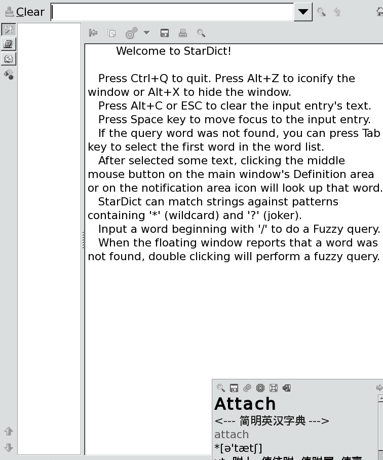

This is a StarDict 3.0.1 porting to iLiad.
I haven't tested it thoroughly.
How to install:
1. download the attachment and unpack it to "programs" dir in your MMC/SD card. There will be a "stardict" dir. The path is mandatory. if you want to install to another place, some modification might be required. Try it yourself
2. download xepdmgr contributed by Antartica and copy the file "xepdmgr" to the above "stardict" dir.
3. some files in /stardict/lib are not necessary and can be removed. I am just too lazy to check it.
How to operate:
1. There is a small icon in the bottom left corner for user to quit the program.
2. dictionary file can be downloaded from StarDict website. Where to put dict files? I don't know. I just checked that it can be started from contentlister.

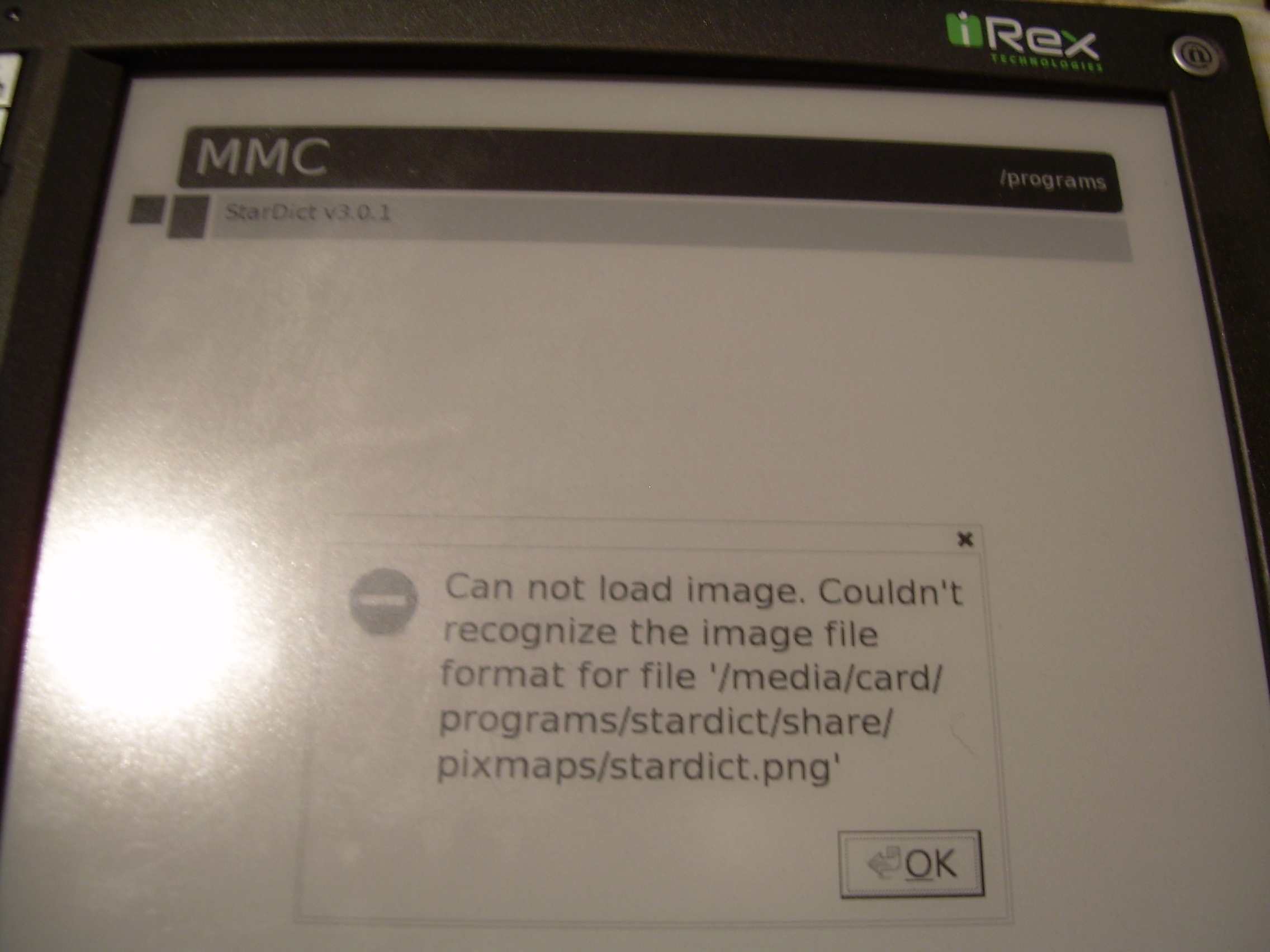

Hi,
I can't get this working!
I have attached a photo with the error message.
I have tried with the file "xepdmgr" from 1.9c version first, then with 1.9b version, with the same result.
Help!

It has nothing to do with version of xepdmgr.
From the attached image, it seems that stardict was started, but failed to load some image file.
I'll see if I can make some further test later.
Before the test is made, I would suggest check if that unloadable image file is damaged

i have downloaded this once and again. Always the same message.
As you can see I installed the new contentlister that shows more items per page (smaller icons and font size)

I can confirm that the package is ok with newlister. The time to start it took too long, but it did work.
I think there must be something wrong with that unloadable image file on your memory card. Maybe it's damaged. It's just a normal png image file. Please open that image file on your desktop to check it.

I can open this image in my pc.
The SD card I am using is almost new and works without any problem.
Maybe it's something wrong with the iliad itself. I will continue checking the unknown words in my dictionary as always
