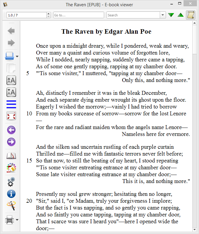

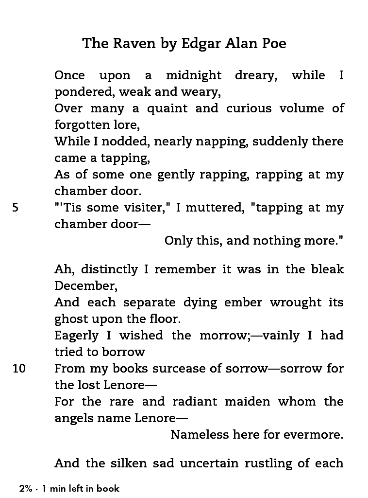

If you have an iPad or a Kindle K3 or higher with the latest firmware and aren't interested in publishing books with KDP, you could give pseudo-elements a try, because they allow you to automatically add line numbers. They also allow you add special formatting to every nth element. (I used both features in my simple test file.)
Unfortunately, the majority of ePub readers and apps don't support pseudo-elements and you can't use counter pseudo-elements in KDP Kindle books according to the official publishing guidelines, even though they work fine.
I slapped together a very simple test file that displays fine with Sigil, Calibre Book Viewer, iBooks (after ePub3 conversion) and on my Kindle PW2. However, it doesn't display correctly with ADE4, even if it's converted to an ePub3 file.
I formatted the poem as an unordered list:
  <h3>The Raven by Edgar Alan Poe</h3>
  <ul>
    <li>Once upon a midnight dreary, while I pondered, weak and weary,</li>
    <li>Over many a quaint and curious volume of forgotten lore,</li>
    <li>While I nodded, nearly napping, suddenly there came a tapping,</li>
    <li>As of some one gently rapping, rapping at my chamber door.</li>
    <li>"'Tis some visiter," I muttered, "tapping at my chamber door—</li>
    <li>Only this, and nothing more."</li>
    <li>Ah, distinctly I remember it was in the bleak December,</li>
    <li>And each separate dying ember wrought its ghost upon the floor.</li>
    <li>Eagerly I wished the morrow;—vainly I had tried to borrow</li>
    <li>From my books surcease of sorrow—sorrow for the lost Lenore—</li>
    <li>For the rare and radiant maiden whom the angels name Lenore—</li>
    <li>Nameless here for evermore.</li>
    <!-- more lines ... -->
  </ul>
And used the following minimal CSS:
ul {
    counter-reset: counter;
    margin-left: .25em;
li {
    counter-increment: counter;
    list-style-type: none;
ul li:nth-child(5n+5):before {
    left: 0;
    position: absolute;
    padding-left: 1em;
    content: counter(counter);
ul li:nth-child(6n+6) {
    text-align: right;
    margin-bottom: 1em;
h3 {
    text-align: center;
ID:	133757   Click image for larger version

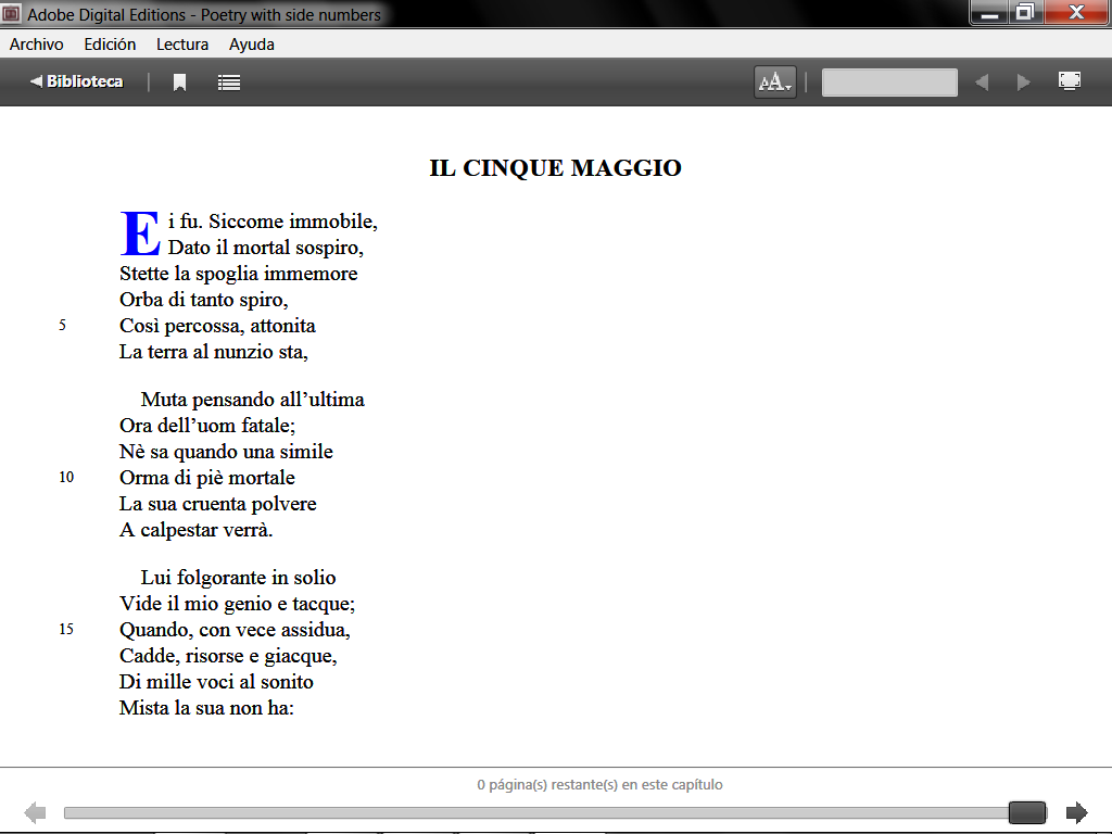

And what about something like this (that also works in any ereader):
The above screenshot belongs to ADE 3.0 and to get that result, you only need a few lines of code:
h3 {
   text-align: center;
.stanza {
   margin-left: 4em;
   margin-bottom: 1em;
.stanza p {
  margin: 0;
  text-indent: 1.2em;
  line-height: 1.2em;
.stanza p + p {
  text-indent: 0;
.stanza p.number {
  float: left;
  margin-left: -4em;
  margin-top: 0.3em;
  font-size: 70%;
and in the .xhtml file:
  <h3>IL CINQUE MAGGIO</h3>
  <div class="stanza">
    <p>Ei fu. Siccome immobile,</p>
    <p>Dato il mortal sospiro,</p>
    <p>Stette la spoglia immemore</p>
    <p>Orba di tanto spiro,</p>
    <p class="number">5</p>
    <p>Così percossa, attonita</p>
    <p>La terra al nunzio sta,</p>
  </div>
    <p>Muta pensando all’ultima</p>
    <p>Ora dell’uom fatale;</p>
    <p>Nè sa quando una simile</p>
    <p class="number">10</p>
    <p>Orma di piè mortale</p>
    <p>La sua cruenta polvere</p>
    <p>A calpestar verrà.</p>
  </div>
    <p>Lui folgorante in solio</p>
    <p>Vide il mio genio e tacque;</p>
    <p class="number">15</p>
    <p>Quando, con vece assidua,</p>
    <p>Cadde, risorse e giacque,</p>
    <p>Di mille voci al sonito</p>
    <p>Mista la sua non ha:</p>
  </div>
So, you only need to add <p class="number">"your number here"</p> in the proper place; everything else is the same you have done always.
Below you can check the respective epub.
Regards
Rubén

Automatic numbering of verses under ADE 4.02
In this post:
https://www.mobileread.com/forums/sho...56&postcount=9
Doitsu developed a clever method to use automatic numbering of verses; he utilized pseudo-elements under the form of unordered list. I borrowed some of his thoughts to do something similar but without using lists. The code I used was as follows:
body {
  counter-reset: verse 0;
h3 {
   text-align: center;
.stanza {
   margin-left: 4em;
.stanza p {
  margin: 0;
  line-height: 1.2em;
.stanza p:nth-child(6n+7) {
    text-indent: 1em;
.stanza p:nth-child(6n+6) {
    margin-bottom: 1em;
.stanza p:nth-child(5n+5):before {
    float: left;
    margin-left: -4em;
    font-size: 70%;
    content: counter(verse);
    counter-increment: verse 5;
.dropcap {
    float: left;
    color: blue;
    line-height: 1.2em;
    font-size: 3em;
    font-weight: bold;
    margin: -0.2em 5px -0.3em 0;
and
    <p><span class="dropcap">E</span>i fu. Siccome immobile,</p>
  </div>
Since Doitsu had already added an automatic bottom margin after the sixth verse, inspired on his ideas, I also added automatic indenting. As we can see, is practically Doitsu's original code but without using unordered list. The ebooks looks great under Sigil, Kindle and surprisingly also works under ADE 4.02 with epub3 conversion. Here you can watch a screenshot:

That means that the ereaders based on RMSDK could show automatic numbering Below you can check the respective epub3 ebook and thank you very much Doitsy for being the first in thinking to use counters for this task.
