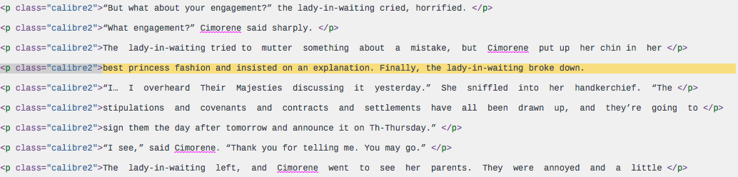

How can I fix it when every line is a paragraph?
I have a book that for some reason has every line, regardless of punctuation, listed as a paragraph. (Please see image)
Is there a way, using the editor, that I can remove all of the paragraph html tags at once ?
I'm practically reading the book as I'm trying to correct it (not an enjoyable experience) and it seems all of the books in this particular group were formated the same way.

That's a poorly converted PDF, if you have the PDF tweak the conversion Line Wrap up a little bit, if its worse tweak it down a bit. You may need to use an alternate converter - there's a sticky thread at the top of the Conversion subforum all about converting PDF's

First of all: remove the
</p>
<p class="calibre2">
which are followed by a minuscule. Use regex:
</p>\n+<p class="calibre2">(?=[a-z])
and for the replacement: nothing or a single space. It will look nicer. Hope this helps.

First, you want to get rid of the useless spaces before the closing "</p>"
Regex #1:
Search: \s+</p>
Replace: </p>
Explanation: What this will do is look for "one or more spaces" + "</p>", and replace it with just "</p>".
Example:
<p>This is a sample line </p>
<p>This is a sample line</p>
Regex #2:
Search: -</p>\s+<p>
Replace:
Explanation: What this will do is remove hyphens at the very end of the "paragraph", and combine it with the next line.
Side Note: I use the above regex on a one-by-one, case-by-case basis, because many "soft hyphens" in the PDF aren't actually a part of the word.
Example:
<p>Blah blah blah govern-</p>
<p>ment.</p>
<p>Blah blah blah government.</p>
Regex #2 (Variant):
Search: -</p>\s+<p>
Replace: -
Note: I don't use this one, although if there are TONS of hyphens at the end of each line, it might be best to do it this way, and take care of the hyphen situation on your own at a later step. I personally prefer to use the Spell Check Tool, and search for a single hyphen by itself: '-'. This will give you a list of every single word with a hyphen in it. Then I can check for + fix mistakes there much more quickly.
Example:
<p>ment.</p>
<p>Blah blah blah govern-ment.</p>
Regex #3:
Search: ([^>”\?\!\.])</p>\s+<p>
Replace: \1
Explanation: What this Regex will do, is search for a paragraph that DOES NOT end in a "greater than sign", "right double quote", "question mark", "exclamation point", or "period". It will then combine it with the next paragraph.
Note: There is a space after the "\1".
Example:
<p>Susie said</p>
<p>that she was going to jump over a tree.</p>
<p>She also said,</p>
<p>that this was just a sample.</p>
<p>Susie said that she was going to jump over a tree.</p>
<p>She also said, that this was just a sample.</p>

Based on what I've seen as I've tried to clean up, I would need Regex #3, however, when I add those search and replace terms I get:
Searching done: Replaced 0 occurrences of ([^>”\?\!\.])</p>\s+<p>
I made sure the mode was set to "Regex".
Regex 1 ran without a problem, and I didn't change anything in the code (I just copied/pasted).
