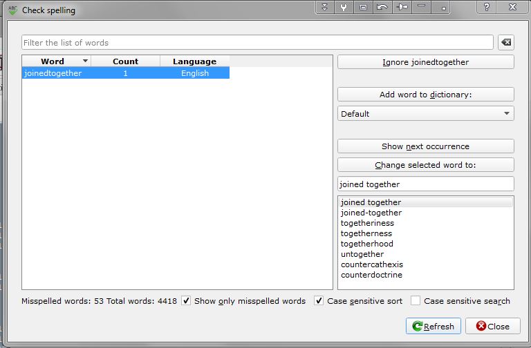

@Paulie_D - the spell checker will usually offer a sensible correction to misspellings caused by two words joinedtogether.
