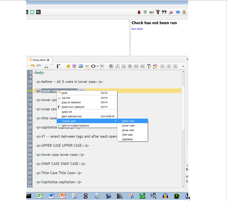

Sorry -- I wasn't very clear.
I select text and then right-click to use the Change Case menu.
It has the 5 operations that I tried
Doing it that way, I don't think I would have a Find expression
I really did look in the manual for using Change Case, but didn't see it

I cannot replace that, selecting mixed case text makes it all uppercase. Note that when you right click the editor might automatically adjust your selection, look at what is selected when the right click menu pops up

You are right -- the editor seems to be adjusting my selected text based on the fact that the second case below seems to be in mixed case
In both cases I selected the text with the mouse from right to left
In the first the "nice text in one case" remained selected after a right click
In the second only the "aaaa" remained selected after a right click

Update -- what seems to make the difference for the editor adjusting the selection is the right-click spell checking kicking for the nonsense text I was using to test. If I use ALL real words in mixed case ...
  <p>original = cat doG bird hoUSE Car boat TRAIN</p>
  <p>after    = CAT DOG BIRD HOUSE CAR BOAT TRAIN</p>
... then the Change Case works
But what was/is confusing me was the sensitivity of the editor's changing the selection depending on the cursor position after selecting the test.
Below when I selected the text between the tags, and right click on a real word (e.g. doG) all text remains selected and no spell check correction pops up and Change Case happens as expected. However if I select a word not in the dictionary (even though it should be ) only that word is selected since the spell check popup seems to take precedence and Change Case is applied to only the single selected word
  <p>after    = cat doG bird hoUSE Car boat TRAIN KovidGoyalIsGREAT</p>

Simply right click outside the selection and it will not be auto-adjusted at all. The selection is auto-adjusted only when the cursor is in a word marked as being misspelled, this allows for simple replacement of misspelled words by right clicking on them.
