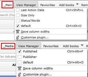

Old 11-16-2014, 12:19 AM   #14
Posts: 22,034
Karma: 30277960
That is an option for FFDL.
But Reading List, View Manager and Open With all add menu items that can be assigned shortcuts based on what you configure--IE, what Reading Lists you have, what programs you configure to Open With, etc.
With View Manager the shortcuts are library dependent - see attachment
BetterRed is offline
