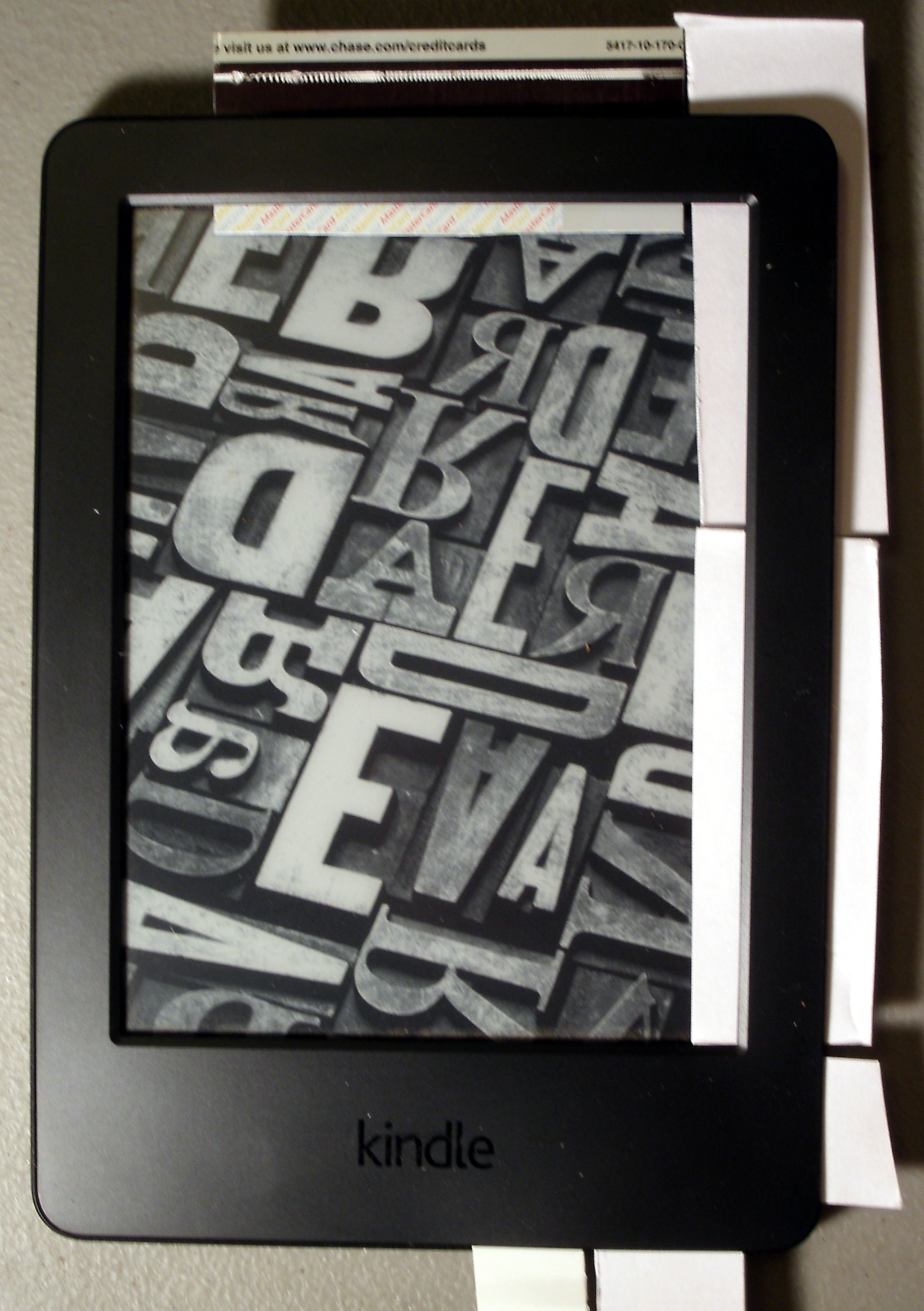

peel-1

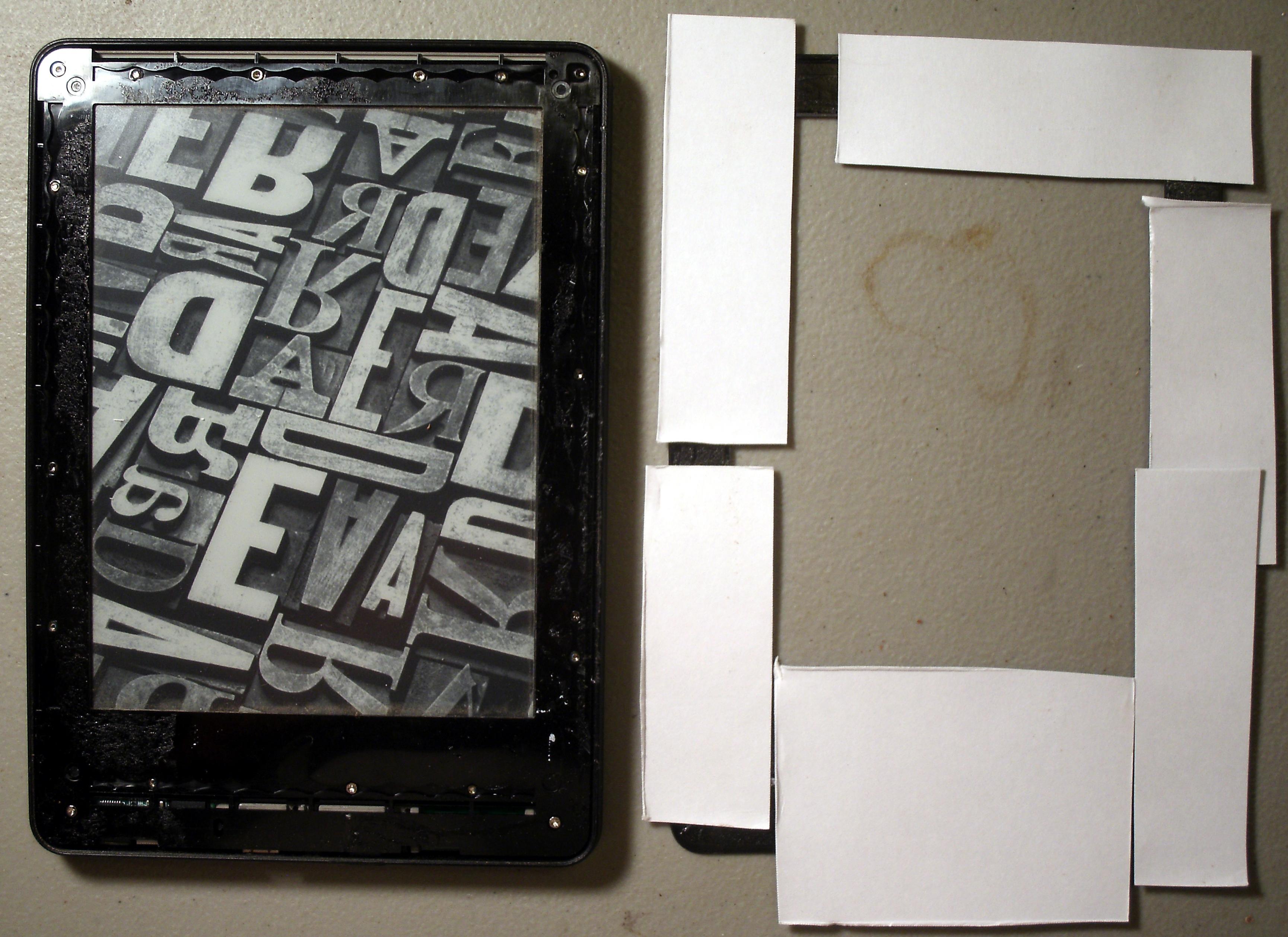

Starting at an upper corner -
Using a thin, plastic tool (or credit card) -
Work down one side, work across the top, work down the other side.
Leave a trail of <something> (shown, glossy faced cardboard) behind so that the bezel glue doesn't grab the body again.
peel-2
Leaving the bottom for the last peel&pry effort, (gently) rip that little sucker off the face of the body.

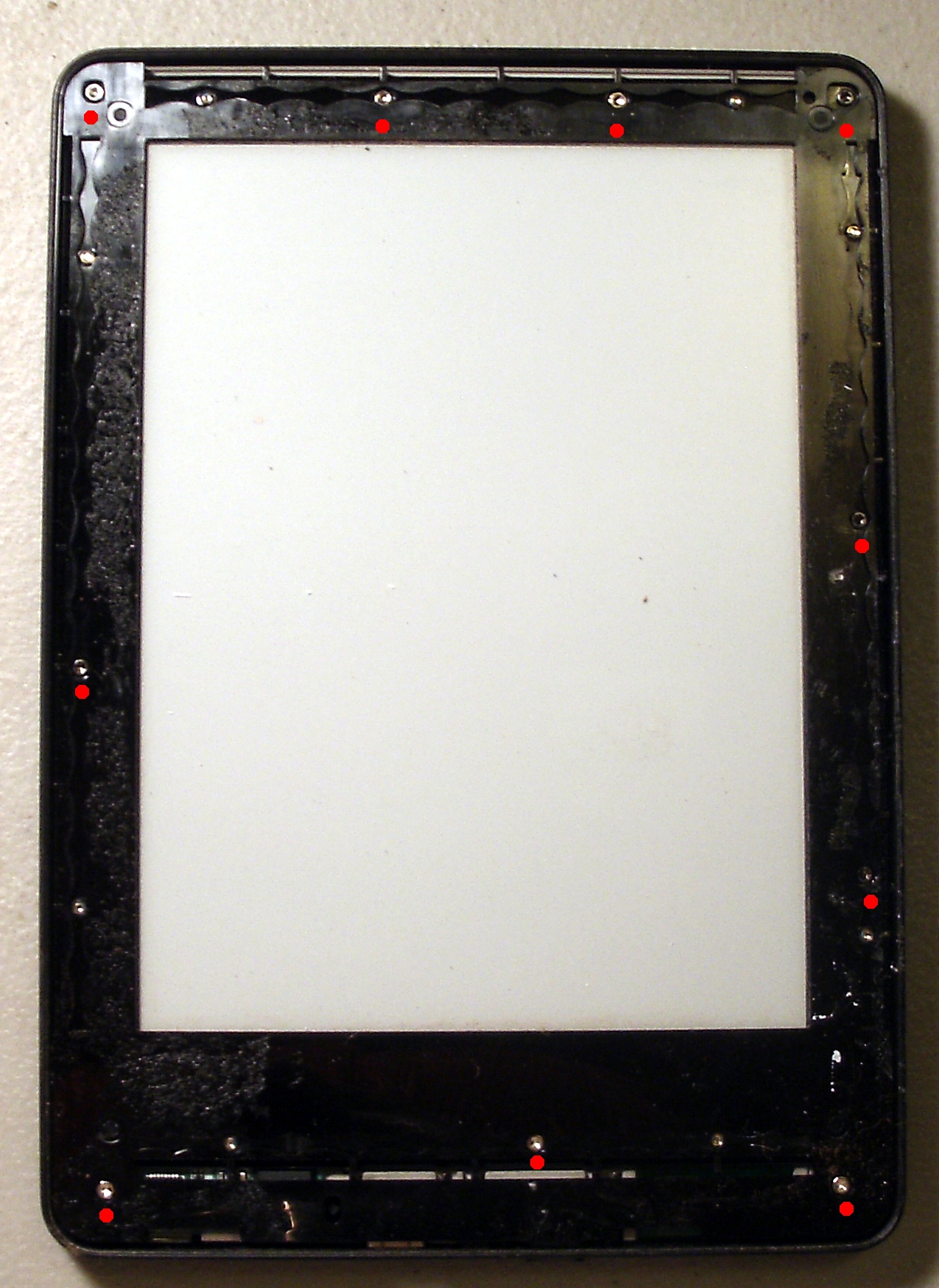

unscrew
The Kindle hardware assembly is held in the bottom (or back) case pan by 10, T-5 (torx) socket head screws.
The red dots are just below the ones you want to remove.

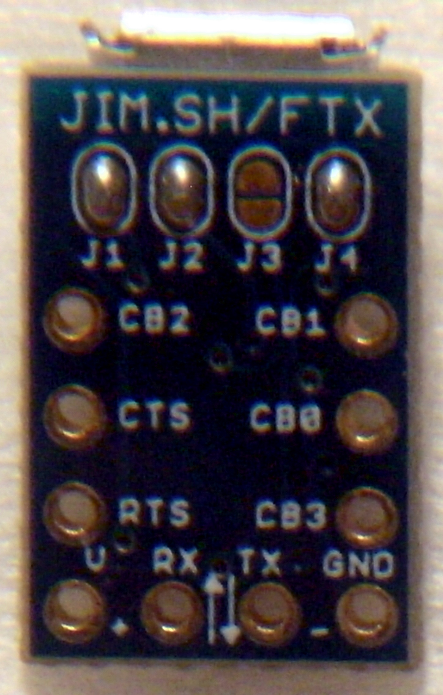

FTX Jumpers
Since the Kindle uses 1v8 for its serial port, and other controls, the jumpers have to be changed to configuration #3.

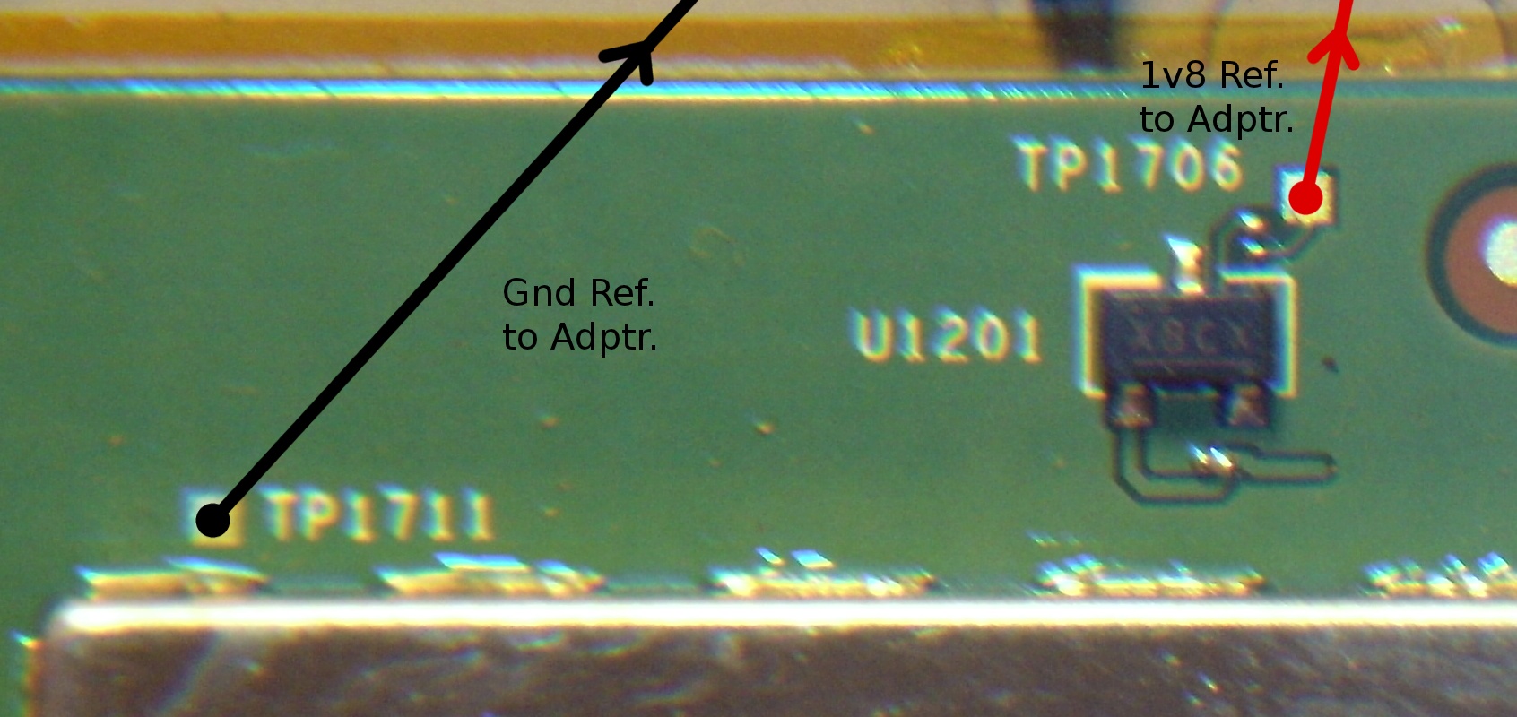

FTX I/O References
A usable (very quiet) ground and a 1v8 reference for the FTX can be found at the top right of the KT2 board.
(Attach-3: adptr-io-ref)

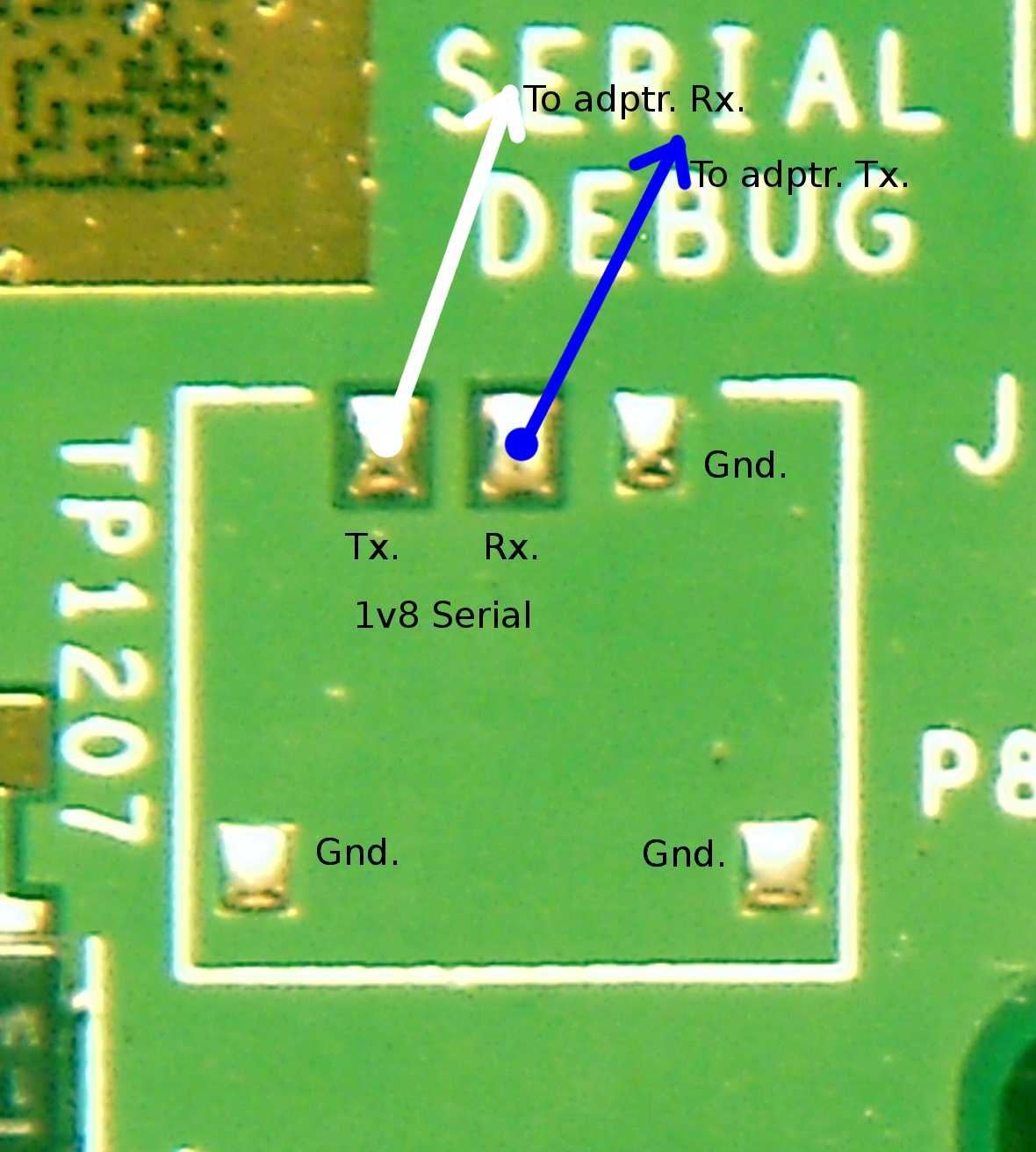

Serial Port
The "Serial Debug" pad site is wired to the FTX (only Rx and Tx) in the usual manner.
(Attach-4: serial-port)

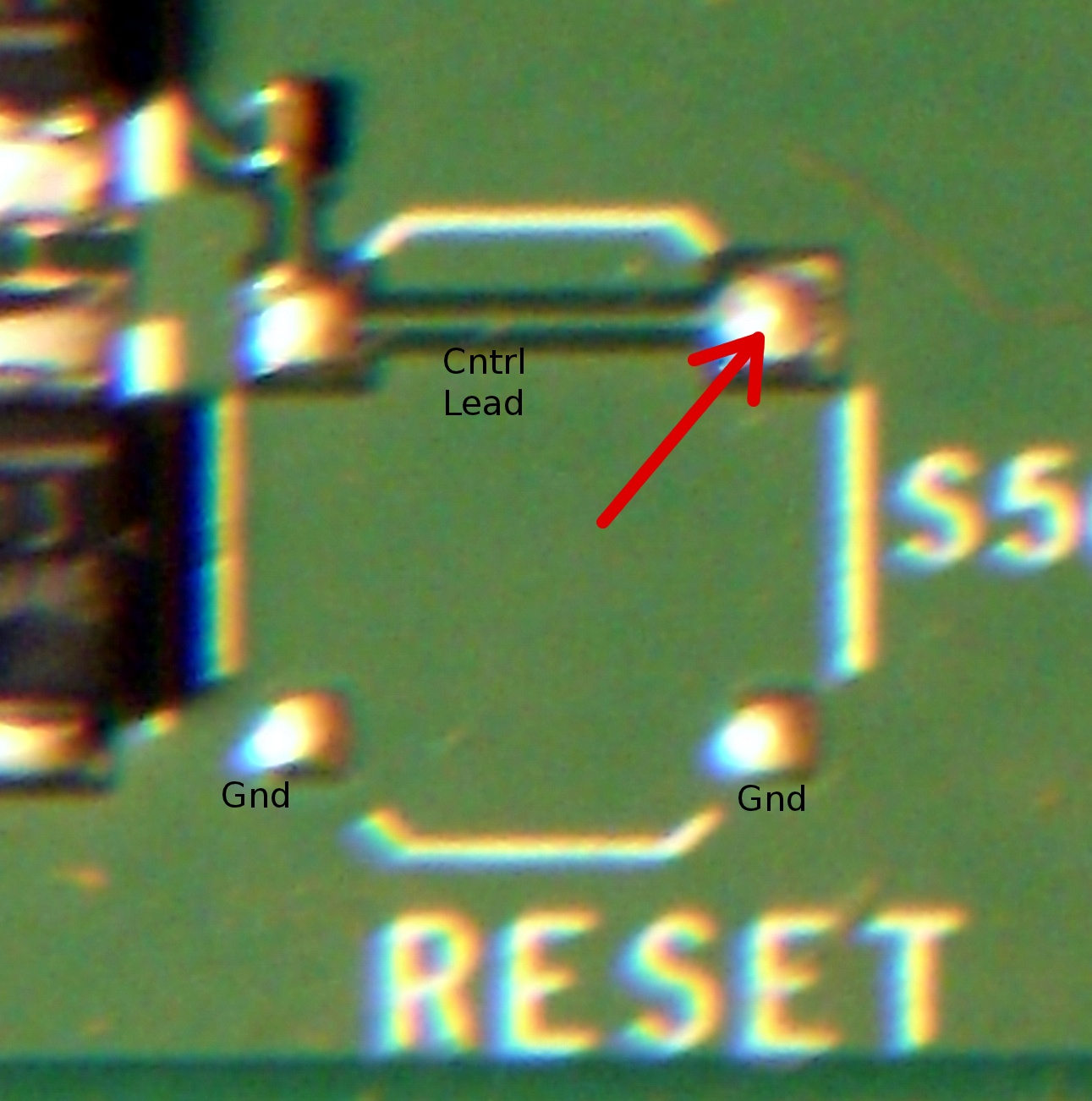

Hardware Reset (reboot)
This control lead is pulled up to 1v8 and protected from noise by the adjacent resistor, capacitor, and diode combination.
Either pad on the cntrl lead could be used, but to spare some possible grief the pad furthest from existing parts will be used.
(Attach-5: reset-cntrl)

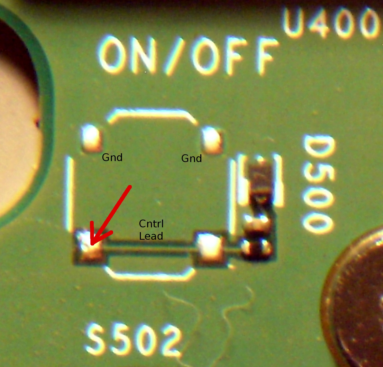

Power on/off
(Attach-6: power-cntrl)

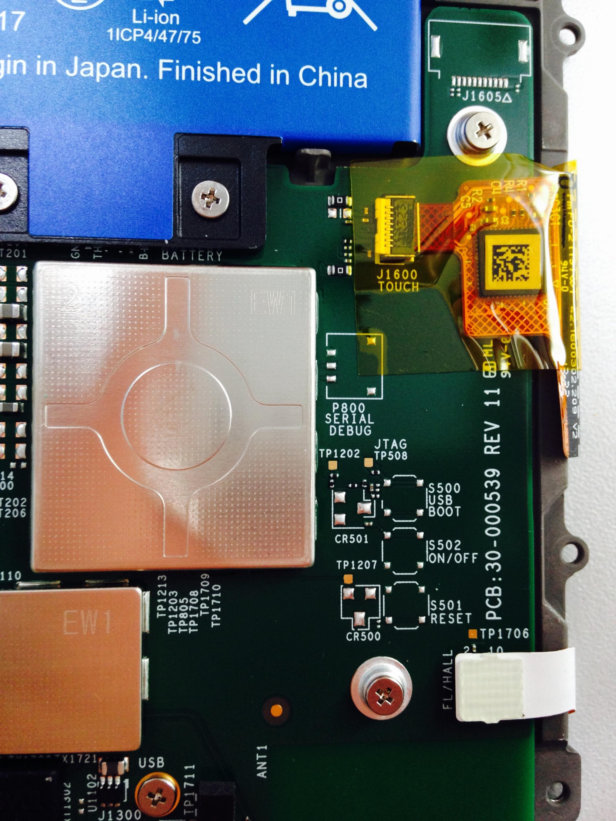

PW2 - Controls
I took leedjc's PW2 picture from: https://www.mobileread.com/forums/sho...96&postcount=9
(Attach-1)
And GIMP'd it almost to death to supplement this thread for the PW2 owners.
(Attach-2)
Not shown is a good place to pick-up the 1v8 interface reference lead.
Someone with an open'd PW2 please assist in finding a good reference point to use.
Edit:
One 1v8 location shown in this post:
https://www.mobileread.com/forums/sho...25&postcount=3
(Attach-1)
(Attach-2)
After GIMP'ing that PW2 pic some more (see attachment), I am not sure if the control leads have been de-populated or not.
Someone with an open PW2 please check S501 and S502 pad sites for me.
Hint: helps if you have a mirror so you can watch both the display and what you are doing on the back-side.
Tests:
Use a short, stiff, length of light gage, insulated wire - stripped bare at both ends. Something like 20 .. 24 gage solid wire will do fine.
Hold by remaining insulation (I.E: protect Kindle wiring from human body static).
Momentarily connect one of the called out, proposed, connection points to gnd.
S501: Expect an immediate, hardware triggered, full re-boot.
S502: Expect the Kindle to "turn off" (with cleared screen) or to "turn on" (I.E: resume).
If the missing CR500 and CR501 are required, nothing will happen (nor will any harm be done).
If they **are not** required - then the controls should work as expected (and no harm will be done).
Note: the above tests have been performed on the KT2 and they work exactly as labeled.
Note: You might want to forego the coffee for a few hours prior to the above testing - -
The test points are a tad bit smaller in real-life than shown in the picture attached.
Steady hands are required.

For use in the KT2 - the MicroFTX board really needs to be built in a low profile version.
I.E: Currently has a surface mount micro-usb connector, needs to have a micro-usb connector that mounts with its centerline on the board centerline (like at least some kindles have).
For now, I will just fake it by physically hacking up a high profile version into a low profile version.
Lucky for us, Jim Paris has OpenSourced all of his design files:
http://jim.sh/ftx/#design-files
The PCB board layout requires (at least) Eagle V.6:
http://www.cadsoftusa.com/download-eagle/?language=en
But I think that the "Freeware" version should also work:
http://www.cadsoftusa.com/download-e...e/?language=en

The board breaks out 4 of the 'cb' pins -
This far I have only committed to using 2 of them (reset and on/off) -
They can be programmed as inputs (also) -
I will set the other two as inputs, and use them to monitor the levels on the two "USB boot" leads beginning with a hardware reset.
Expected:
That they will be the "boot mode" leads during reset -
The "boot mode" leads will be scanned by the hardware during reset -
After reset, they may (or may not) be re-programmed as other signals (the PW2 silk screen seems to indicate that one of them becomes one of the JTAG leads).
The boot mode leads are not multiplexed, but then these may not be the actual boot mode leads from the SoC.
But I suspect the hardware around them is setup so that the same type of single pole, momentary contact, switch was used to just hold the two leads connected during the reset scan, and to do no harm if held (or pushed) after the reset scan completes.
(They used (or are using) the same board for development as for production. We will learn if lab126 has shot themselves in the foot (again) with that decision. )

The MicroFTX "cb" outputs are open-drain with a 75k ohm pull-up.
So far, the chip's I/O cells are referenced to 1v8 (since that matches the serial port I/O levels).
But the boot-mode lines need to be connected together (I am assuming here) to emulate a mechanical switch.
Plus, they are running on the 3v3 supply rail(s).
Hence, the added-in, switch chip.
And since they come in four per package ...
There are enough for all four "CB" outputs, if required by another project.

And if someone wants to post some better board pictures than those we already have here of the KV (which I don't have) ....
That would probably help.
