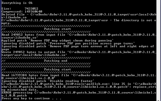

What happens if you do get an error in Step 5 and no KoboRoot.tgz is created in the target directory? Everything before this point is processing, extracting, everything is ok messages for the files, until it stops at this point. I've definitely got the right firmware version installed, I double checked that first thing.
Edit: If I run the patch without making any changes at all, it completes fine, so let me see what I don't like with the default setup before worring about this. I was careful to keep spacing the same in the one area I did change, other than changing "no" to "yes" in a few places.
Edit 2: Actually it wasn't that I didn't make any changes, I had also redownloaded the patch file in case something went wrong with the download. It's all working as it should since I downloaded the patch file again.
There is an error in your patch file libnickel.so.1.0.0.patch, line 35 in the original file is:
replace_string = DBDC3D, `footerMargin: 105;`, `footerMargin: 105;`
(This could also be caused by a change in the replace replace_string on line 17, post your whole patch here if you can't find the problem.)

I had redownloaded the file and it's working fine now. Must have been something wrong with the initial download or unzipping it.
With your patch now, this firmware almost makes me want to switch from 2.4.0 which I use on my main reader. The same fonts in the same books are even darker and thicker now than in the older firmware. If it wasn't for that hideous homescreen I would switch.
