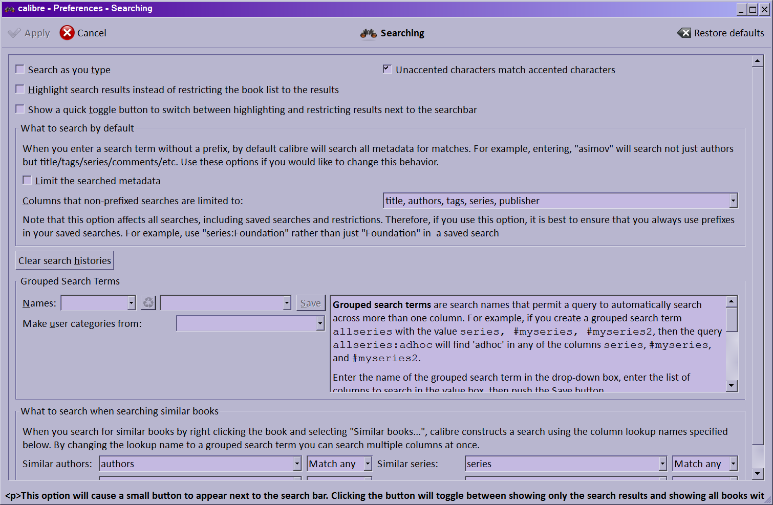

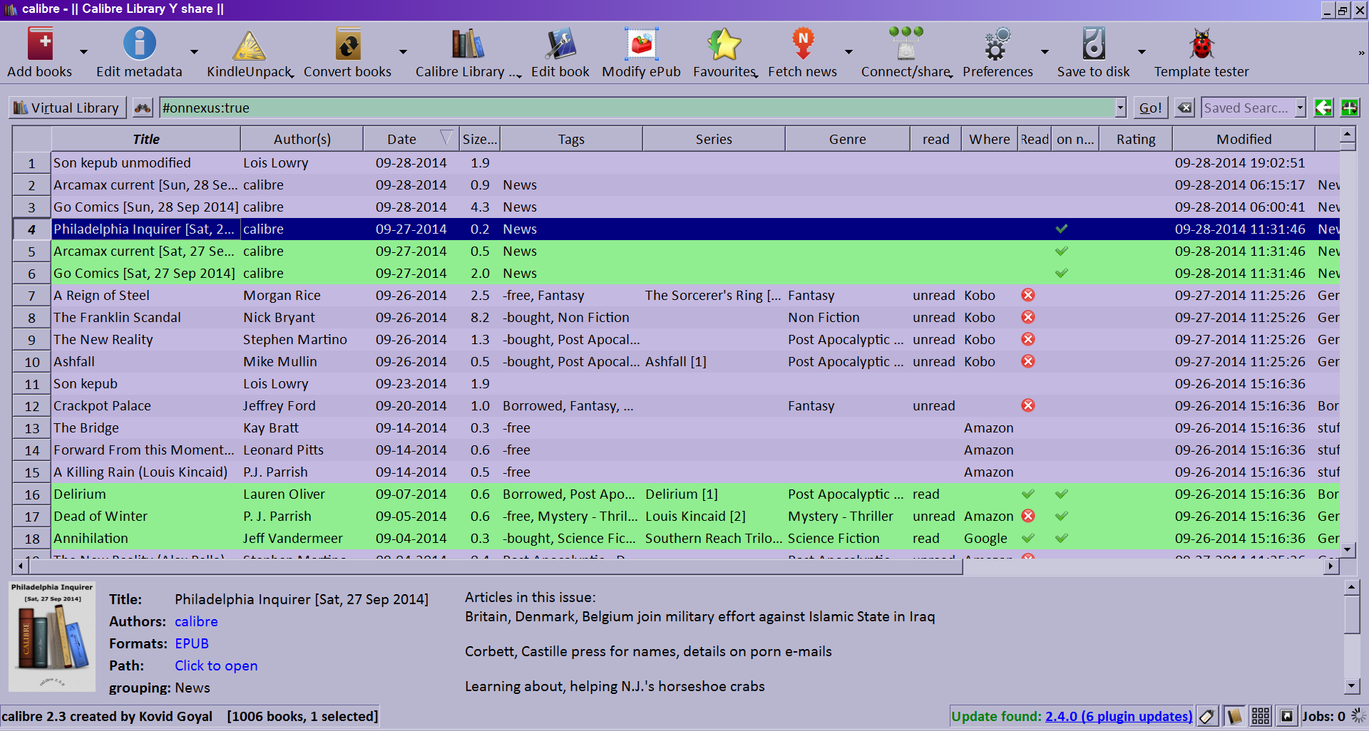

My search results are now highlighted even though I have highlight search results unchecked in Preferences. I am on Calibre 2.3 using Win 7. This happened the last time I did a search a few days ago and I checked and unchecked highlight search results in Preferences and it was fine and subsequent searches were ok too. Now it's back.

@Purple Lady - Have a look at "highlight_search_matches" in gui.py in your config folder, your preferences indicates it should be False, your book list indicates it's True.
It's false, but just before I posted, I turned it on and off again. I just restarted Calibre and the search is still working as it should.

Posts: 45,675
Karma: 28549304
The Find Duplicates plugin toggles that setting, you probably used it causing the setting to be changed.

Posts: 22,050
Karma: 30277960
I use the FD PI at least 3 times most every day and I never get this problem and I've been wondering why that is so for months. I think I've discovered why it so.
When I'm done with Find Duplicates I always select Find Duplicates->Clear Duplicate Results, and when I do that the highlight_search_matches setting gets restored to what it was. If I don't, it stays at the value I happened to use (if different) whilst resolving what to do about the duplicates.
I get quite a few 'false duplicates' so it makes sense for me to do the Clear Duplicate Results as the last step. I can't see any obvious place to automate this. The only suggestion I can make is to automatically restore the setting if all duplicates are resolved by deleting or merging.
