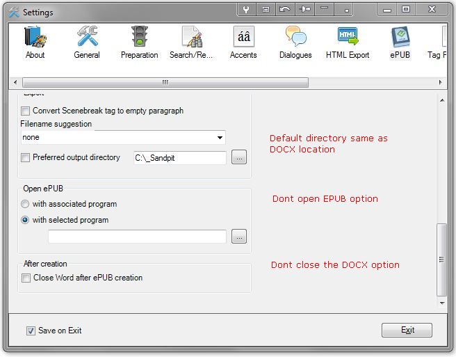

Small caps is not a big issue, I'm happy with the calibre DOCX conversion and I want the DOCX and the EPUB to be stored in the calibre library. So don't spend any undue time on it.
See attached image for some suggestions on EPUB Settings.
What are the suggestions??? I don't see it, but that is probably me. I do see that not all the settings are entered consistently. For example, you have set to open the ePUB with the selected program, but no program is selected...

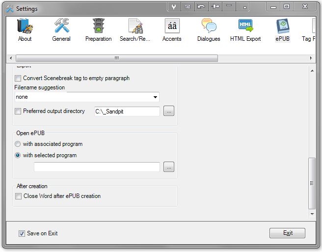

I forgot to save the edited screen shot here 'tis
