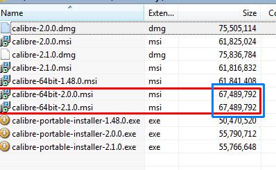

See what you make of this ==>> ssl - Why aren't application downloads routinely done over HTTPS?
See attachment for file sizes - only msi 64-bit was same size

As Kovid said, having identical file sizes close together is 'rare', the number of 'too clever by half' ISPs is small. There are workarounds - wait a week, use a proxy, use portable or the other bittedness for a week, be nice to someone and they might offer to PM you a link to their file locker
