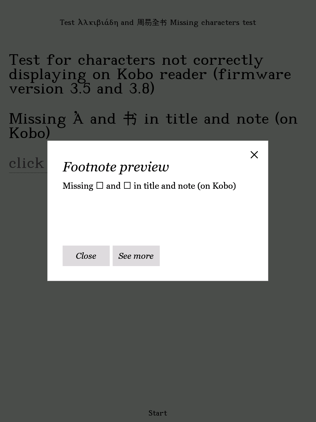

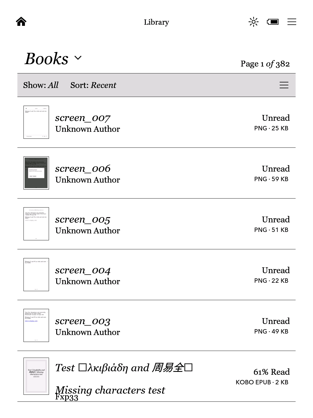

Hi,
I confirm that going to firmware 3.8 didn't change the titles display.
Here are two missing subsets:
Attached a test file...
Regards

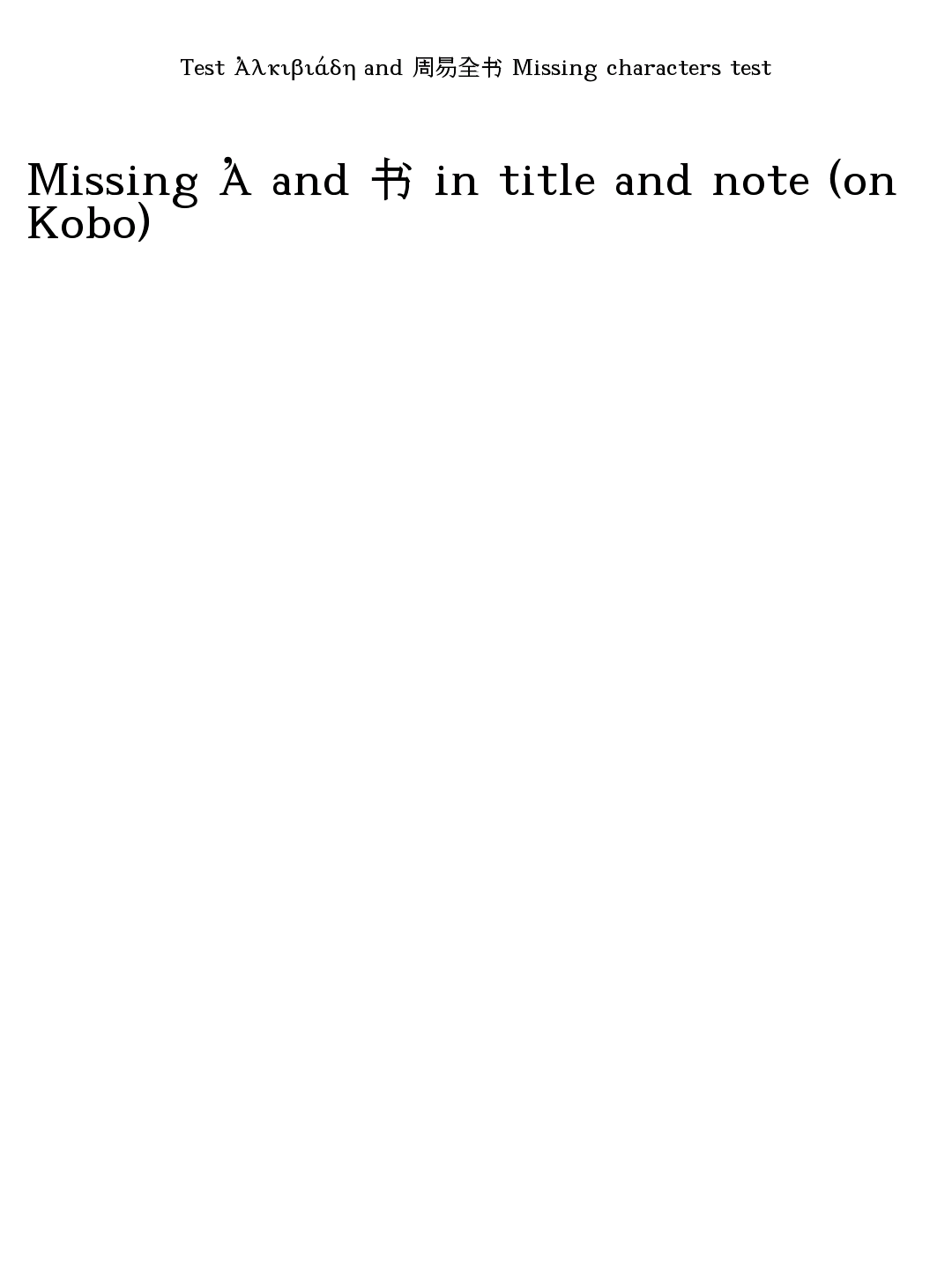

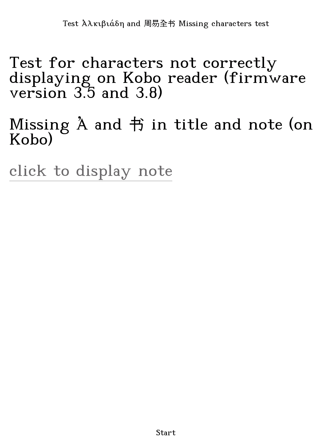

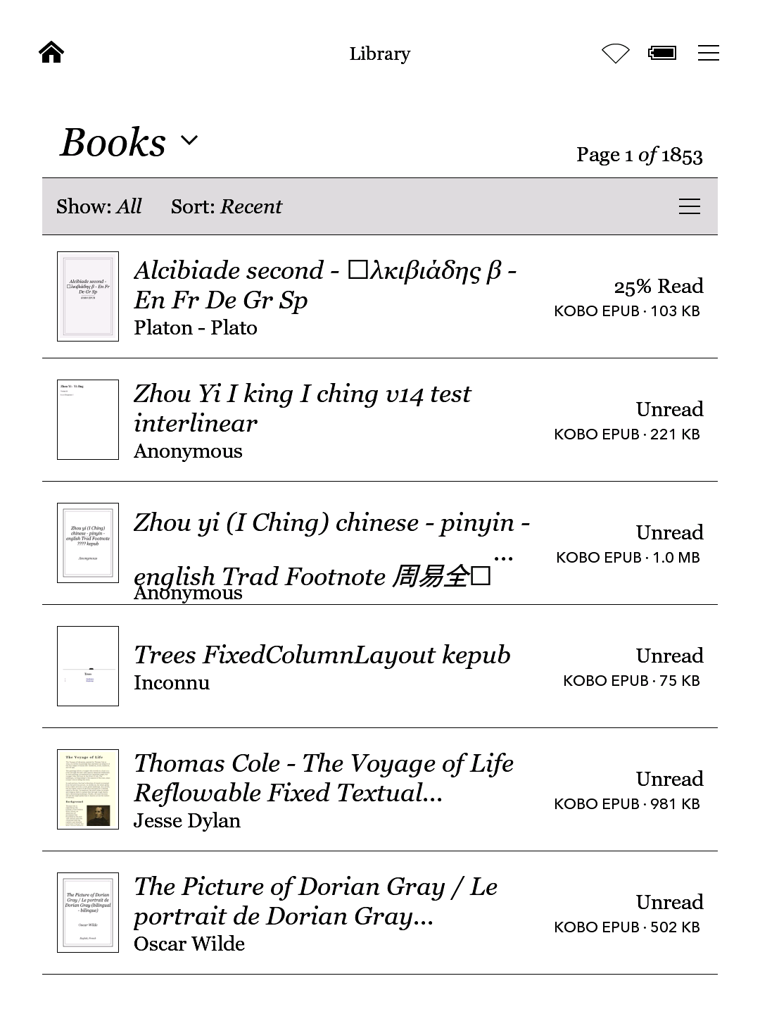

Posts: 54,507
Karma: 182218685
Originally Posted by fxp33 View Post
Hi,
I ended up editing your sample since it appeared to have "test" instead of "text" in the link to the footnote.
Switching to Code2000 as the font gave me the following results:
epub: Page 1 and 2 displayed correctly
.kepub.epub Page 1 and 2/footnote displayed correctly, popup preview did not. Title displayed correctly.
library view: characters missing
See attached screenshots.
It seems that Kobo is using a default font for the library and popups. It might be possible to modify that font choice similar to the work done by GeoffR on the header/footer default test settings or tshering's font size increase patches. I tried using tshering's version for 3.8.0 for the library title and author and changing the Avenir/Georgia fonts to code2k (had to rename the font internally to keep the length down). No joy in trying that -- perhaps user added fonts are not supported in that area.
Regards,
David

Hi all,
@DNSB: I spent a the day going forth and back wondering why the popup note didn't work !! Just getting blind. I updated the test file... but my latest version has a bit of chinese (traditional and simplified to check in the footnotes... if I finally was awake correcting the links!)
Thank you very much for your thumbnails... "glad" to see that the problem in the library view is not limited to my device.
But I am almost sure the chinese text displayed right before 3.5... but of course, I might have changed some of my fonts... I remember removing Arial and some open font at some time... If one of them had the same name as the internal (smaller) one, maybe it explains why the error was not seen.
I used fontforge for my ruby pinyin font... I remember changing the name in the properties, but actually there were quite a few names, and I am not sure I did so well (only managed to change the human readable name).
Some most testing with the renaming of fonts, I let you know if I find the correct adjustment.

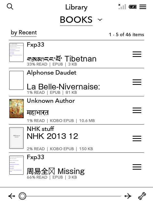

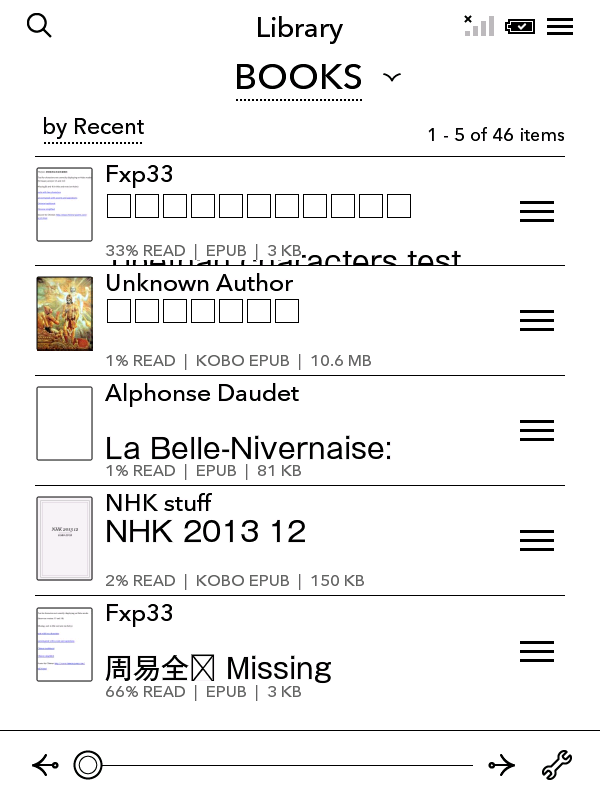

The problem seems to be that the device automatically selects the fonts for the library view. If there are several fonts that provide a certain character range, the device selects one of them. But unfortunately the selected font may not support each and every character of the range. Compare the two screen shots. The first image shows the library view after powering the device on. The characters of the first two titles are outside of the range supported by any of the three system fonts. The fifth title contains characters that are in the range of Gothic MB101 (one of the three system fonts), but one character is not really supported.
The second picture shows the library view, after I have opened the first two books and selected the appropriate fonts. Since they are now available to the system they are used in the library view.
The work around, I guess, consists of two points. 1) Remove all fonts that support the range you are interested in apart from the one you want to use. 2) make this font available to the system by opening a book that uses it. However, this does not seem very convenient.
ID:	127879   Click image for larger version

@tshering... wouahh this is incredible I didn't understand your "opening a book" statement in your first post... but it surely has an effect !
Can't wait to try that...
Thanks again for taking time of describing and for sending the screenshot.

Hi
@tshering:
Sorry, did everything I could, without making it work...
I took all the fonts away from the "user" font folder. Reboot.
Put only the font for simplified chinese (code2K first, then redone the same process with another asian ttf)
Opened a book.
Changed to the user font.
Tried to view the notes.
Library view = No, still with squares
Reboot
I guess the internal font "thinks" it works with the square (as opposed to the fonts displaying double crossed square). Therefore it refuses to be superceeded by a user font in the library view, and in the popupnotes...
Regards
