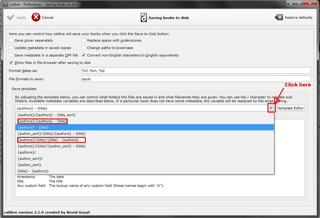

@natia67 - See screen shot - maybe one of the other sample templates will suit.
If not then if you tell us precisely what you want we might be able to furnish you with the template.
But, if you can create the template yourself, by building on the 'samples' provided, together with the list of variables you see there, then you will learn the basics of 'templates', which are widely used elsewhere in calibre.

In the screen grab of BetterRed's message prior to this one, notice that he also has Update metadata in saved copies unchecked. You also want this or Calibre will modify your eBooks every time you save to disk. You really don't want that.
