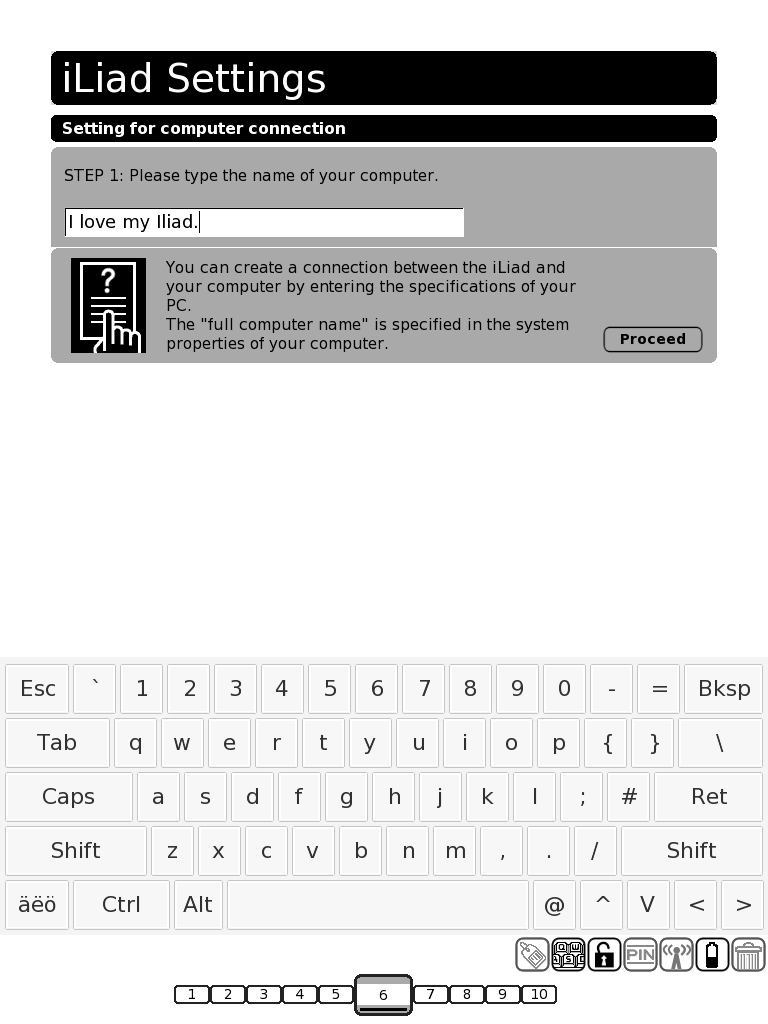

matchbox-keyboard works
Originally Posted by Adam B. View Post
Agreed, the keyboard is easy enough, although we will likely loose the handwriting recognition (which I've never really used all that often).
http://matchbox-project.org/sources/...ard-0.1.tar.gz compiles without problems. It even has a CTRL and ESC keys. Keys can be configured with xml-files.
It runs on the Iliad and can be used to enter text. Only (minor) issue is display refresh. Can be added, we can use the tricked libX11, or -even better- just wait for Antartica's xepdmgr (hint hint)
a.
I can feel the karma ;-)
Edit: homepage is http://matchbox-project.org/?p=1

Fan-fricken-tastic. Not only is that a perfect solution, it's a fast perfect solution. Really well done!
I'd toss you more karma, but I just gave you some and I'm not allowed to.
When we substitute displayMgr with xepdmgr this would not be a problem. But in the meantime, while we use displayMgr for the iliad OS and only xepdmgr on a app-by-app basis, how should we handle this?
Options:
1. Don't use this keyboard until we change displayMgr with xepdmgr
2. make xepdmgr to ignore the keyboard when launches a program, or to monitor only a command-line specified window (by class for example) -- this last option used for the keyboard
3. Introduce some code in xepdmgr so that if various instances are detected, one of the becomes master and the other waits for the master to die to regain the ability to update the screen.
A while ago I was thinking in the third approach but right now I'm not sure if it is worth the effort: (1) is the easiest X-).

4: Add some code to the matchbox-keyboard to optionally send refresh requests to displayMgr.
That would be almost as easy as (1)
My problem is that I don't know an elegant solution to the following scenario:
1. Viewer using xepdmgr as a launcher with the yet-to-be-implemented window exclude to avoid double refreshes to the keyboard
2. keyboard using xepdmgr also as a launcher
There would be clashes.
