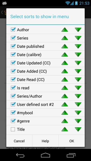

I ended up doing it on a sort-by-sort basis.
Also, I have added changing the order in the grouping drawer and the sort menu.

Old 08-13-2014, 05:03 PM   #40
kaufman
Calibre Companion Fanatic
kaufman ought to be getting tired of karma fortunes by now.kaufman ought to be getting tired of karma fortunes by now.kaufman ought to be getting tired of karma fortunes by now.kaufman ought to be getting tired of karma fortunes by now.kaufman ought to be getting tired of karma fortunes by now.kaufman ought to be getting tired of karma fortunes by now.kaufman ought to be getting tired of karma fortunes by now.kaufman ought to be getting tired of karma fortunes by now.kaufman ought to be getting tired of karma fortunes by now.kaufman ought to be getting tired of karma fortunes by now.kaufman ought to be getting tired of karma fortunes by now.
kaufman's Avatar
Posts: 873
Karma: 1088610
Device: Galaxy Note 4, Kindle Voyage
Thanks, that look great. If this going to be in an upcoming 3.4.3, or are you just starting with the changes for 3.5?
It won't be in 3.4.3. That is going to be a bug fix release, probably made available in early Sept.
Whether the new functions I am doing now will be 3.4.X or 3.5 I don't know. I can make an argument either way.
You should know that you have zero credibility with me when you say you aren't willing to do something, because typically after you say that, your next post is about how you did it already.
I actually worry about that.
This time it turned out to be the same amount of work to do an option per sort as a single option. I didn't see much point of doing the single option simply to be consistent.
