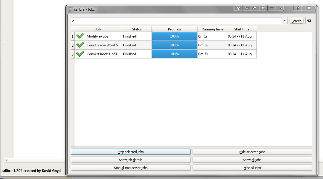

Old 08-10-2014, 06:20 PM   #55
Posts: 22,609
Karma: 32600660
I was doing a Android by USB test for reference on W7X64
https://www.mobileread.com/forums/sho...44&postcount=6
I pulled up the Task manager and it was OMG (scroll bar) wide and I could not resize the columnmany of the colum that I could see, were not populated.
Jobs display in 1.205 portable works fine here - but I did NOT have a device connected.
Old 08-10-2014, 06:58 PM   #56
Posts: 31,696
Karma: 64144480
This may be a QT screen geometry quirk (BUG).
I have a second monitor (768x1024) above the WS (1600x900) display on the Laptop
Old 08-10-2014, 07:11 PM   #57
Posts: 31,696
Karma: 64144480
There is something wierd going on.
I disconnected the second monitor. REBOOTED
Started Calibre
Attached my TAB2
Opened the Task Manager
Column heads: Job Status Progress Running_Time JOB
Only Job has info and I can't resize column widths
NB Same cols on 32 bit XP, same lack of resize
BUG
Old 08-10-2014, 07:25 PM   #58
Posts: 22,609
Karma: 32600660
Started Calibre
Attached my TAB2
BUG
@theducks - Try with no device connected - that's my scenario. I just did a folder connect, it was still OK.
