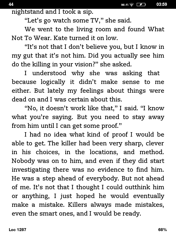

root@kindle bin]# ./wmctrl -r -i `./wmctrl -l | awk '/titleBar/ {print $1 } '` -b toggle above
I think that covers it. EDIT hmm bit hasty need to persist it somehow...

ok so...
export i=`xwininfo -tree -root | awk '/titleBar/{print $1}'` \
&& ./xdotool windowreparent $i `xwininfo -tree -root | awk '!/footerBar/ && /booklet.reader/{print $1}'`
and
export i=`xwininfo -tree -root | awk '/titleBar/{print $1}'` && ./xdotool windowreparent $i 0x51
to go back to normal.
and they are one-off stateful calls. no log tailing.
maybe we could detect book exit.... hmm...
I'll bundle the tools in a bit. They are all in The Touch management bundle but I'll repack them for this I guess

Something like:
PHP Code:
showlog -awk '!/home/ && /booklet.reader/' |  awk '/SENT/{print $0}' | \
while
read MYVAR; do  echo "$MYVAR| \
awk '/PAUSE/{system("./showtime-restore.sh")}' \
&& echo
"$MYVAR| \
awk '/GO/{system("./showtime-header.sh")}'done
with:showtime-header.sh
PHP Code:
#!/bin/bash
LD_LIBRARY_PATH="../lib:$LD_LIBRARY_PATH"
xdotool windowreparent $i `xwininfo -tree -root | awk '!/footerBar/ && /booklet.reader/{print $1} |head -n1'
and:showtime-restore.sh
PHP Code:
export i=`xwininfo -tree -root | \
dynamically sticks the top status bar over the book while reading.
Possible to resize it a tiny bit smaller / move it around/ via xdotool.

@twobob: Duh! Of course that titlebar still does its job in the background. Nice! >_<".
Does it refreshes properly?

I literally just got that finished and crashed out. zero testing was done. and that was just on the touch / PW obviously.
Tried an alpha channel gtk app for the 3 but for some reason I cant even get the alpha channel stuff working on my main pc never mind the 3. that would be a neat solution though - a transparent notifications layer, that doesnt grab focus. would be nice to programmatically inject full widgets on the fly to an overlay.
perhaps this LUA solution I should just just hang around for...
