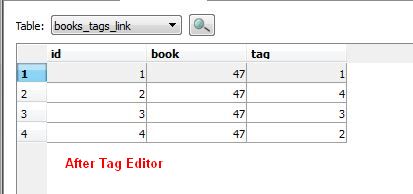

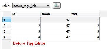

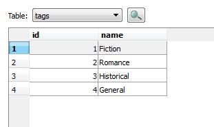

@davidfor - Yes good point, even if the tags are left untouched (no additions or removals) and one clicks OK then the book/tag data is resequenced, see attachments.
Added : I think that disproves you last hypothesis, added a screen shot of the Tag table.

Name:	Tag Table.JPG

I suspect they will change again when you run Library Maintenance.
The First pass compresses the db (reloads tables from dumps?)
Yes, you're probably right, you'd have to devise a scheme for maintaining the order in the metadata.opf file, I guess one could rely on relative position, but one would probably prefer not to do that.

@davidfor: Order information for all many-many columns is stored in the link table, the order in which the entries for a particular book appear in that table is significant.
Oops. I didn't look at the actual structure, just viewed the data. The viewer I was using can display a rowid as the first column. I read the "id" column as that number.
That order was what I was referring to. But, as I hadn't noticed that the primary key was the id, I assumed it was just the row creation order. The id does give a sequence for the tags in the book. I can see similar things happening with all the link tables.
For the tags, there is some inconsistency in the display. In the metadata edit screen, they in the id order. Everywhere else they are in alphabetical order. The OP, and I agree, feels that tag order is important. Having them displayed in this order would be good.
