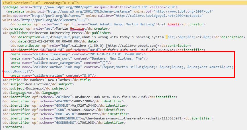

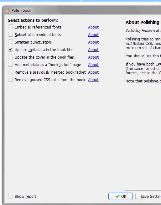

@Bobioden - When you do the Polish it updates all the metadata in the EPUB including rating.

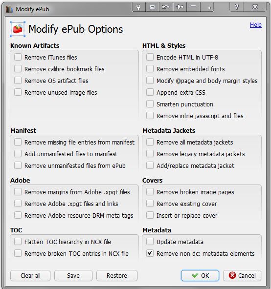

Rating is not one of the Dublin Core metadata elements. The Modify Plug-in can remove non dc elements [GUI Plugin] Modify ePub Plug In
Most of the things available in Polish are also available in Modify

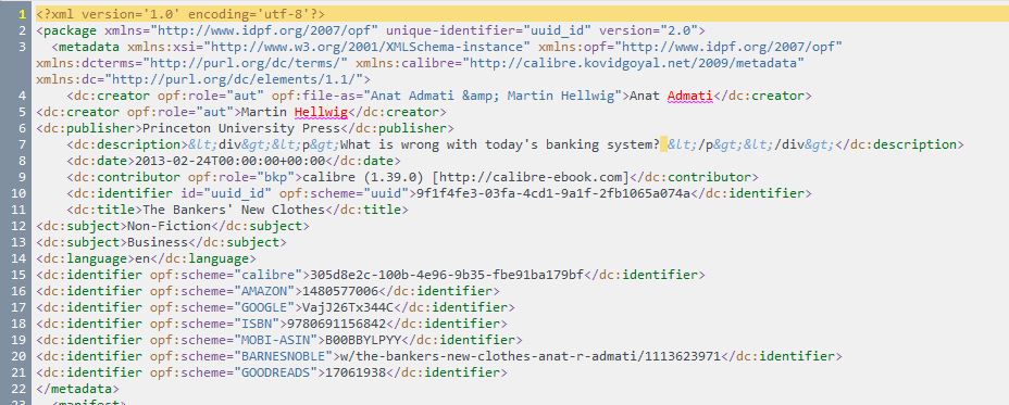

The following attachments show
  • the metadata for a Book via the Edit Metadata screen
  • the settings I used in Polish Book
  • the metadata embedded in the book after Polish Book
  • the settings i used in Modify Book
  • the metadata embedded in the book after Modify Book
You may be able to use a plugboard to achieve the same results and use calibres email facility, but I cant tell you how to do that.
What I have outlined is how a number of colleagues and myself have been sharing epubs via regular email on a daily basis for nearly 3 years. We don't use calbre's email facility because we exchange data other than ebooks - spreadsheets, audio/video interviews, lecture notes, photographs of pets and happy birthday wishes etc. We avoid sharing metadata other than the dc:elements because we ran into ereader hiccups when we did, some of my colleagues don't use calibre and those that do want to manage their calibre libraries in their own way.

The setting in Modify epub, when I check, remove non dc: metadata elements seems to have done the trick.
When I need to just send a book with no Star Rating the Polish Book works fine, but if I had added a rating and want it removed before sending, I will do the Modify epub.
