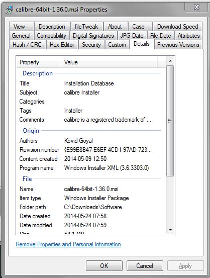

@hidden.platypus - here are Properties->Details and check sums for my copy of calibre-64bit-1.36.0.msi
One thing I just noticed is that the size of the 1.36.msi and 1.37.msi are exactly the same - 60,981,248 bytes.
Is it possible that you use a download gadget that does a size compare before its starts the download (it can get a size before the download, hence the download progress indicators), and it decides that the 'new' one is the same as an 'old' one so it applies a bit of black magic (copy & rename) to the old one to create a new one.
Or did FOSSHUB maybe do that ?
CRC32	be0ee79f
MD5	85293cf6c9b8e44ea70528d9b963ed2d
SHA-1	af4f204753b0543282837db26d945fb9c5a54f46
SHA-224	46abc3c09e63f0f4e66875177caaf93abfbccc0681d140a98a9391d9
SHA-256	b7686073d2ec50df552a4dc9b6e4e03b434beab5967447e5626dc18cb516dd5d
SHA-384	2cbf0f9c20a6a0cc18ff8cc5972c12b8b5a85f04090fdde7a28eafc7840a7b7833a0afed6c0aef095e3d593241856064
SHA-512	f1cd1a6082207af7eeb94d44f4ee03ace8d979a414047eda5359cf741c5692051215a7b2bf77aa82d8b8c211c3940bb8140b8226021033c30ea035c27070f6ec
