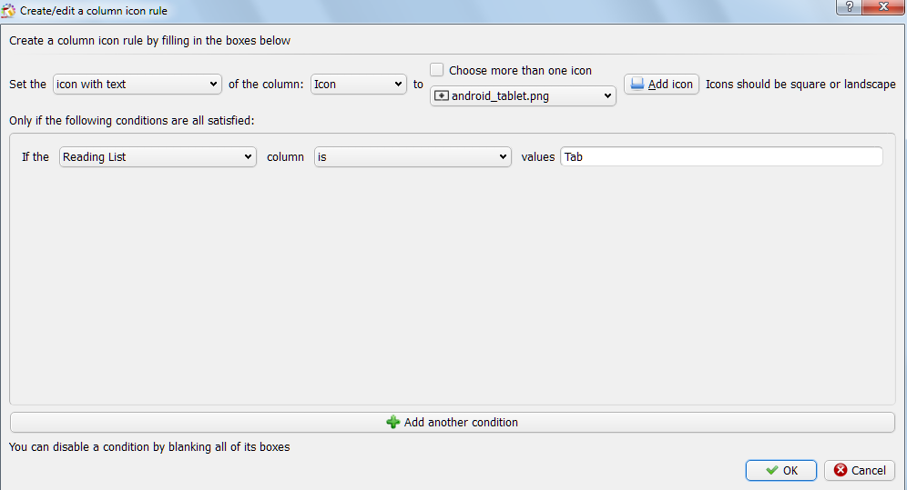

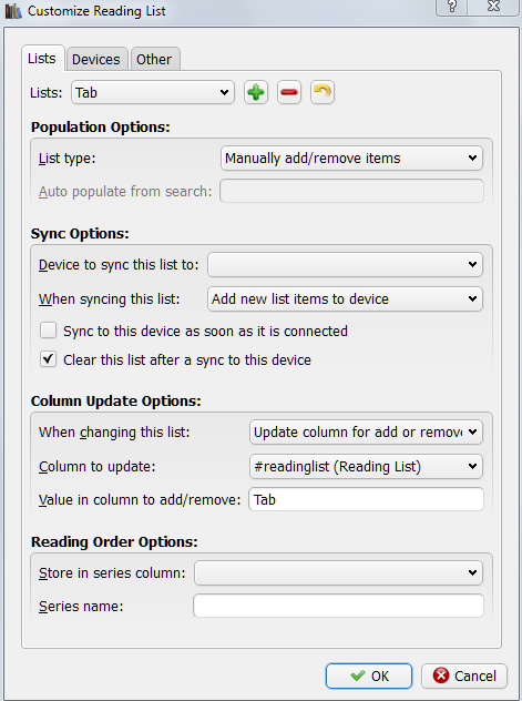

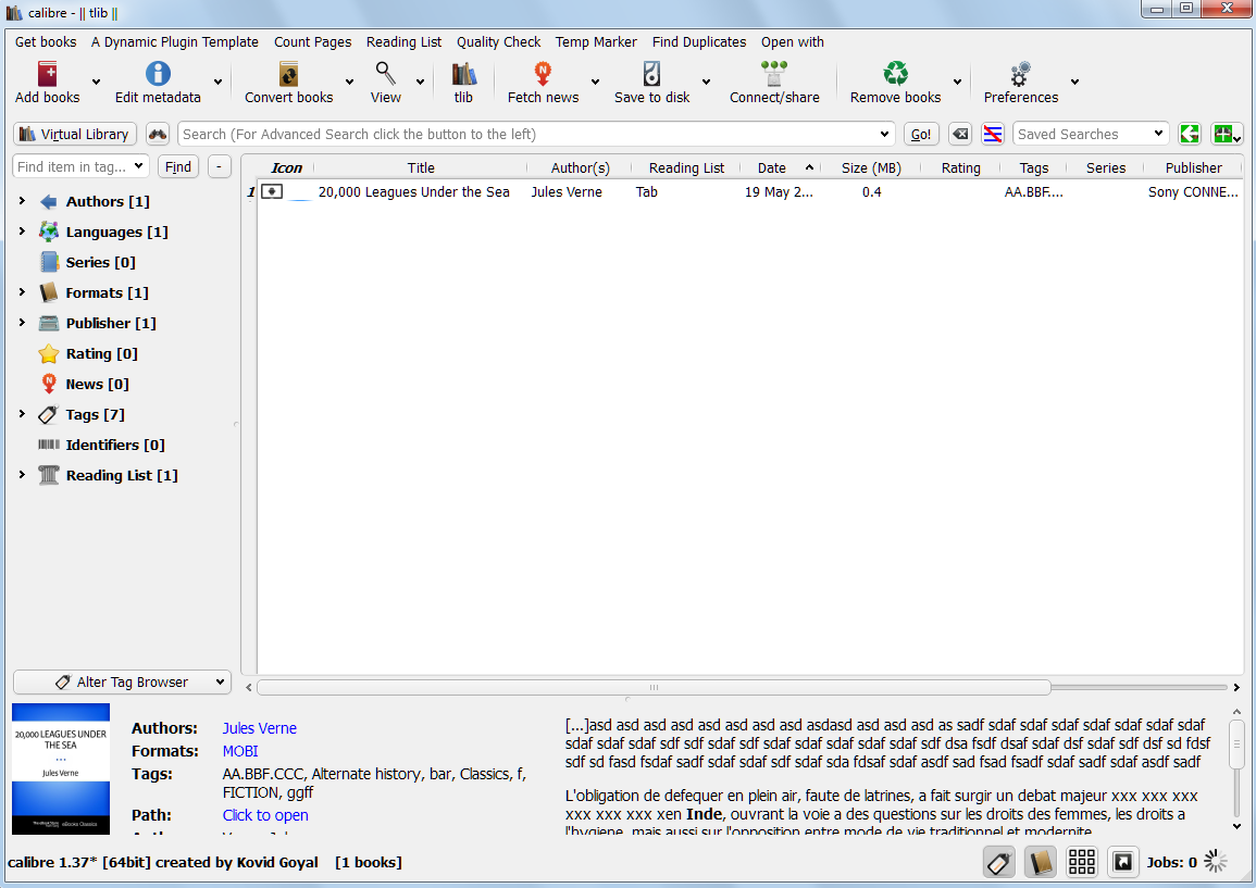

Starting at the beginning:
The first capture shows the definition of a Tab reading list. It writes "Tab" to the custom column #readinglist when a book is put on it. Coloring and icon rules will not work unless Reading List writes something to the custom column.
The second capture shows the icon rule I used, putting your Android image on the Icon columns. I left off the OnDevice because I didn't want to be required to connect.
The third capture shows the resulting library, showing the icon.
The fourth capture shows the library after asking Reading List to show the Tab list.
How is what you are doing different from all of this?

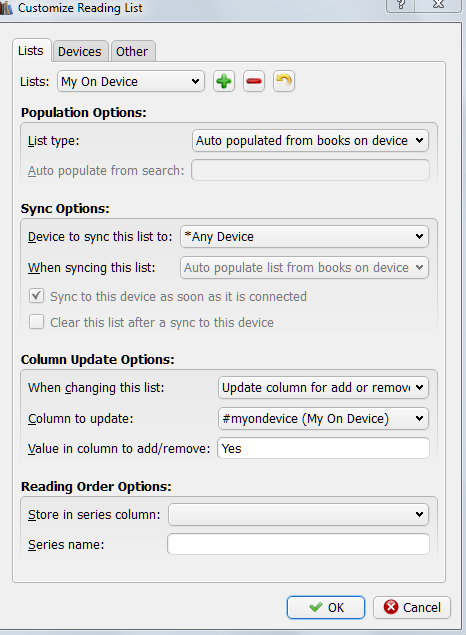

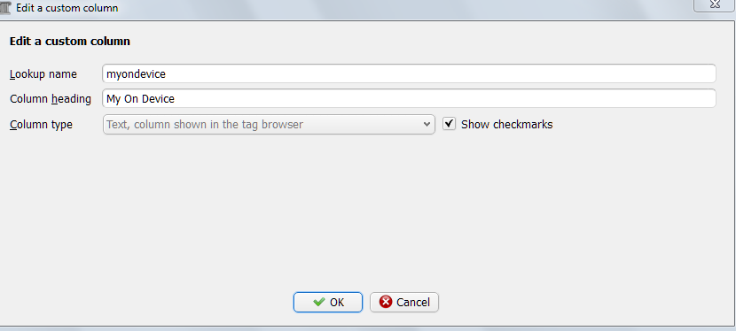

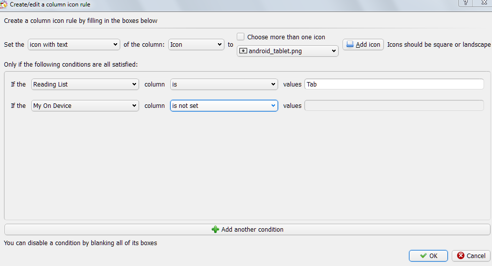

The best way to handle on-device is to make an on-device reading list that is populated whenever you connect the device. The following screen captures show you how to do that.

I can't get it to remove the icon, when I remove the story from the Tab .... I'm beginning to wonder if I can even do this ...

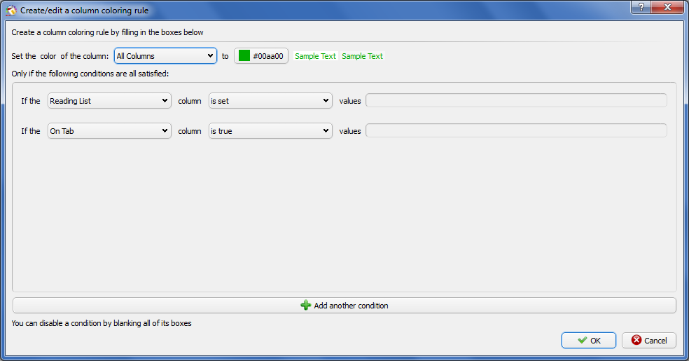

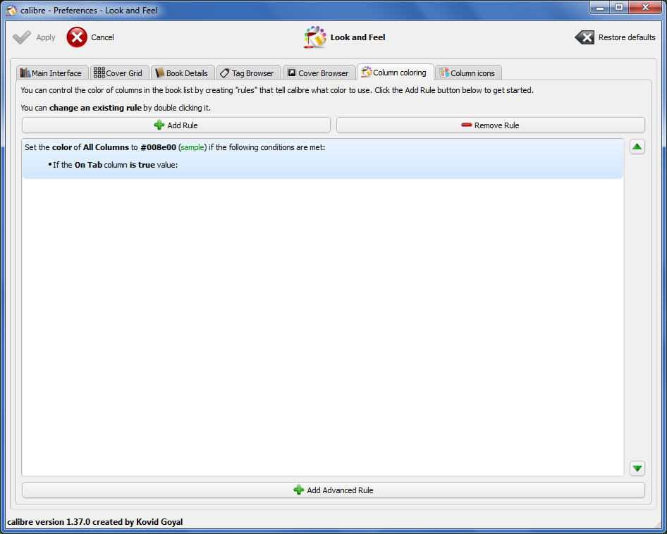

I have now given up on the Tab icon, I've added the icons for favorites and remember, and they work fine ... And I've tried to add a color coding for the "on tab" ... but it doesn't seem to work. I've also tried the second one to "On Device" ... but still not green.

Use the reading list plugin to create your own column that replicates the "on device" column.

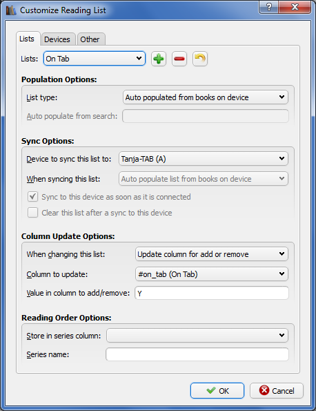

List Name: On Tablet
List Type:  Auto populate from books on device
Device to sync this list to: <your tablet> OR *Any Device
When changing this list: update column for add or remove
Column to update: <your new custom column>
Value in column to add/remove: Y
Custom Column:
Lookup name: <your new custom column
Column heading: On Tablet
Colun type: Yes/No
Old 05-20-2014, 09:29 AM   #56

I tried that yesterday, but it didn't stay green when I unplugged my tablet. I've attached screenshots of my settings.
Name:	Screenshot 2014-05-20 15.28.19.png

It does turn green, when the story is on, but when I remove it again on the tab, it's still green in calibre ... It also still says yes in the column for "on tab".

Remember that the Reading List plugin only updates the Auto populated lists when the device is detected as being connected, so if you drop a book from the device until you either disconnect / reconnect your device OR perform a "Sync Now" operation via the Reading List plugin, the list will not be updated and the colour of the row will not change.
