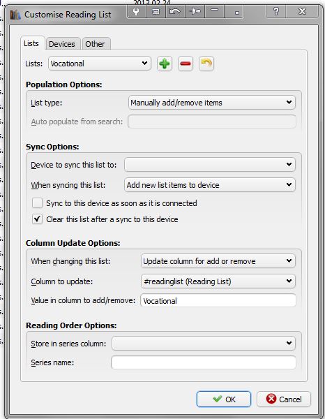

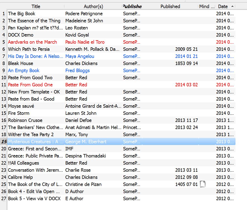

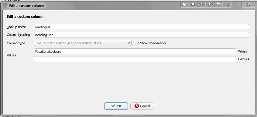

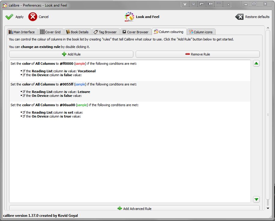

Lets say I have two reading lists, Vocational and Leisure.
First I set up a custom column that I called readinglist/ReadingList - see first attachment
Then I defined some colouring rules based on that column and the On Device column - see second attachment
Then I hook the Reading lists themselves to the Reading List column - see third Attachment - I'm sure you can work the one for Leisure
The fourth attachment shows the results, I added the Red books to the Vocation reading list and the Blue books to the Leisure reading list
I can't show what the On device = True would look like because I don't allow calibre to 'see' my tablet - I only keep a few books on it at any one time, and I prefer to manage it myself.

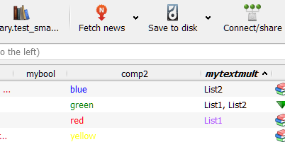

Just for completeness and ignoring that this technique is quite technical, note that you can choose arbitrary combinations by using a custom rule.
In this example I used one tags-like custom column to hold the reading lists. In my debugging environment that column is named #mytextmult. I set up reading list to put "List1" into #mytextmult if the book is on List1 and "List2" into #mytextmult if the book is on List2.
The template for the custom rule checks the four combinations of interest:
  • A book is on both lists. Returns the color "green".
  • A book is on List1 only. Returns the color "red".
  • A book is on List2 only. Returns the color "blue".
  • A book is on neither list. Returns the color "yellow".
In all the cases the rule checks that the book is not on the device.
The sample template is:
program:
	l = field('#mytextmult');
	list1 = 'List1';
	list2 = 'List2';
	first_non_empty(
		test(	and(	not(ondevice()),
				str_in_list(l, ',', list1, '1', ''),
				str_in_list(l, ',', list2, '1', '')),
			'green',
				str_in_list(l, ',', list2, '', '1')),
			'red',
				str_in_list(l, ',', list1, '', '1'),
			'blue',
			'yellow',
EDIT: changed the template to use variables for the values to look for in the list.
The attachment shows the results. In addition to putting the template into a coloring rule, I put the template into a custom composite column to make it easier to see the results.
