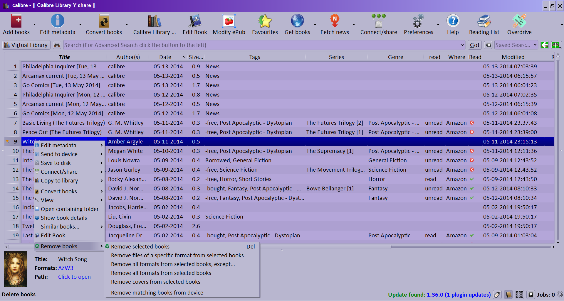

Right click on a marked book (title): Clear All Marked Books
I recently tried the duplicates plugin and have a leftover marker but when I right click it doesn't show any way to clear it. I checked remove as well and it's not there either. I must be doing something stupid.
Attachment 122940
Now I'm even more confused. After posting this I used a saved query and then clicked on Reset Quick Search to bring back all books. The mark is now gone. Huh???
Attachment 122940
Context: You have no marked books (shown or hidden)

You need to add it to the Context Menu (it has the push pin Icon)
So how do I add something to a context menu? I thought that if it was possible to do something, a right mouse click showed what was available.
Also if you look at my screen print you can see the mark next to the book I did the right mouse click on.
(I am blind)
Same way you add to any toolbar:
Preferences Look and Feel: (Toolbar tab):context menu Library view: Select from the left: arrow to the Right column, move up

@Purple Lady - you will only get persistent marks from Find Duplicates if you use its exempt duplicate groups feature see attachment, if you don't use that feature then you wont see them. In this context persist means, even if you remove them via Clear all marked books they'll be back again after a restart. I created a VL (zzzzz) for marked books, it's my starting VL, I clear them via a keyboard shortcut and then get on with whatever...
You can add/move/remove items to the context (aka as right click/button) via Preferences->Toolbars->The context menu for ... There are three of them - library, for device and for grid

Thanks BetterRed and theducks. I added Mark Books to my context menu and saw that Clear all marked books has the same icon as the Reset Quick Search button so I guess that's how the marks disappeared before. Learn something new all the time here.
