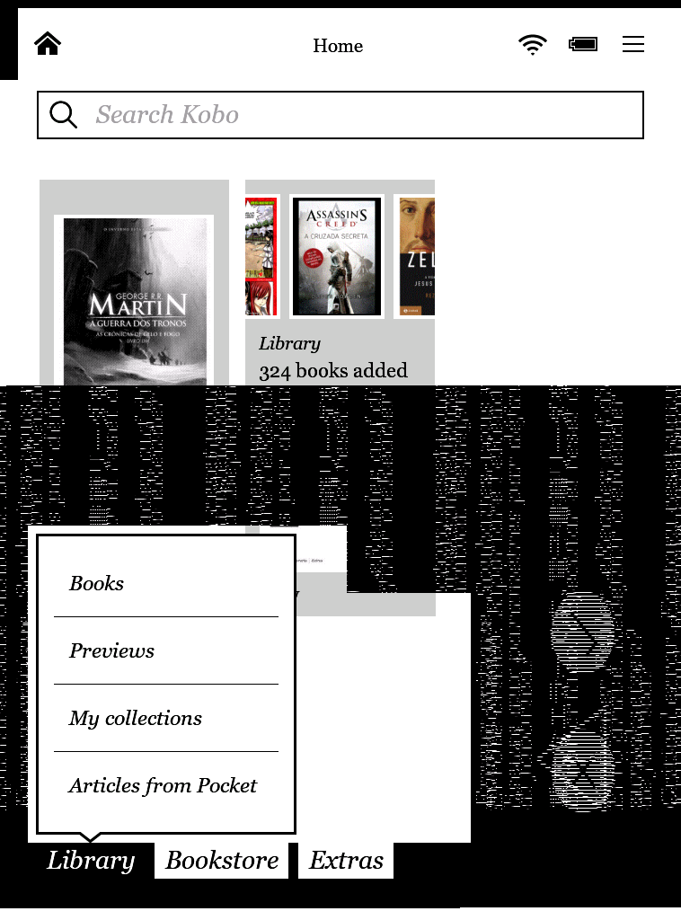

Originally Posted by tshering View Post
Interestingly, another Glo owner has also reported this problem. But if pickel showpic does really not work on Glo, I wonder what for instance happens to the on-animation, which uses pickel showpic. Aren't there the dancing squares visible on the Glo when you power it on?
when using pickel, nothing happens in the physical screen, but appears in the screenshot image (with wrong rotation)
part of the screenshot, appears only in the physical screen, after using the menus
