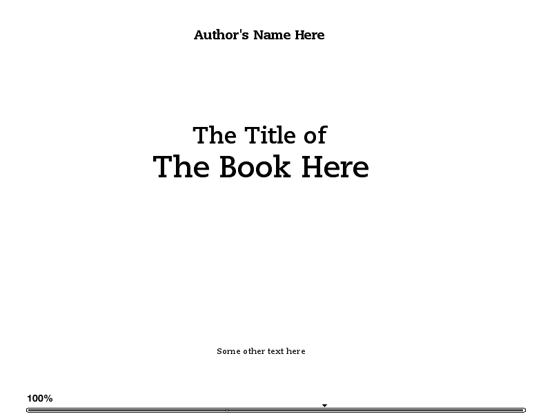

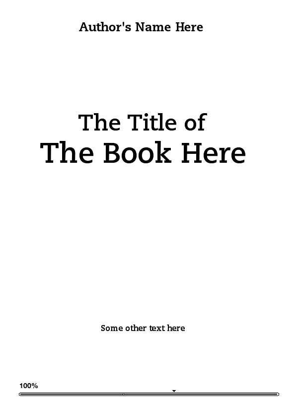

@RbnJrg
One friend reported to me a jumbled output (akin to the one of ADE 1.7.3) of your "title page", both for Kindle4 and Paperwhite1. Have you the same information? Is yes, how do you explain it?
Hi Roger:
I did the try in my K4NT and all looks ok; here you can see the respective screenshots (in portrait and landscape mode):
ID:	121709 Click image for larger version
Below you can see the respective .azw3 file. If you open it with Kindle Previewer, you'll see that the KPW preview is also ok. Maybe your friend compiled my original epub with Calibre instead of kindlegen/Kindle Previewer and for that reason he got what he got. Send the .azw3 attached to this post to your friend to know how this file appears in his Kindles.
Regards
Rubén
