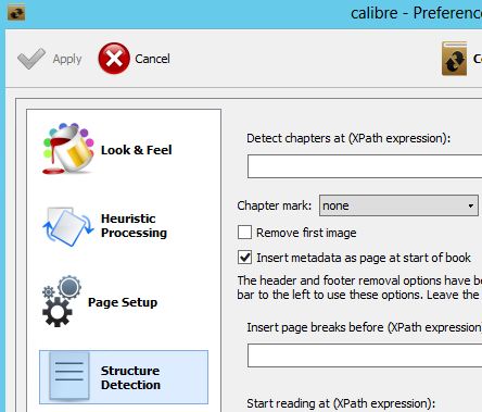

I don't know if this setting can have something to do with it.
Preferences -> Common Options -> Structure Detection -> Checkbox "Remove first image".
