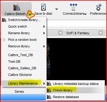

Then it is may be a good idea to check the library database and use the results as a working list.
This finds ERRORS, but not duplicated entries (books).
to the 'just split onto 2 memory sticks idea. You can pick the logic on what to split off to the other stick.

@tomtc - In particular I recommend you also take up Divingduck's suggestion - to run the Check Library process, see post https://www.mobileread.com/forums/sho...38&postcount=5
Whilst it's good to have a small library, it's even better to have one without any anomalies

Thanks to those who assisted. I ran the 'formats:#>1' search and removed duplicate formats (I chose the epubs as I have a kindle). Reduced my library to a more manageable 11gb. Have also took Divingduck's suggestion of a library check and I'm happy to say its looking good now.
