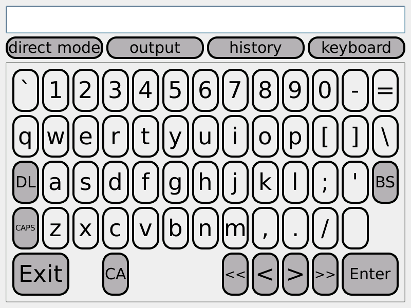

Device: kobo touch
terminal
To start the terminal, select "scripts > tools > start kbterminal.sh." Use "direct mode" for simple tasks (this means call an executable file, with arguments if applicable), like
cat /proc/cpuinfo
Use "file mode" for complexer tasks, like
x=$(cat /proc/cpuinfo | grep -i hardware); echo "see this: $x"
You can change the font size of the output field and the history list, for instance
kbt:fsize=45
You can change the timeout (how many milliseconds the application waits for the called process to finish), for instance
kbt:timeout=20000
The default value is -1 (no timeout).

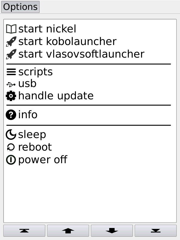

- It would be nice if there was a button at the Home menu to toggle the light at a standard (custom?) value. It takes me 4 clicks at every boot (and when I'm 'playing', there are lots) to see the menu.
- How difficult is to change the order of the menu? Is it an editable file or something more cryptic?
I would like the readers at the top and some separators (see attached pic for a Mockup).
Just cosmetics ...
- ... and an impossible one!
If I install the menu and the patch for the Android dual boot, I lose the USB connection. I can't connect either from the Menu nor the Nickel. Of course I can no longer boot Android.
I tried to install the menu before and after the patch. No change. The Menu and the readers work fine but without USB support.
So, is this merging impossible? It will look really nice to have an Android option there ...
Look at the function setoptions() in etc/init.d/rcS. There, the individual menu options are collected into the variable moptions. Here you can change the order. I don't have any idea yet about the separators.
Originally Posted by embryo View Post
- It would be nice if there was a button the Home menu to toggle the light at a standard (custom?) value. It takes me 4 clicks at every boot (and when I'm 'playing', there are lots) to see the menu.
A quick solution would be to move the frontlight option to the main menu. In order to do this, add "frontlight:menu.png" to moptions. Then add after the line
   case $selection in
      frontlight )
        sh $kbmenudir/scripts/frontlight.msh
This will take you with one click to the front light menu. You need one other click to select the light level, and another to return to the main menu. We can shorten this. In mnt/onboard/.kobo/kbmenu/scripts/frontlight.msh replace
     $frontlightprg "$selection"
     selection="EXIT"
Now you only need two clicks, one to open the frontlight menu, and the second to select the light level and return to the main menu.
Another possiblity would be to add two menu items to the main menu, say "light_on" and "light_off" (in rcS, moptions). In the case $selection in block, you could then call /mnt/onboard/.kobo/kbmenu/tools/frontlight with the argument "0" for "light_off", and once with "5" or whatever you think fit for "light_on." In this case it would need only one click.
I did not try any of this my self. So be warned. Be also aware that a mistake in the rcS file might force you to do a factory reset. I would at least make a syntax check (sh -n rcS) before installing it.
Well,I tried it, but I had no luck.
As a completely programming ignorant, I could not find a way to move the info from the top. I could move all the others anywhere, but when I moved the info somewhere else, everything before that position disappeared.
Photoshop was easier ...
The light mod went even worst.
When I made it, I couldn't boot to the menu (or Nickel) at all.
I must mistyped something somewhere ...
As I said, my programming skills are zero, so my security is the brute force of restoring the whole SD card image.
Since I haven't decided about the exact configuration of my Glo (I mostly use Android, but I play also a bit with Nickel), I keep the back of it open.
Anyway, thanks for the info ...
I added front light on/off to the main menu. I set the level of "front light on" to "4". If you want to change the level, for example to 6, add to the usersettings.txt
frontlightOnLevel=6
Simply put the KoboRoot.tgz into .kobo.
Edit: I should mention that with this version, there is also no need to reinsert the external SD in order to be recognized by the device.
