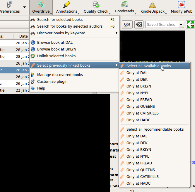

See screenshot. It will autofill these for you.
But it follows the format
identifiers:"=odid:@ebooks.nypl.org"
for example. In your case it would be:
identifiers:"=odid:@gloucestershire.lib.overdrive.com"
