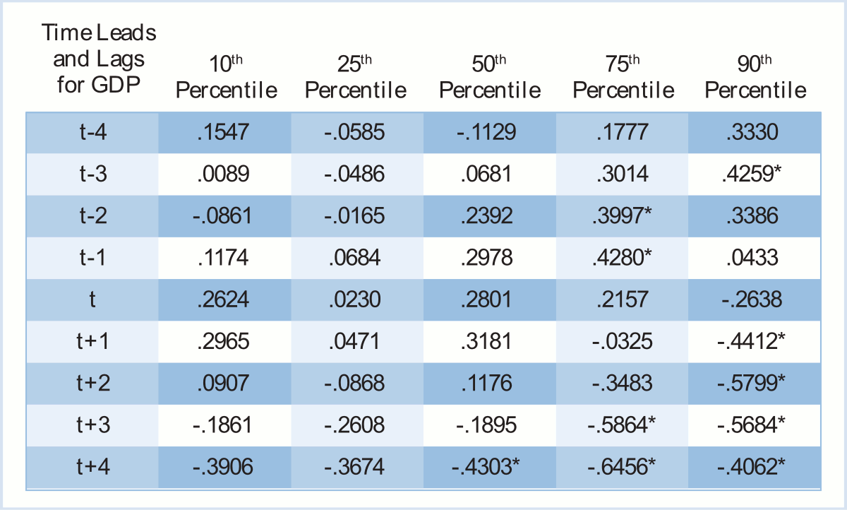

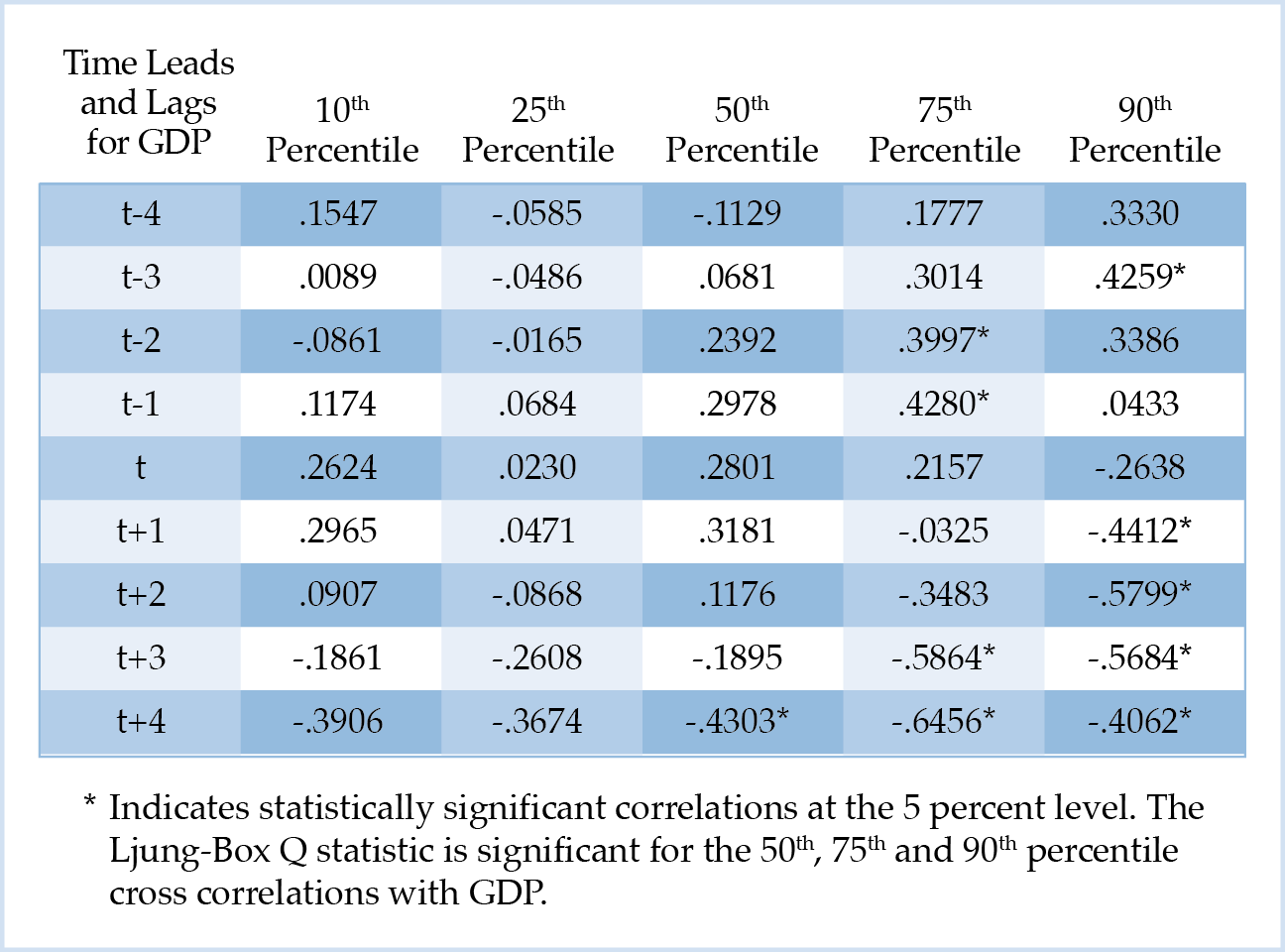

I am reminded about a long-running project I have going on with a Quarterly Journal we publish. I have been asking for all of the source files every quarter (so they don't get lost down the memory hole, I want to save any future selves from having to suffer through working backwards from a PDF!).
I have all of the tables/charts/graphs as .ai ... but Inkscape doesn't import/export them properly (the kerning in some of the fonts is off, the charts aren't bad, but this is especially noticeable in the Tables... think it might just be as easy as a font situation).
I don't have access to Illustrator, so I asked for some help from an amazing MR user... and he was kind enough to spend his time to export them for me! I was so ecstatic, and then after I took a closer look, I noticed that all of the table captions had the text included in the image.... I felt absolutely HORRIBLE.
ID:	116469 Click image for larger version
