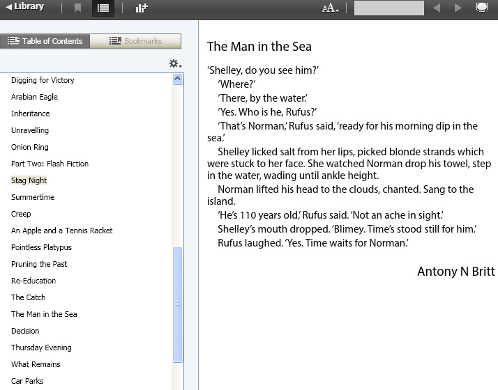

A publisher for whom I design ebooks has asked me to ask about a problem in one of the ebooks I've designed for her. The material in the attached screenshot images is under copyright, but she has given me permission to display it.
The problem is that when she looks at one section of the ebook with ADE the sentences seem to run together, particularly when there are quotation marks. When I look at the same material with the Sony desktop reader, a Sony ereader, a Kobo Touch, an iPad with iBooks and with Marvin, and the calibre reader I don't see any problem.
Has anyone else seen a similar problem? Can anyone suggest how I can fix it? The publisher and I think it is an ADE problem, but we'd like to be sure before releasing the ebook on an unsuspecting world.
I have attached an image of a screen shot of a flash fiction story read with ADE v2, and an image of a screen shot of the same story read with the Sony desktop reader.

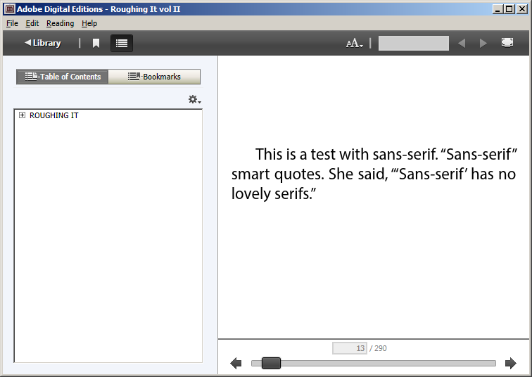

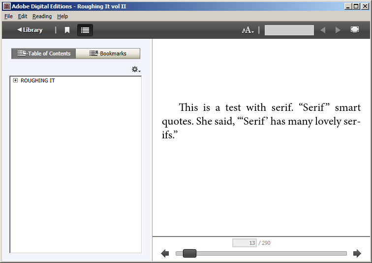

It does seem as though the ADE default sans-serif font is mostly to blame for this. (I never view in sans-serif, so this is news to me also).The default SERIF font seems to me to be fine.
See attached screenshots for comparison of ADE screen with default serif vs. sans-serif text fragment using smart quotes.
(I see Tex already posted a screenshot, but the zoomed image to compare on these might be helpful, I hope)
ID:	116222   Click image for larger version

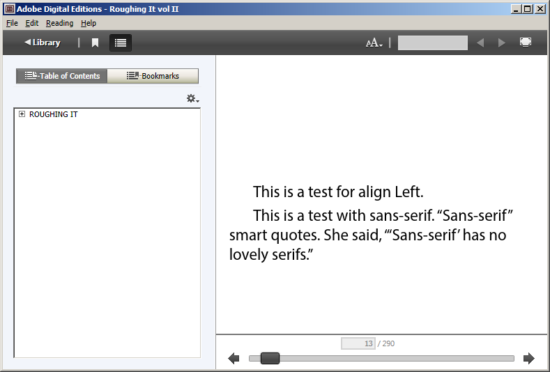

PS: @Jellby, when I check with align-left, the sans-serif is still more tightly kerned than the serif font. Maybe it is just a feature of that font...
ID:	116225   Click image for larger version
