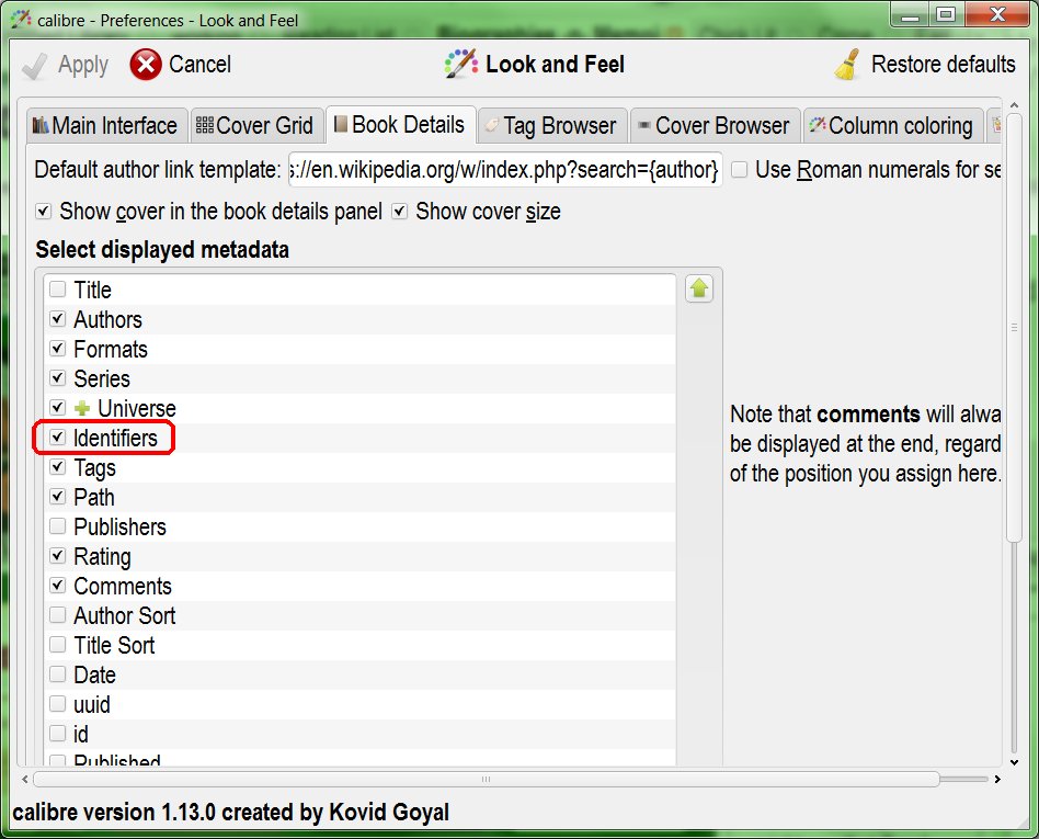

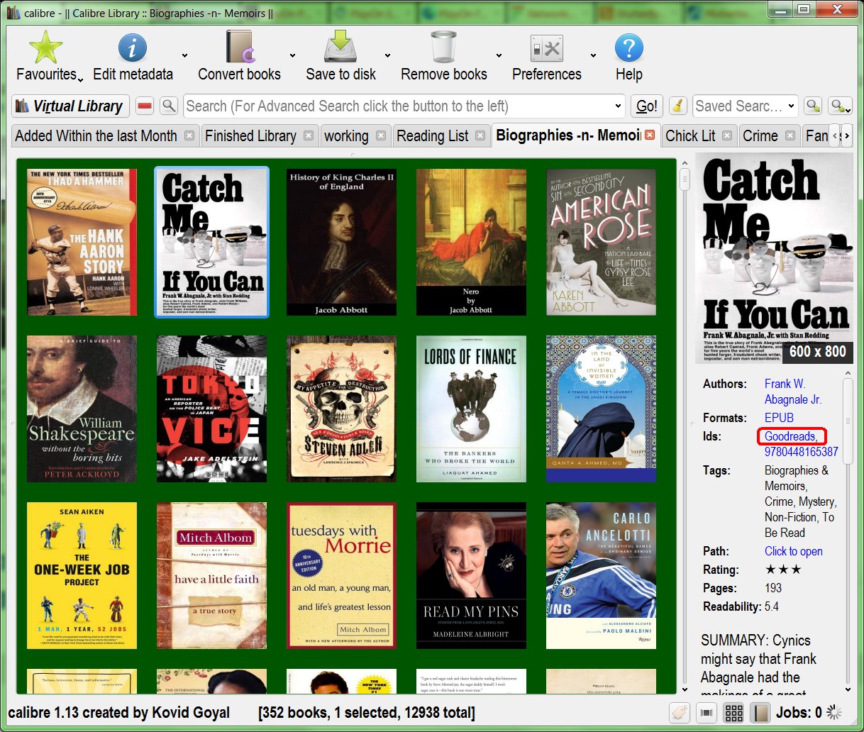

Originally Posted by dbareis View Post
Thanks for that, I have the plugin installed already and in "Edit Metadata" I can see that one of the "Ids" is for Goodreads however I can't see any clickable. Links in the details view or toolbar, I have all columns enabled.
The Goodreads ID in calibre is shown in the Book details pane, see attached. Simply click on the Goodreads link to open the Goodreads book info page.
If you don't see Ids in the Book Details pane go to Preferences - Look and Feel - Book Details tab and check Identifiers, see attached.

Originally Posted by DoctorOhh View Post
...Preferences - Look and Feel - Book Details tab and check Identifiers, see attached.
