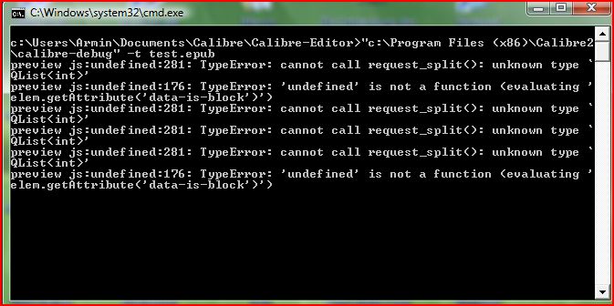

Ok. then I do not open a report
By the way, I just saw the error report too (didn't recognize it before)

I uploaded fixed builds, re-download and re-install and that error should go away. And as a bonus you can now search in the preview panel as well.

split and merge are working.Thanks a lot.
