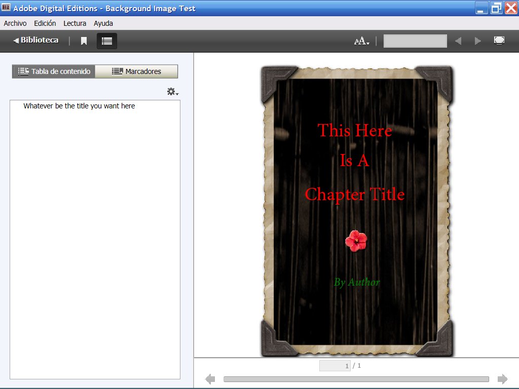

My english is not so good so I don't understand you very well; what is your issue now? The problem is that you lost all <h1> tags? If the text over your background image works fine, then the another issue is trivial.
According to what I posted, indeed, there is not any <h1> tag so it can't appear in the TOC . Suppose you have something like that:
<div>
  <svg xmlns="http://www.w3.org/2000/svg" height="100%" preserveAspectRatio="xMidYMid meet" version="1.1" viewBox="0 0 533 800" width="100%" xmlns:xlink="http://www.w3.org/1999/xlink">
    <image height="800" width="533" xlink:href="../Images/bamboo_fence.jpg"></image>
    <text fill="red" style="font-size: 50px" text-anchor="middle" x="266.5" y="200">
      This Here
      <tspan x="266.5" y="280">Is A</tspan>
      <tspan x="266.5" y="370">Chapter Title</tspan>
    </text>
    <image height="63" width="63" x="235" xlink:href="../Images/ornament.png" y="450"></image>
    <text fill="green" style="font-size: 30px; font-style: italic" text-anchor="middle" x="266.5" y="600">By Author</text>
  </svg>
</div>
Then do the following:
1. First, in your stylesheet.css file, add this:
h1 {
    display: none;
2. Now above the <div> tags where you enclose your svg wraper write:
<h1 title="Whatever be the title you want here">&nbsp;</h1>
Of this way, you'll end with something like this:
<div>
      This Here
    </text>
  </svg>
</div>
Now regenerate the TOC by pressing Ctrl+T in Sigil. You'll see what you want to see
I couldn't get this to work for me -- at least, not with that background image that I've been using. I'm assuming that I'm doing something wrong, but I don't know what. That background image is 1200x1800, but I adjusted the code you gave at the above link to give the image a height of 900.
In Sigil it looks fine -- and I haven't looked yet, but I'm guessing it probably would look fine in iBooks -- but in ADE it doesn't work at all.
I don't know why is not working in ADE for you; maybe you are doing something wrong; see this screenshot of my ADE:
Could you post here the image you are using and the text you want to write over it? Maybe of that way I can say you more things about what to do.
Regards
Rubén

Exactly. As I said above, <svg> (or <img>) is not allowed to be the direct child of a <blockquote>, because <blockquote> can only have block-level children. That's not a surprise.
But I think you misunderstand the message. The list is not giving all the elements where <svg> is forbidden, but all the elements that are allowed there: and "svg" (or "img") is not in the list, hence the error.
The case with <p> or <hX> is entirely different. Those can have character-level children, and therefore <svg> or <img>. Do you get validation errors with <svg> inside <p> or <hX>?
