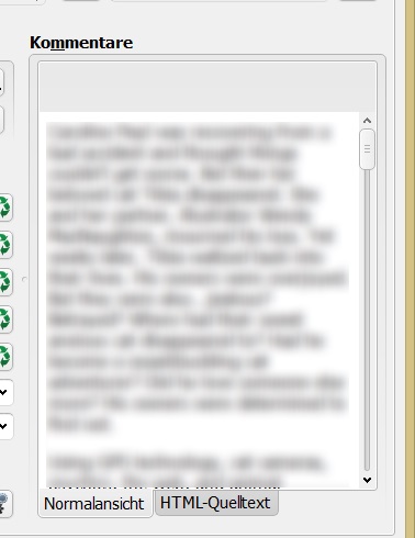

Hello guys,
i have the following problem since a few days: with calibre v1.9 64Bit, when editing the metadada of a book there are no icons on top the normal view. The second problem: when editing in HTML-view the changes are not saved.
Does anyone have an idea what could be the reason for this or how i can repair it?
edit: i did a re-install where i choosed the option to "repair" but that didn't help.
(the attached screenshot shows the comments part of the metadata-edit-dialog with(out) the icons in normal-view)

If that was the book viewer, the install was corrupt.
Use the control Panel and uninstall Calibre
Delete the previous 1.9 download and get a Fresh one.
Install that.
Your library remains during uninstalls

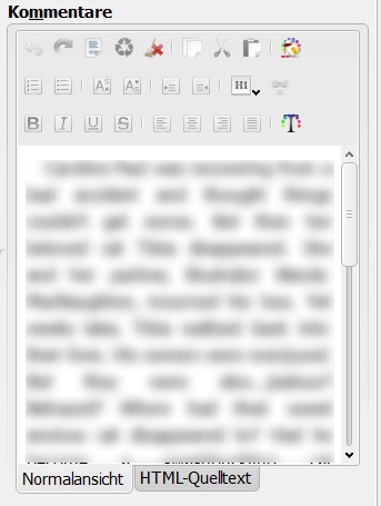

Hi theducks!
Many, many thanks! I succeeded in following your advice: i downloaded the 1.9 again and installed it - and now everything is okay again:
Look at the attached screenshot! All the icons are there again and changes to the HTML-source of the comments are changed as desired! Yippeeh!
btw: it wasn't the book viewer - it was the main program, editing the metadata from a single book (right-mouse click on a book, first menu-item, then again first menu-item)

I see that now, you trimmed the pictur so far, I did not see that it was part of the Metadata edit window
