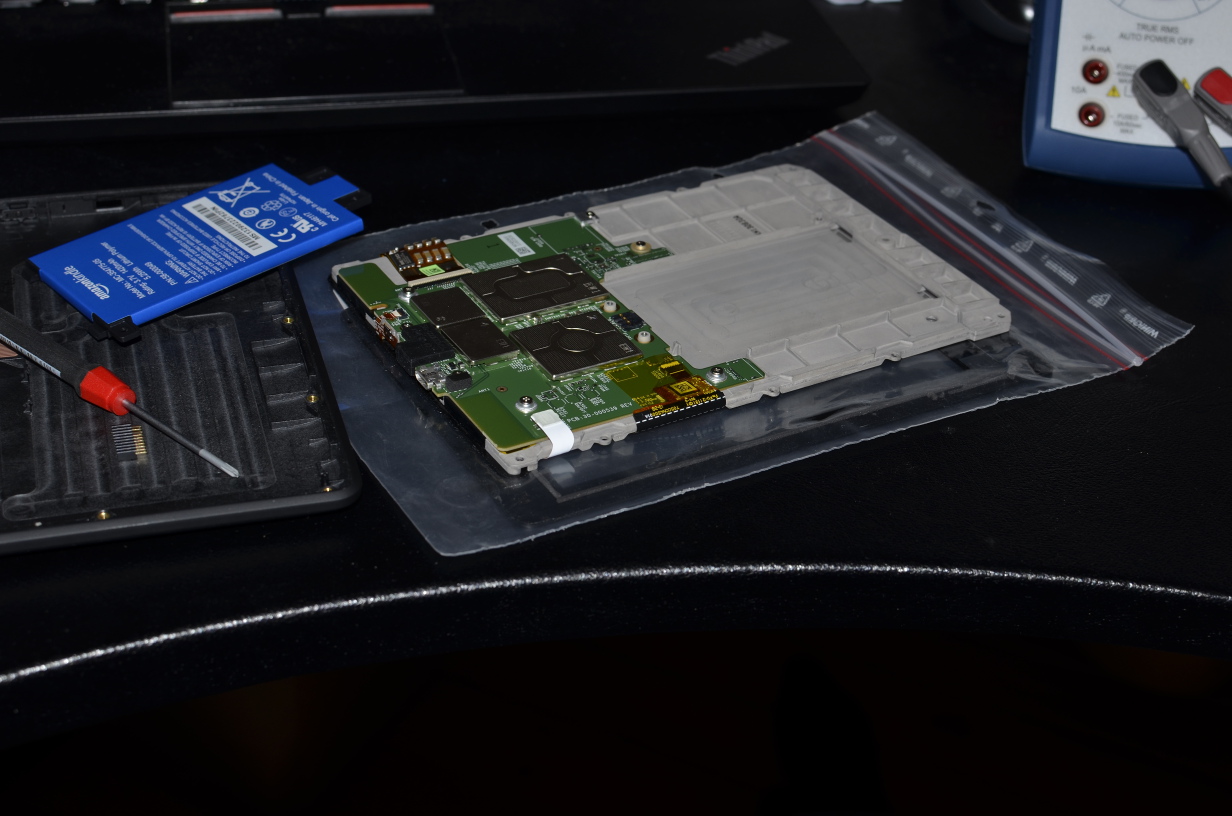

Hi all,
my PW2 arrived last week and it kind of bothered me that I couldn't put my favourite screensaver on it. So, after reading this thread, I decided to give rooting via the serial console a try.
Disassembly was surprisingly easy:

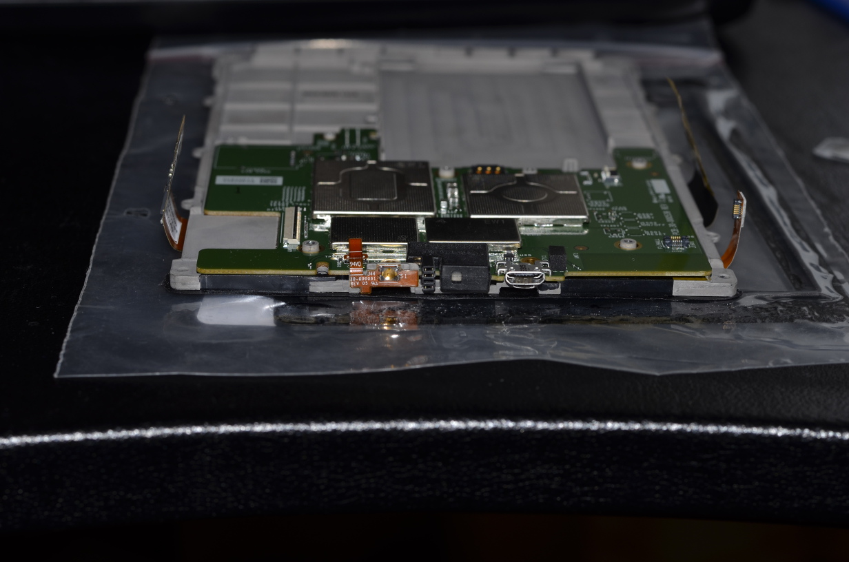

Since I do not want to disassemble the device again whenever I need access to the console, I looked for a way to make the serial port accessible from outside. There is just enough space between the button and the LED cover to squeeze in a 1.27mm header connector with four ports. I had to saw halfway through the connector at the second hole from the bottom in order to slip it on to the PCB. Closing this hole with epoxy also makes the connector asymmetric.

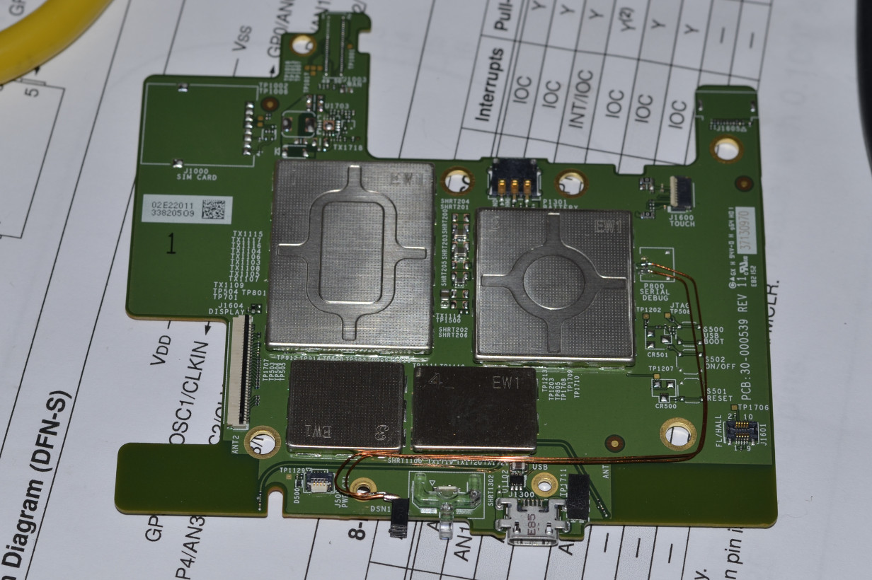

Next I had to connect the two data pins at the top of the connector to the RX/TX pads on the PCB. Enamelled wire comes in real handy here. The third contact at the bottom of the connector is wired to GND under the PCB.

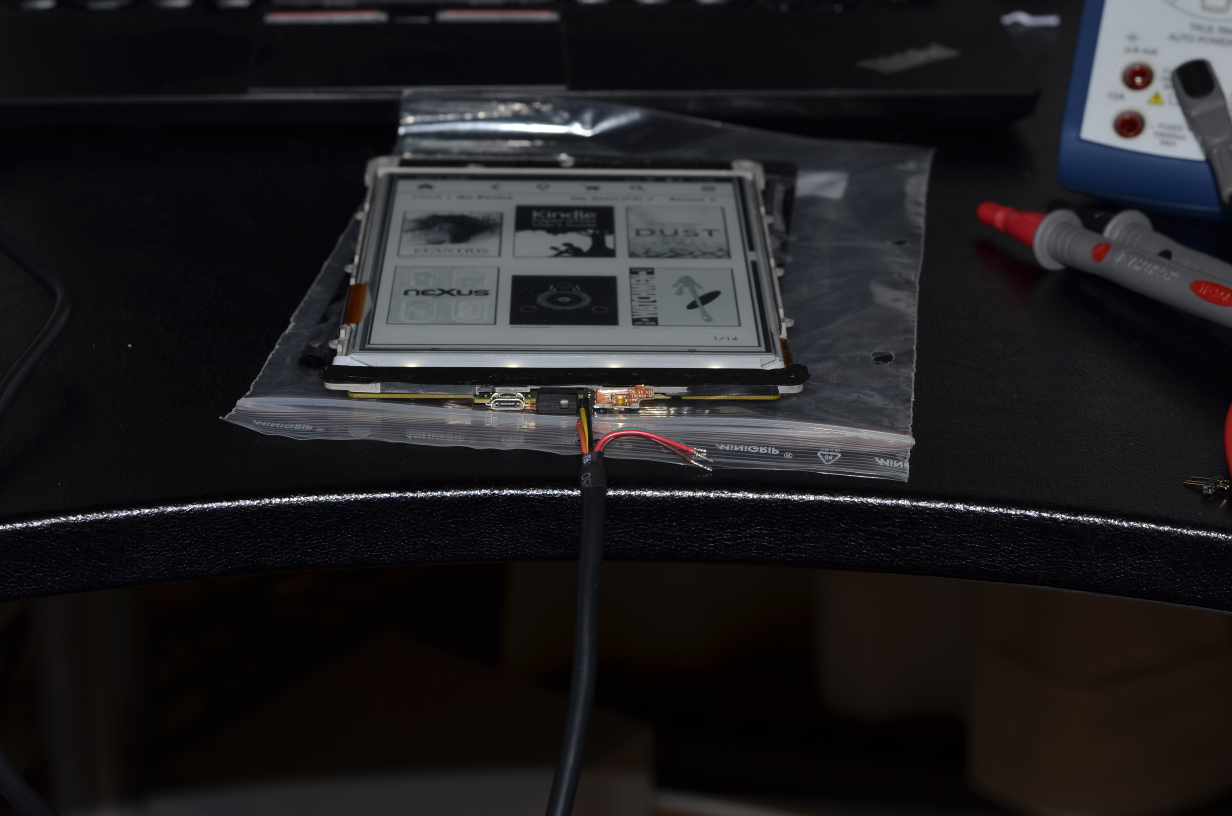

First test after soldering. To my great surprise, everything worked and I could play around with u-boot.

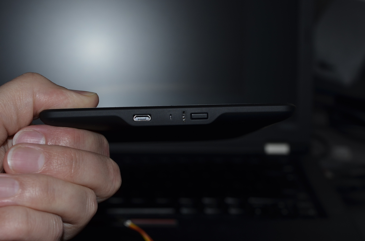

Now came the really hard part, fitting everything into the housing again. I had to remove one of the straps holding the button and carve a slot so the connector would be accessible from outside.

That looks like a great little bit of mechanical handy work.
Almost like it was meant to be there.

Thanks for the comments. The hardest part really was figuring out where to put the header and then cutting and sanding it down to actually fit in there.
Now I'll have some exploring to do on the embedded Linux
