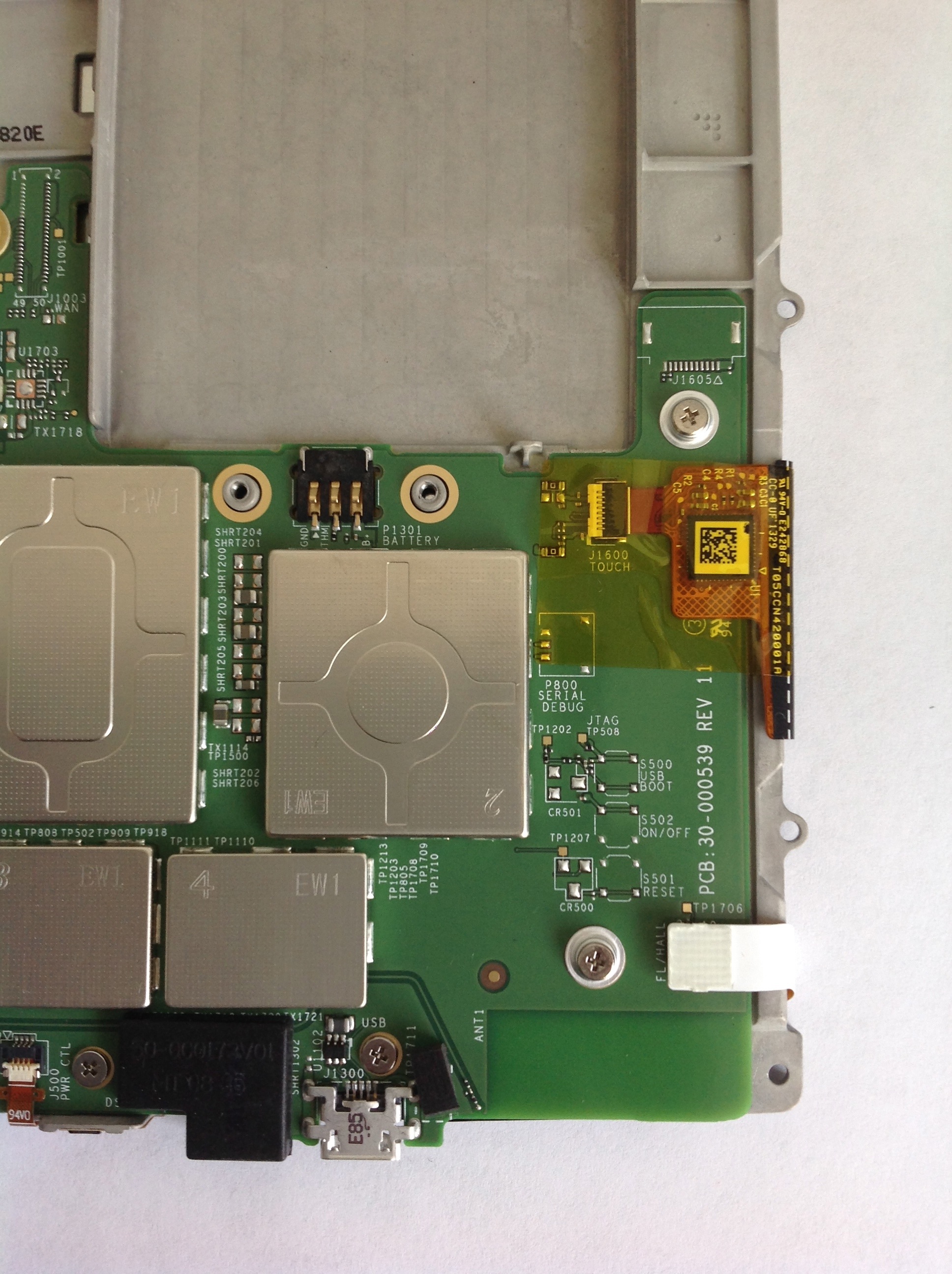

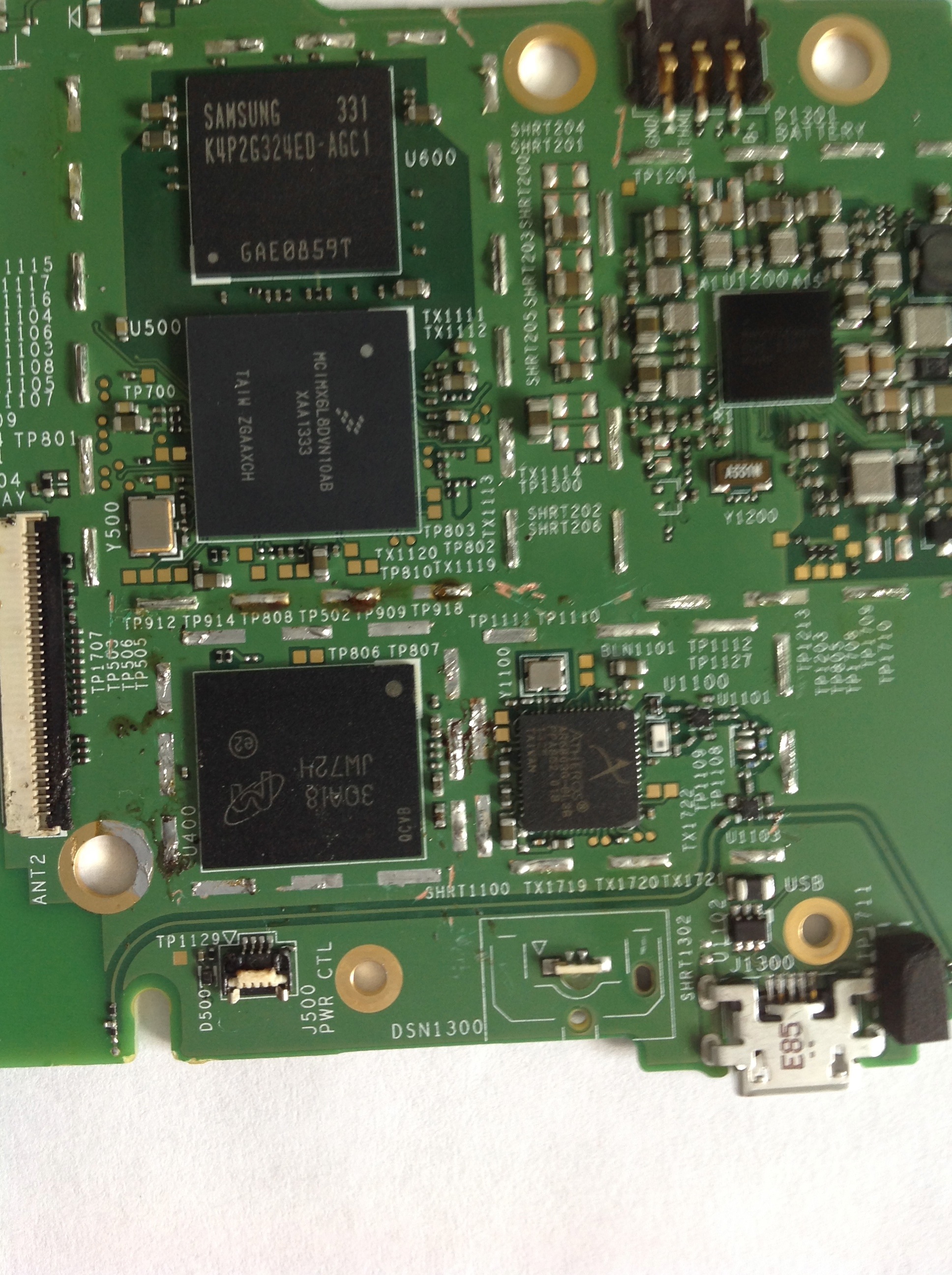

So for that, then the pictures that show part numbers is required. Have to id the flash chip part number and look up its datasheet.)

The serial port connection is the same PCB pattern on the Kpw2 as the Kpw1 - so I would use the same labels on the connection points.
(Lazy draftsman - reused the connection layout file.)

npoland, thanks for your efforts. This topic is for now defintely the most interesting place for those who familiar with software internals of previous Kindles. Will wait for release of rootfs dump. Ahhh, suspense time...
UPD: BTW, mmc driver in PW2 kernel has access to eMMC internal boot partition (where U-Boot is stored). Here is relevant excerpt:
Originally Posted by PW2 kernel log
<6>[    0.394228] mmcblk0: mmc0:0001 MMC02G 1.83 GiB.
<6>[    0.394346] mmcblk0boot0: mmc0:0001 MMC02G partition 1 2.00 MiB
<6>[    0.394464] mmcblk0boot1: mmc0:0001 MMC02G partition 2 2.00 MiB
<6>[    0.396966]  mmcblk0: p1 p2 p3 p4
<6>[    0.399315]  mmcblk0boot1: unknown partition table
<6>[    0.401401]  mmcblk0boot0: unknown partition table

Nice -
Should make it easier to install Tizen
Board/Parts pictures on the way, later in the day.
Amazon has already posted a (broken) link to the 5.4.0 sources.

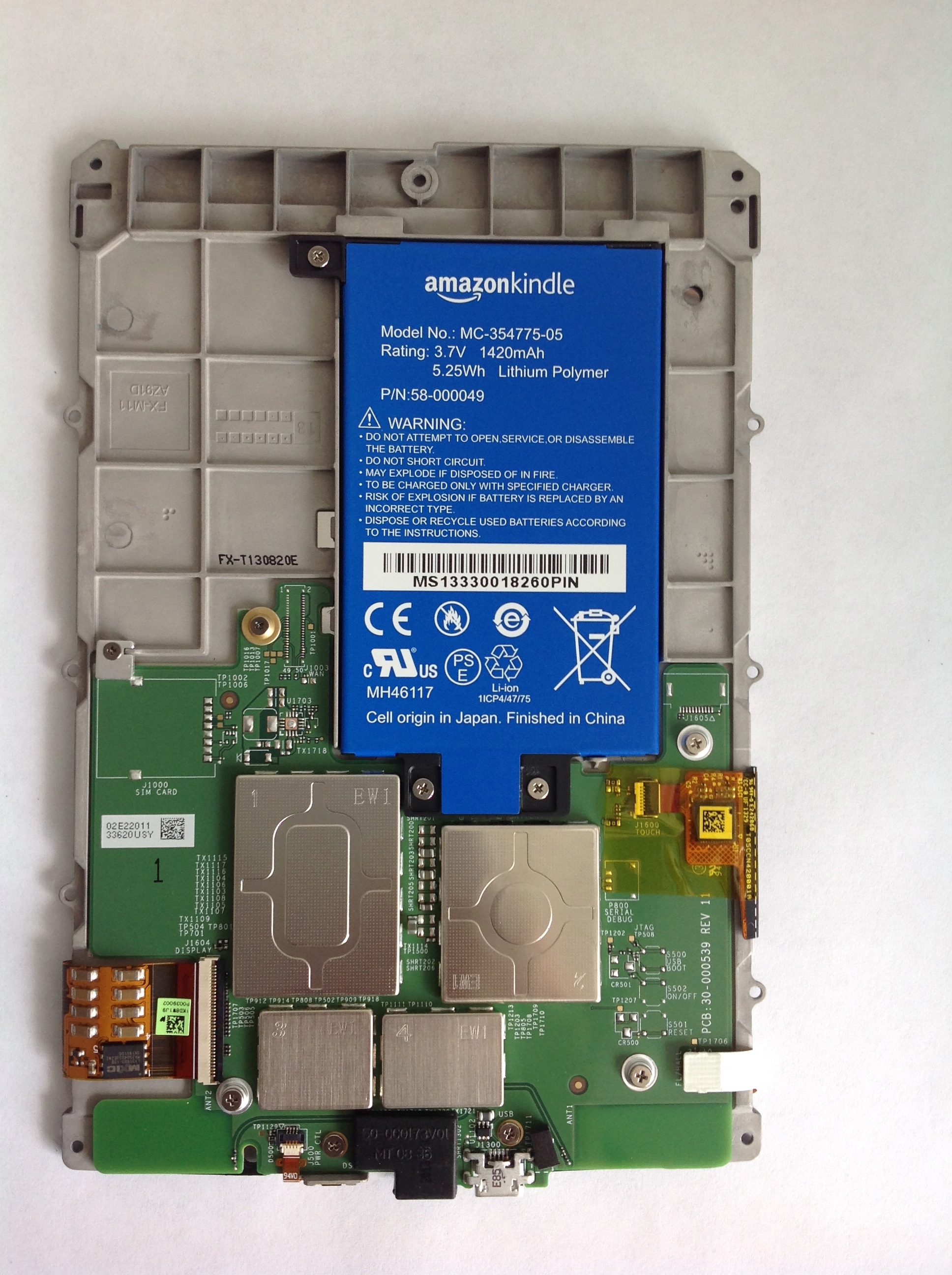

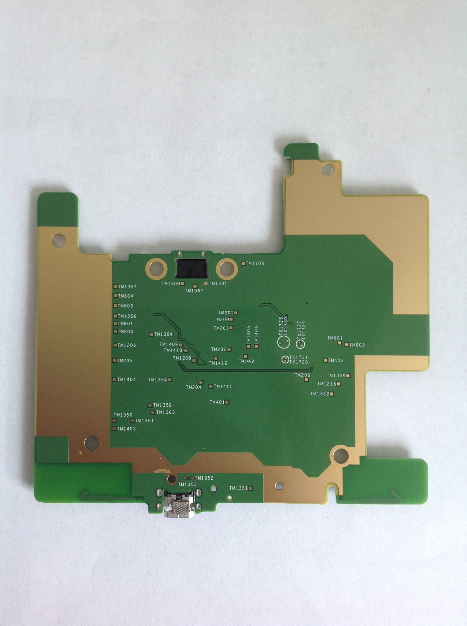

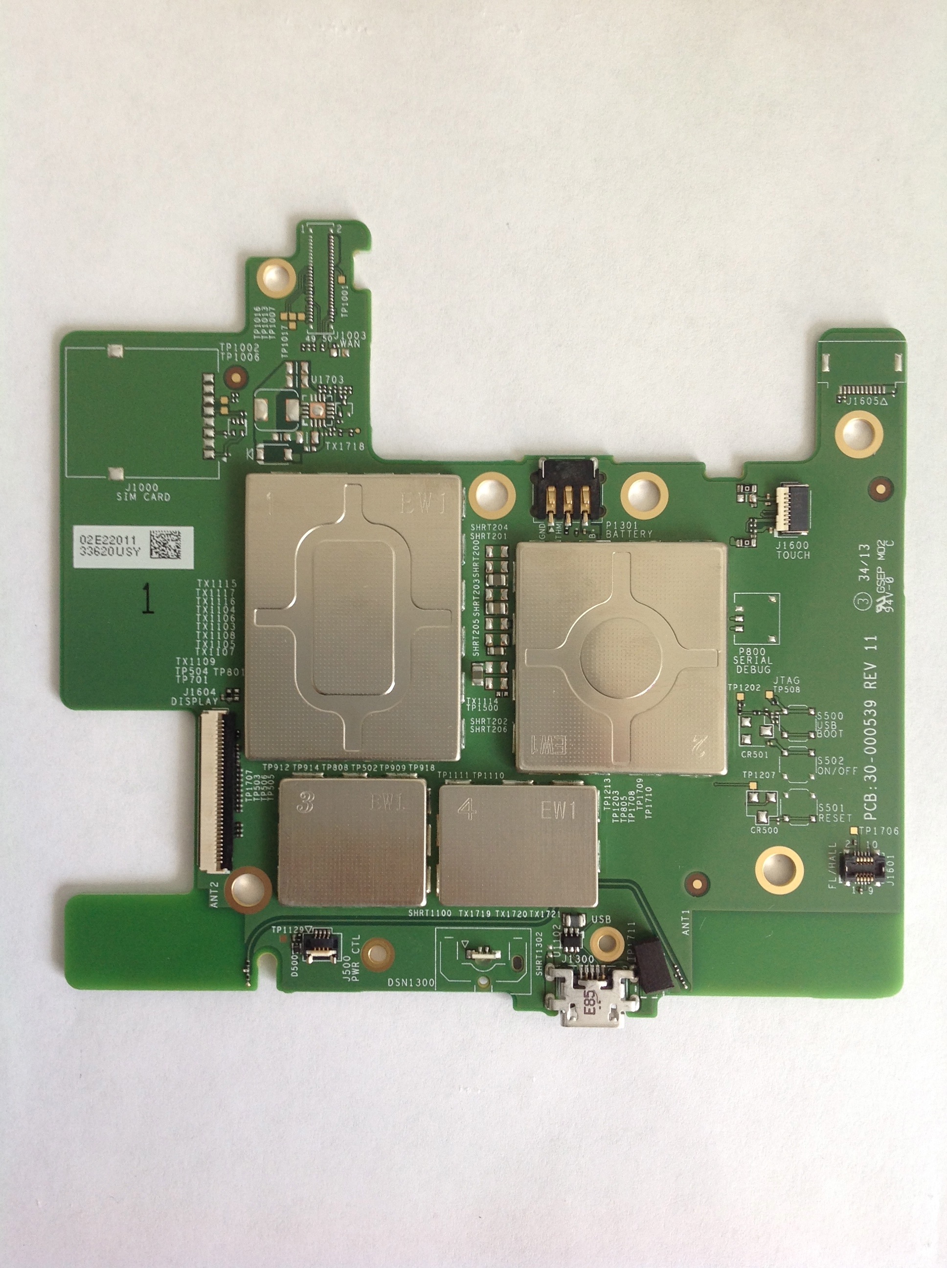

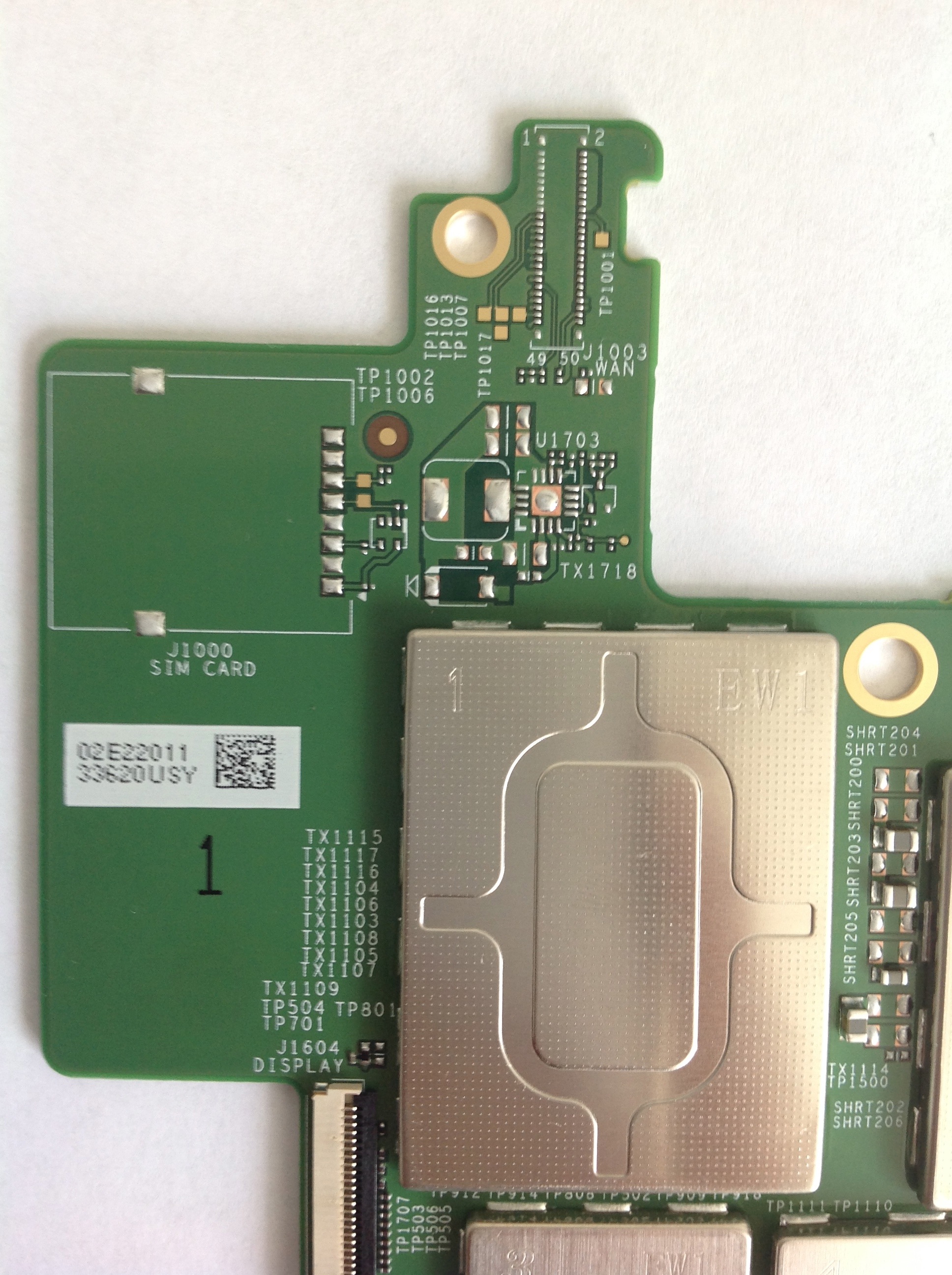

Old 10-02-2013, 06:39 PM   #45
npoland
1st KPW2 JB
npoland puts his or her pants on both legs at a time.npoland puts his or her pants on both legs at a time.npoland puts his or her pants on both legs at a time.npoland puts his or her pants on both legs at a time.npoland puts his or her pants on both legs at a time.npoland puts his or her pants on both legs at a time.npoland puts his or her pants on both legs at a time.npoland puts his or her pants on both legs at a time.npoland puts his or her pants on both legs at a time.npoland puts his or her pants on both legs at a time.npoland puts his or her pants on both legs at a time.
Posts: 26
Karma: 133537
Join Date: Oct 2013
Device: PW2

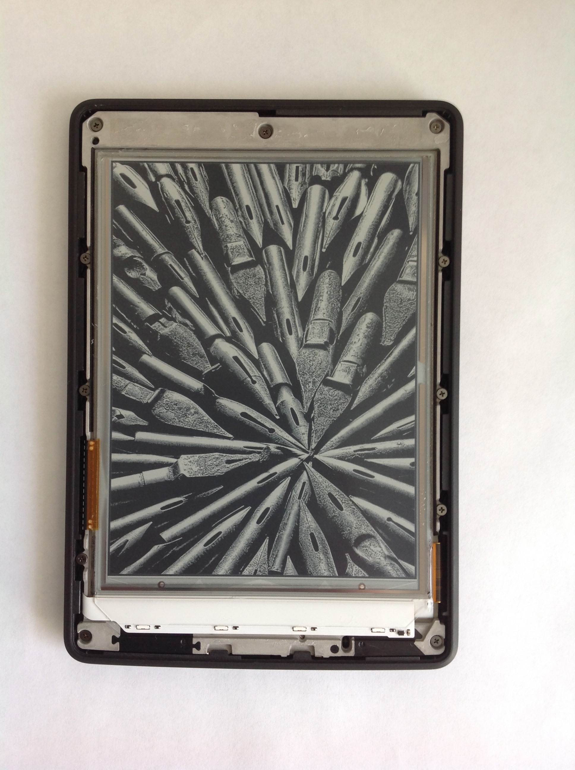

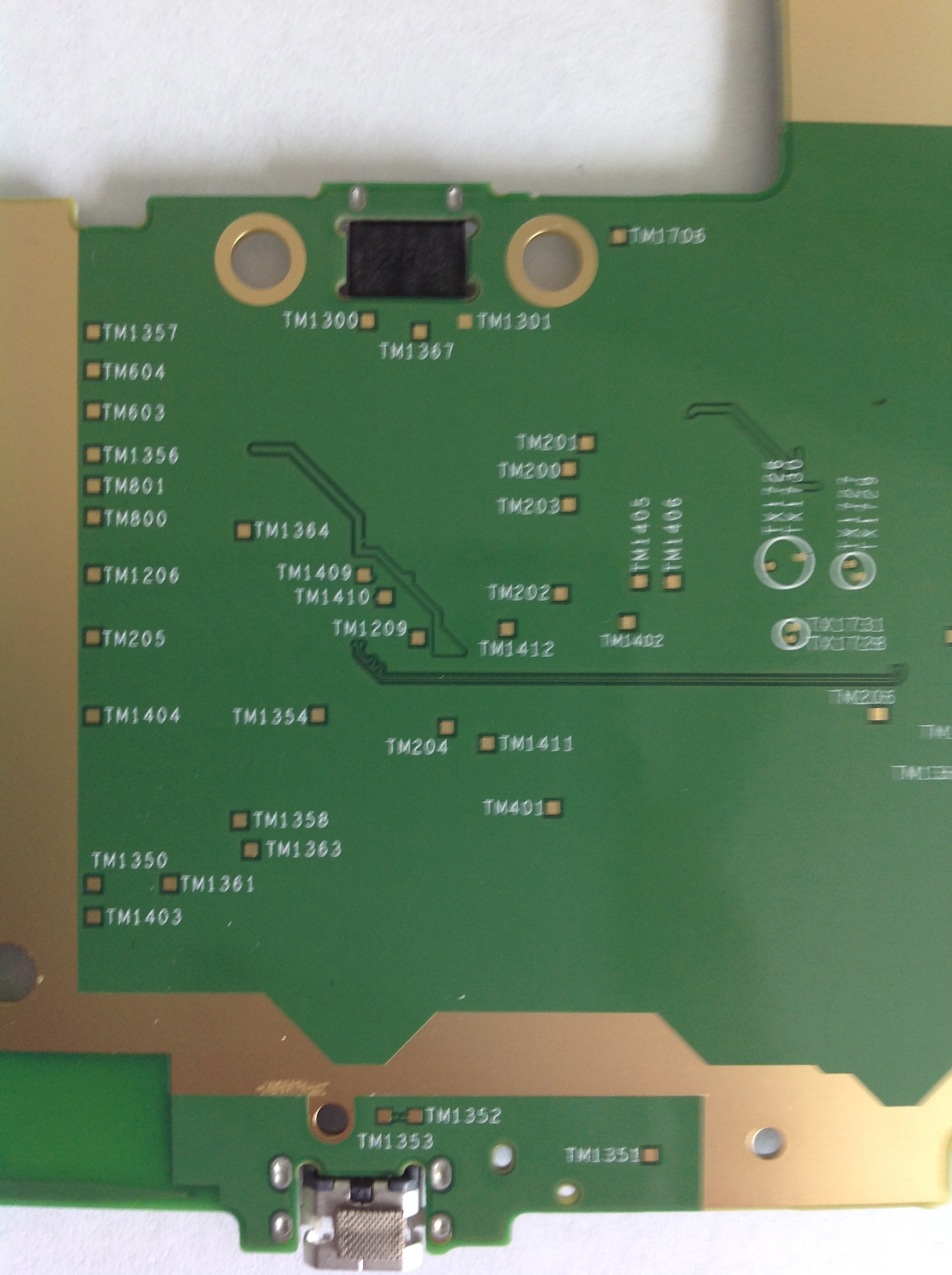

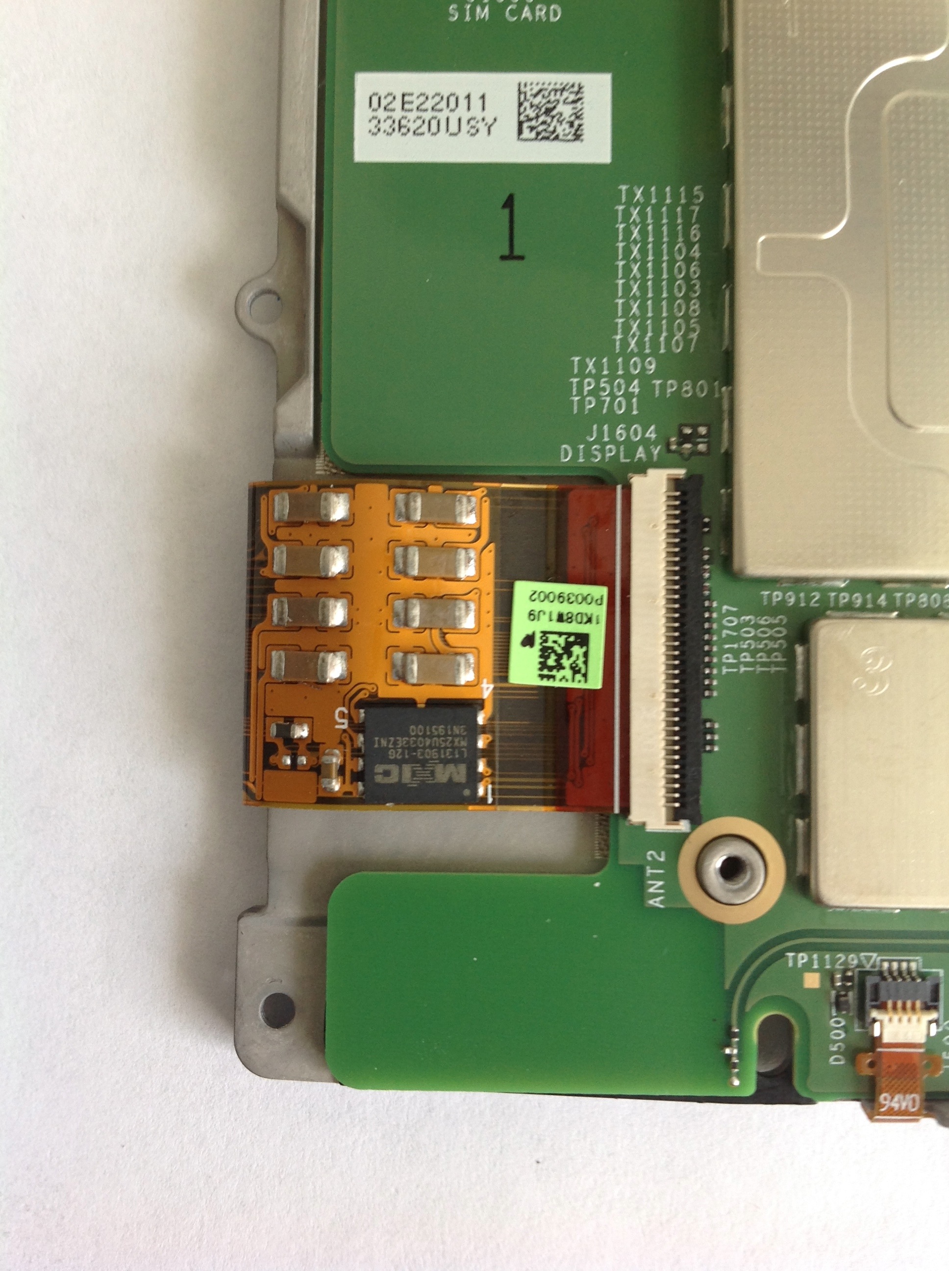

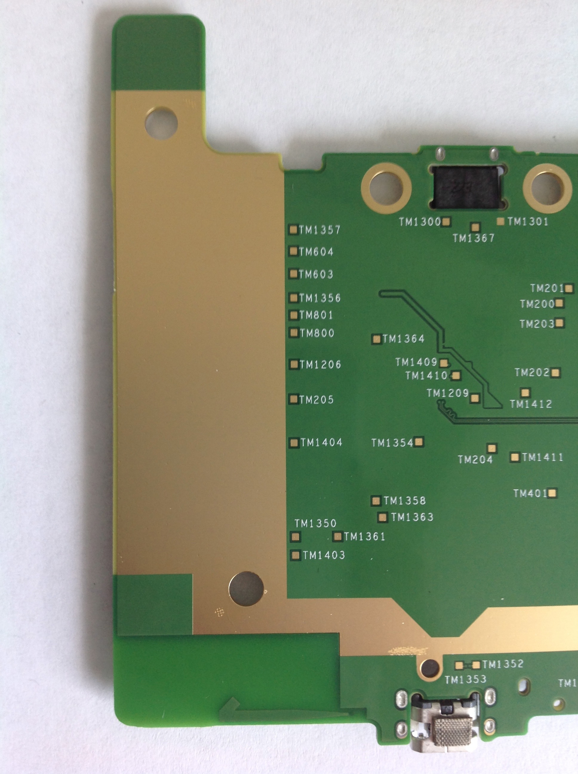

Teardown Images. I may have heated some connectors a bit much while tearing it apart. Everything still works though.
ID:	112653   Click image for larger version
ID:	112654   Click image for larger version
ID:	112655   Click image for larger version
ID:	112656   Click image for larger version
ID:	112657   Click image for larger version
ID:	112658   Click image for larger version
ID:	112659   Click image for larger version
ID:	112660   Click image for larger version
ID:	112661   Click image for larger version
ID:	112662   Click image for larger version
ID:	112663   Click image for larger version
ID:	112664   Click image for larger version
ID:	112665   Click image for larger version
ID:	112666   Click image for larger version
npoland is offline   Reply With Quote
