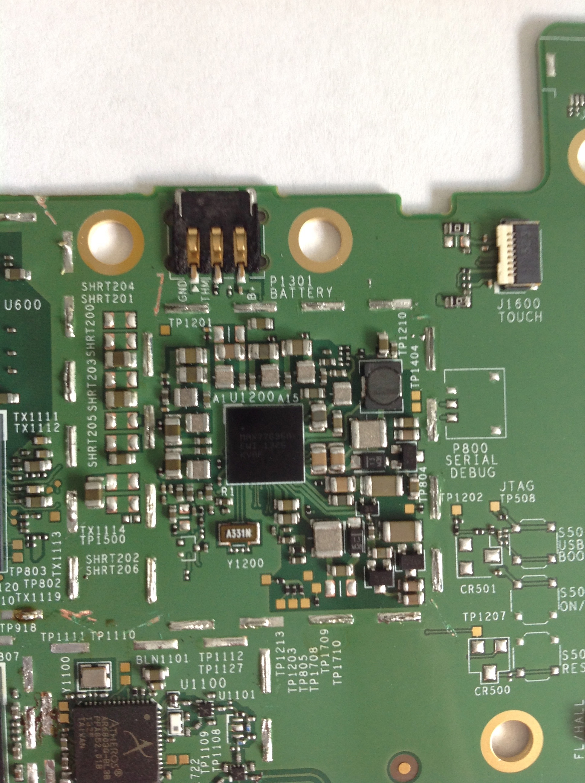

So for that, then the pictures that show part numbers is required. Have to id the flash chip part number and look up its datasheet.)

The serial port connection is the same PCB pattern on the Kpw2 as the Kpw1 - so I would use the same labels on the connection points.
(Lazy draftsman - reused the connection layout file.)

Board/Parts pictures on the way, later in the day.

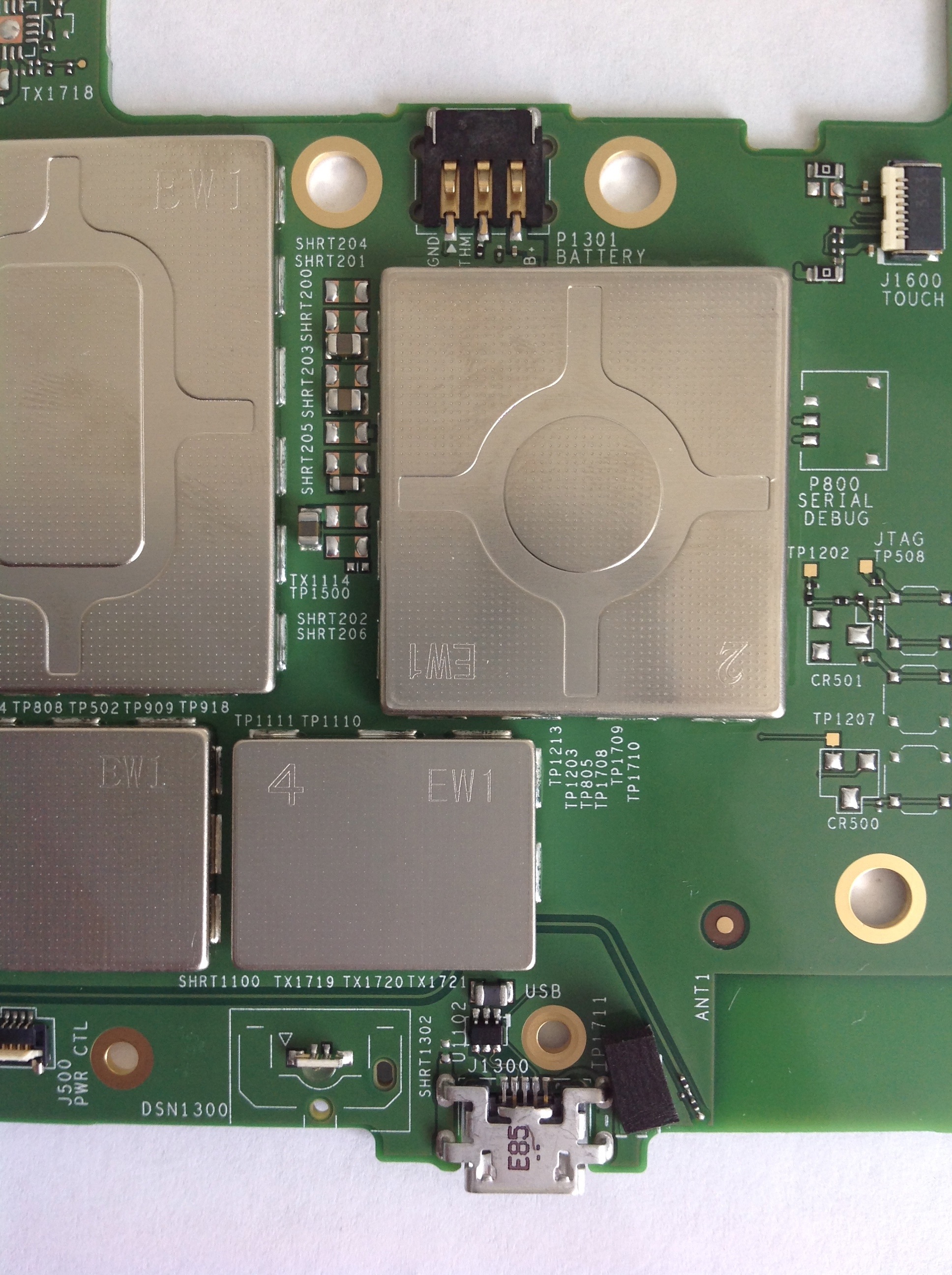

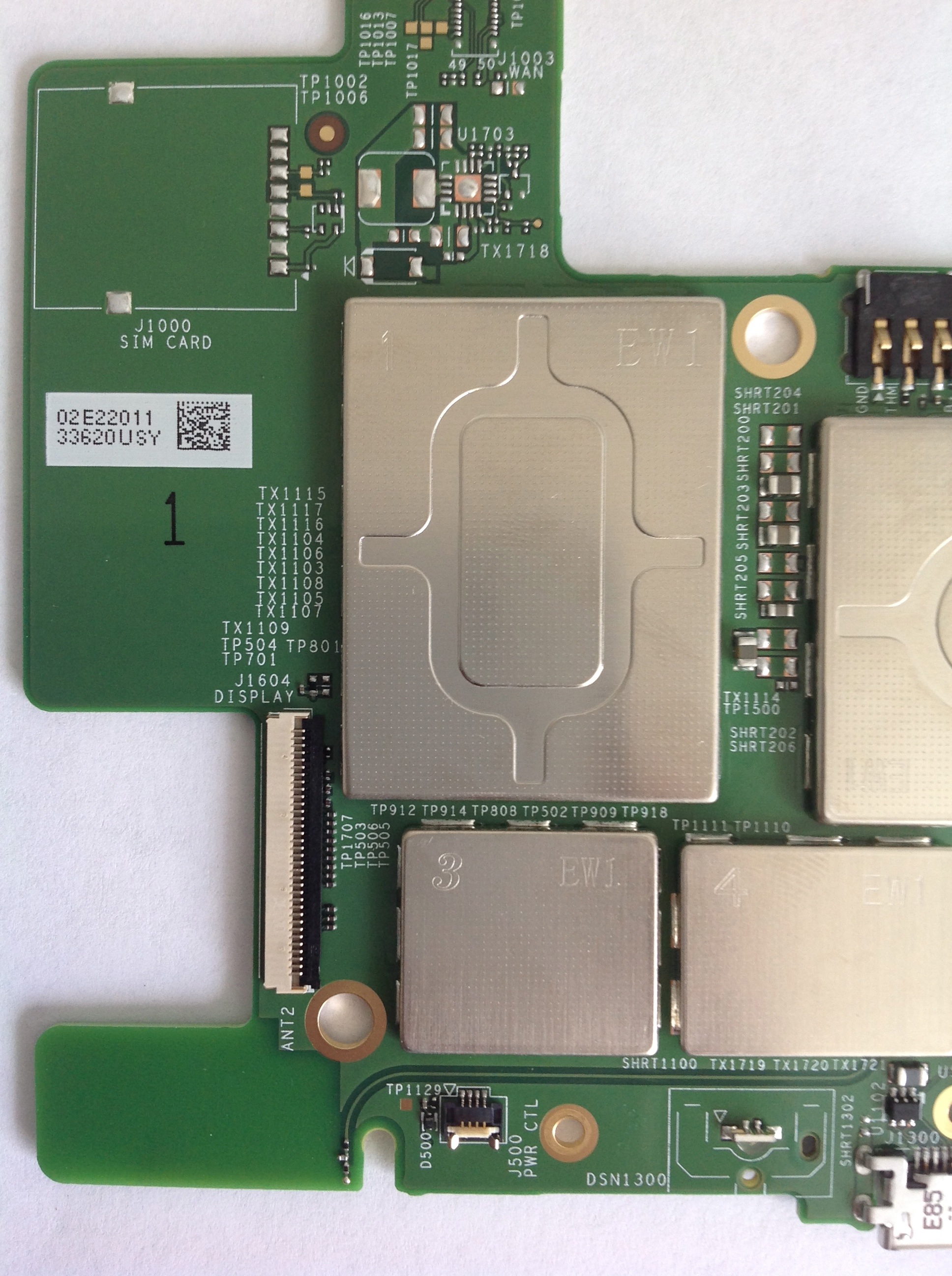

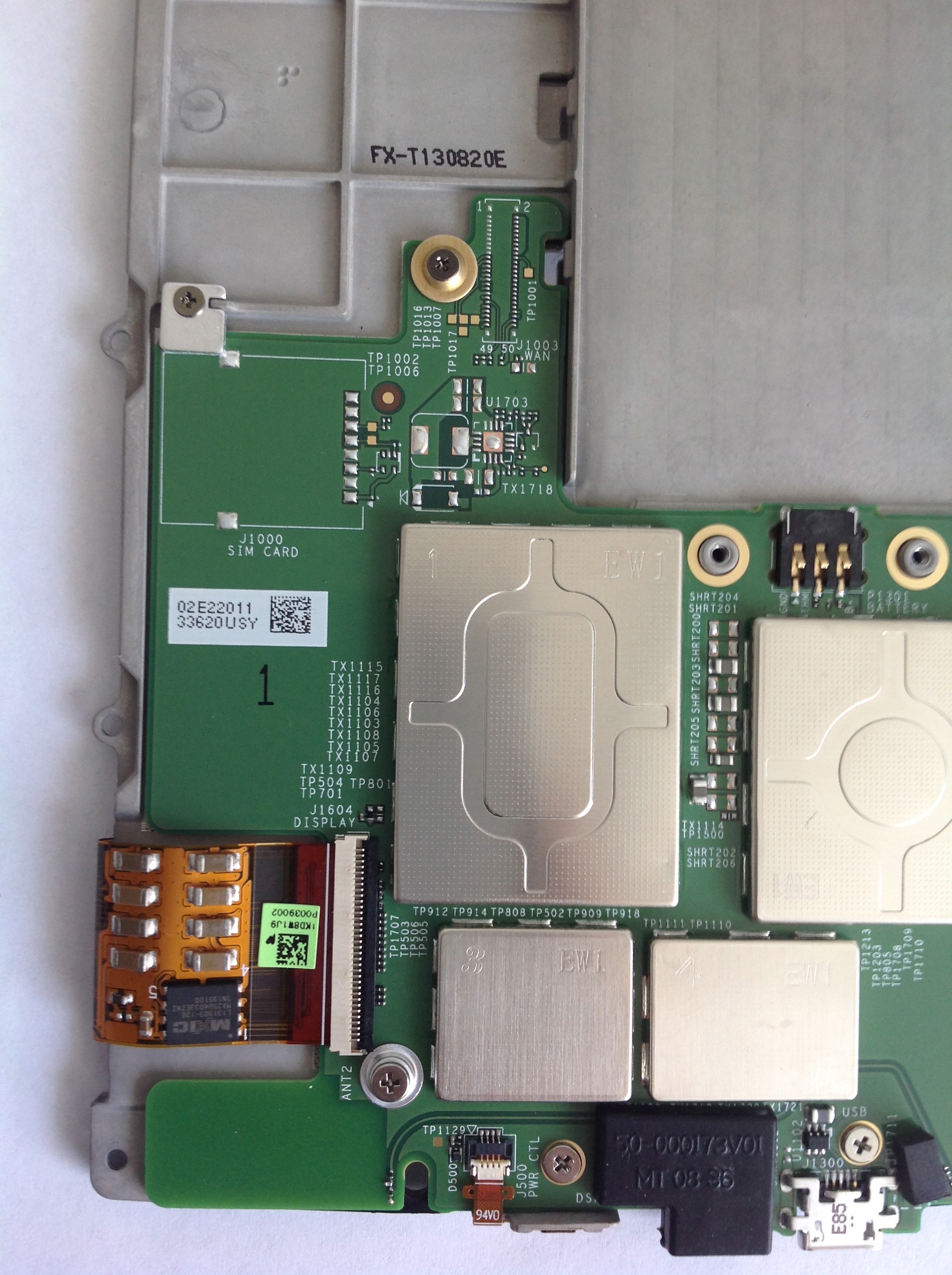

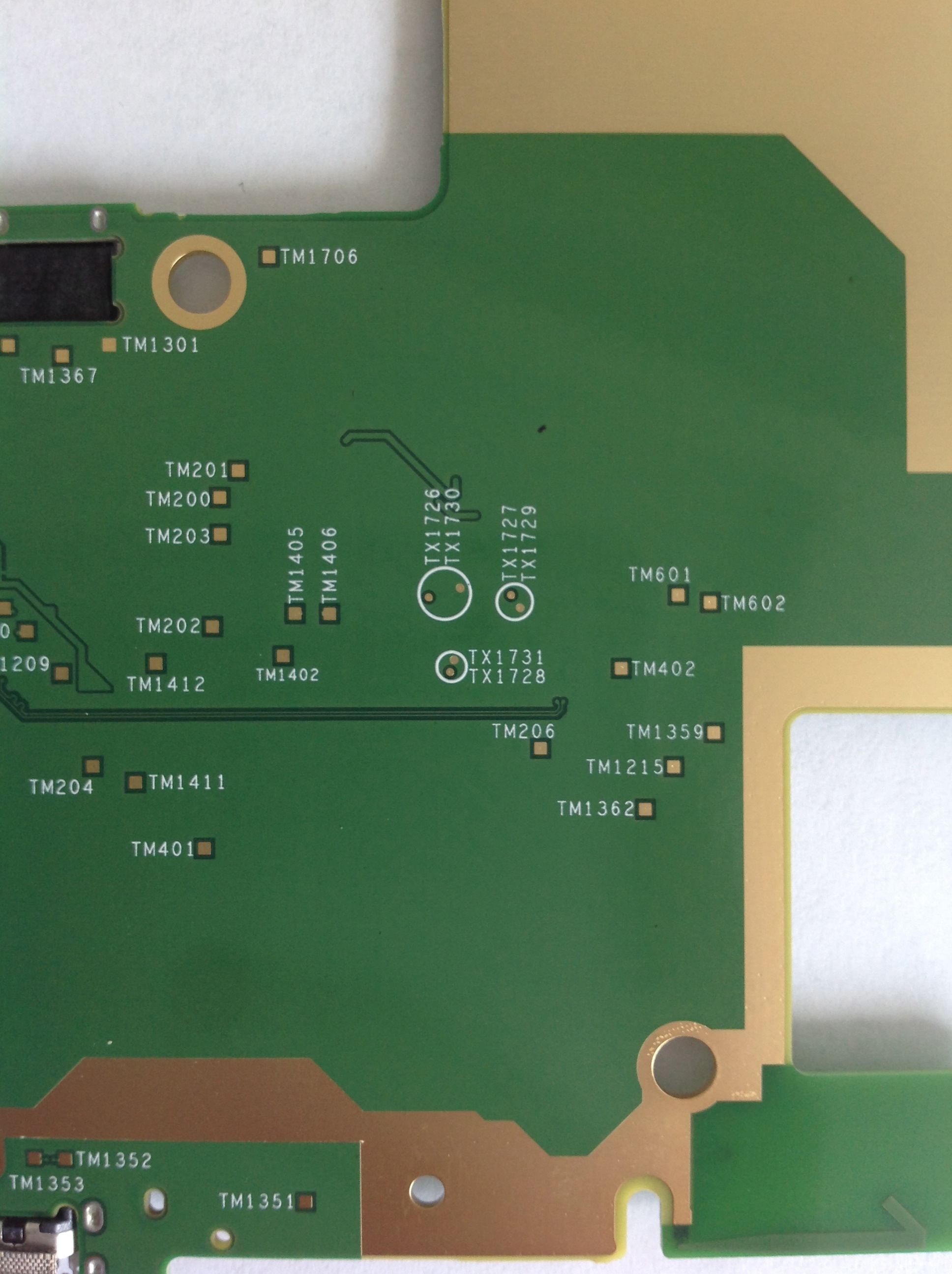

Teardown Images. I may have heated some connectors a bit much while tearing it apart. Everything still works though.
