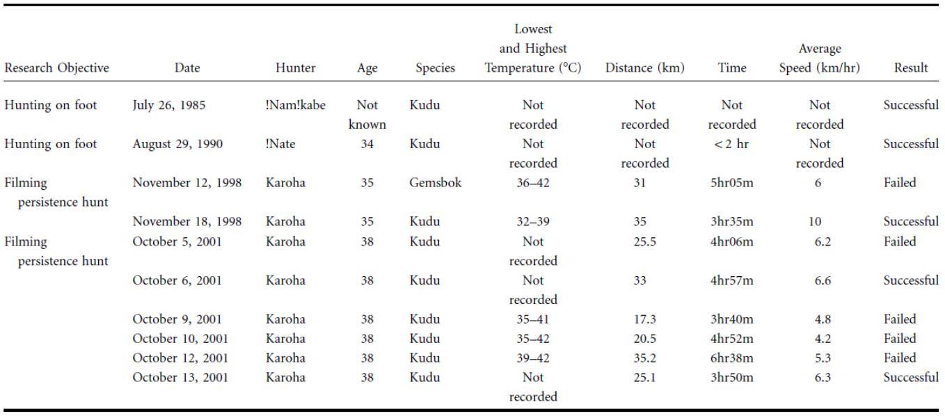

Tables in an epub?
Folks,
I am in the middle of converting a pdf to an epub. The source includes several large tables (example .jpeg attached).
Currently, I'm just generating them as jpegs, but have been considering converting them to <table>s in the html. My strong intuition is that a table this wide in html isn't going to render in a sane way on any current ereader, and this isn't worth pursuing.
Are jpegs the best way to go with tables like this?

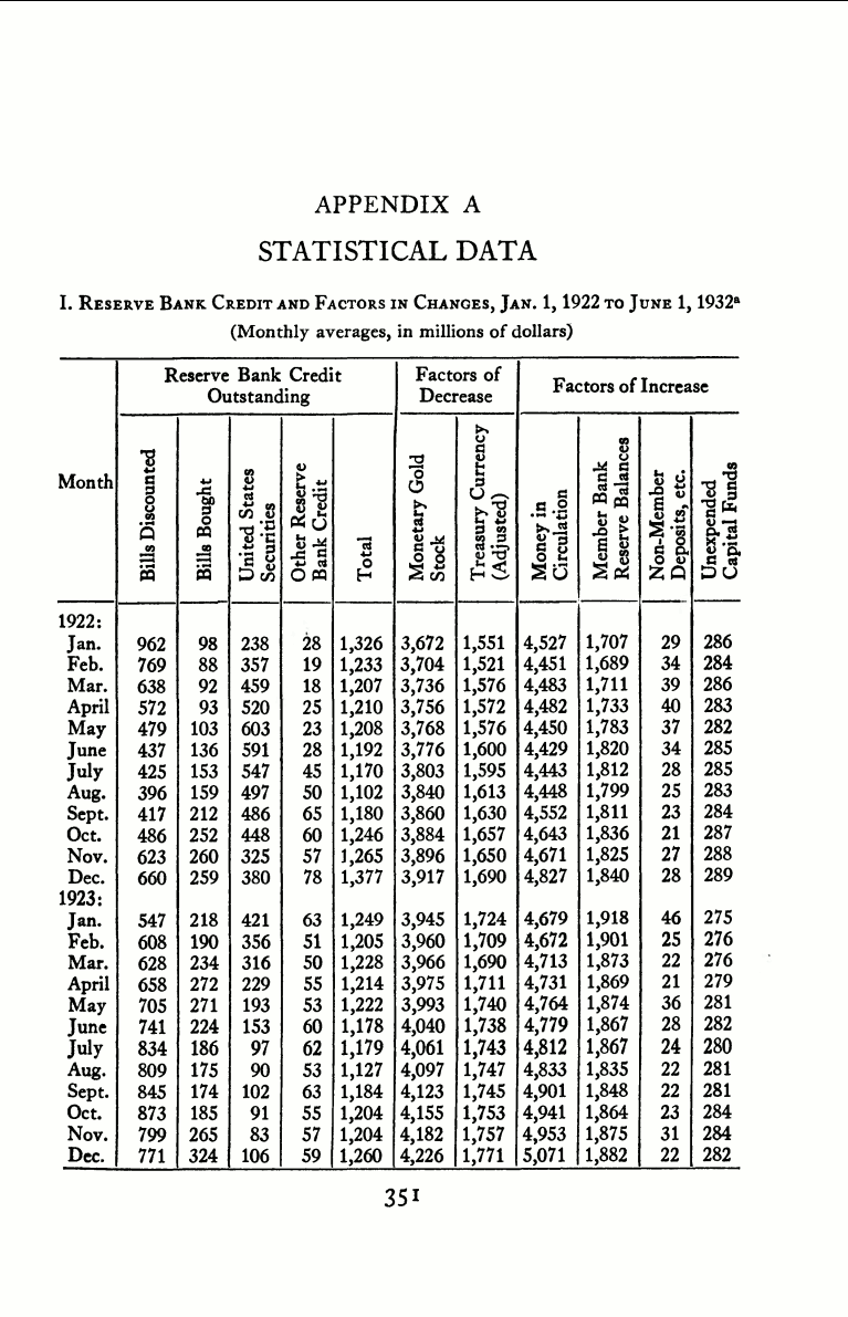

Here is an example of a table I "verticalized" + some more JPG-PNG examples.
Original Page from the PDF:

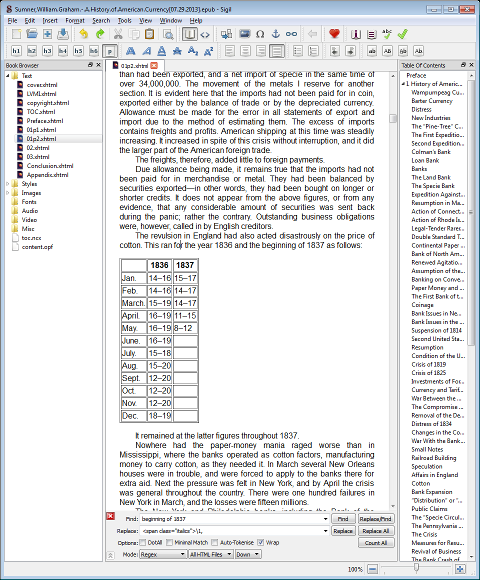

Here is an image of my "verticalized" HTML table in Sigil:

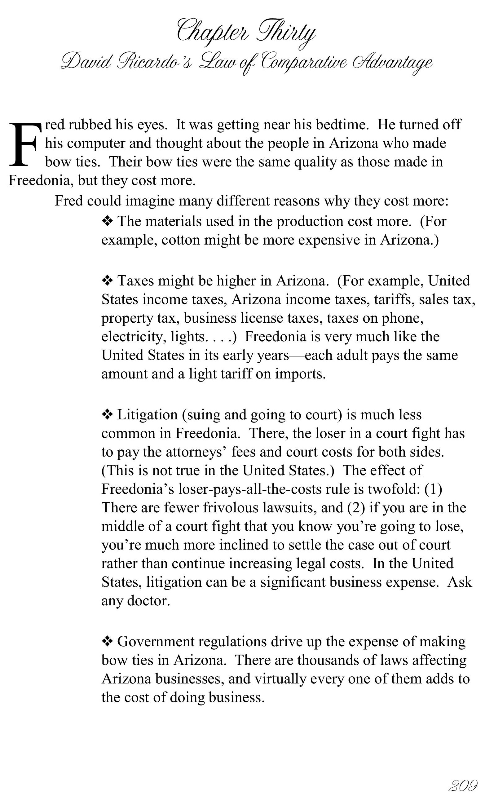

Here is a real life example of the horrible conversion/JPG artifacting you might run into (and the HUGE filesize of JPG compared to PNG):
Original image was done by the author, and was probably generated by some sort of crappy PDF -> image conversion (800+ KB JPG). Artifacting left and right, and that filesize should make you gasp!!
I got the source document from the author, and was able to generate a PNG (42.9 KB)):
I must admit, it was a "lossy" PNG conversion since I Indexed it to 4 gray colors.

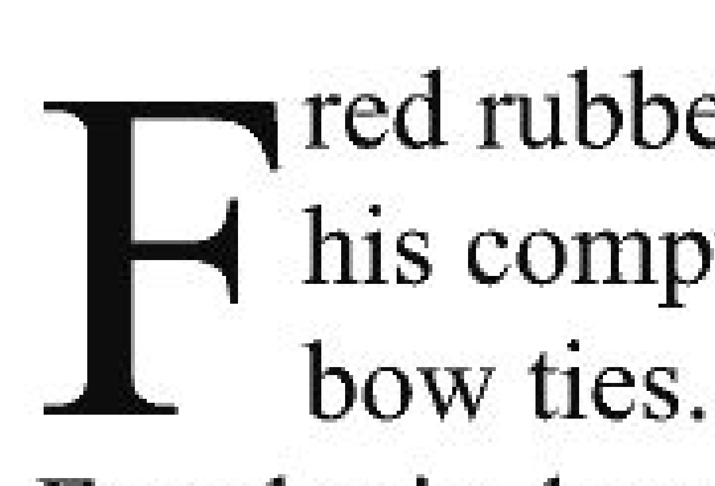

Artifacts between PNG + 90 JPG + 80 JPG:
ID:	111782Click image for larger version
ID:	111781Click image for larger version
As you can see, the "halo"ing gets worse and worse the lower quality you go with JPG.
