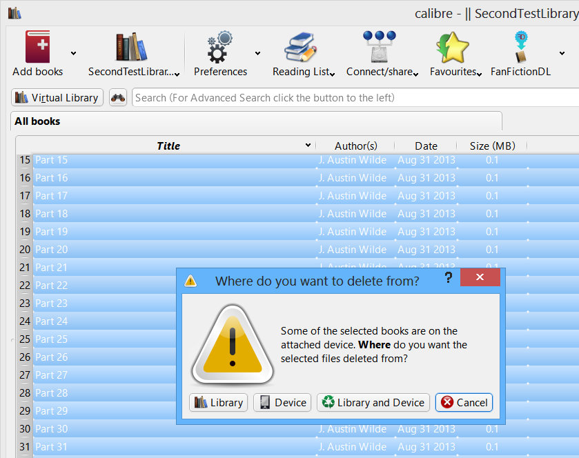

I recently switched from a Win7 laptop to a new Win8 one.
On the new computer, when I eject my Nook STRg, it doesn't eject completely, if you will.
The Nook still shows the 'USB Mode' screen, and calibre sorta still thinks it's connected. See the attached image--after I ejected using calibre, there's no Device icon, but if I try to delete a book, I get the delete confirmation for when there is a device attached. I have to physically unplug the Nook to prevent that.
Since it still ejects completely as I expect on the Win7 laptop, I suspect either it's a Win8 issue or a USB driver issue of some kind.
Does anyone have any ideas or advice?

I would wonder about it reporting as a NOOK_COLOR while the User-defined device info says NOOK_SIMPLETOUCH, but it reports as NOOK_COLOR on the Win7, too.
On eject, I get:
Eject failed: [Error 2] The system cannot find the file specified
But only when the SD card is in. Without, I don't get that message, but the same behavior still. And I also get that message on Win7, too.
I know some of the output above is from plugins, so I ran with --ignore-plugins, too. No change.
If I eject each drive (the SD card and the Nook) as drives first, it disconnects as expected, but the drives remain defined with media removed. (This is how B&N says to eject.) When I eject from calibre, the drives themselves are removed from the system.
This all seems so familiar that feel like it's a problem I solved on the last computer, too. All I remember about it is that I had to plug it into the SS-USB port and not the USB on the other side. I'm using ports labeled SS-USB on the new one, too...
