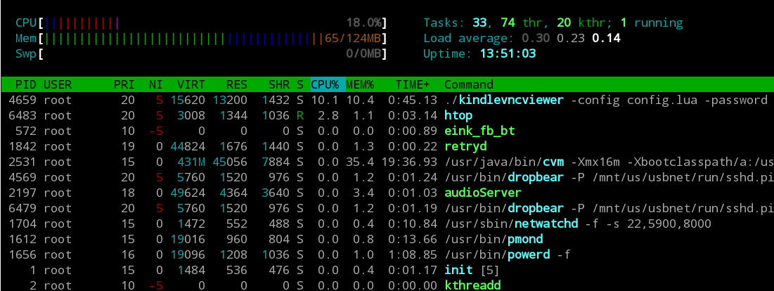

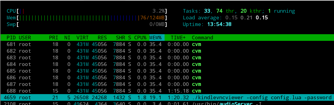

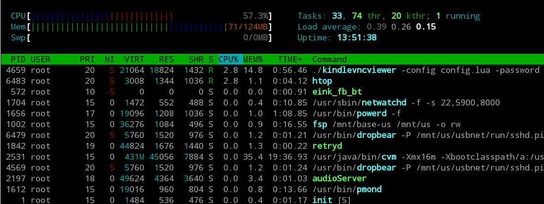

The following in response to twobob's PM -- some metrics:
I'm connected via usb, RNDIS/Ethernet Gadget.
I first ssh'ed into the kindle; then ran vnc.
I ran htop (I had actually assumed that there'd be no sort of 'top' on the machine!); some results:
CPU usage:
While scrolling a pdf at normal reading speed, CPU usage is around 40-50%. Scrolling faster, it climbs to 80%.
A moderate typing speed with nothing else moving on the screen uses about 60-70%.
kindlevncviewer accounts for the cpu usage almost exclusively.
MEM usage:
64 out of 124MB appears full; this hasn't changed at all in about an hour. Before that (when I first ran htop, after a session of maybe 8 hours) it was around 90MB, I think.
kindlevncviewer uses 4.3% of the memory.
The rest appears to be claimed almost exclusively by a certain cluster of processes starting with 'CVM', launched like this:
/usr/java/bin/cvm -Xmx16m -Xgc:youngGen=1m -Dsun.awt.exception.handler=com.amazon.ebook.framew ork.impl.device.event.EventDispatchThreadException Handler -Xbootclasspath/a:/usr/java/lib/localedata.jar:/usr/java/lib/charsets.jar -Dsun.boot.library.path=/usr/java/lib -cp :/opt/amazon/ebook/lib/JFEP-0.1.0.jar:/opt/amazon/ebook/lib/journal-update.jar:/opt/amazon/...........and a whole bunch of other java thingies.
Also -- 'fsp' runs with the following options:
fsp /mnt/base-us /mnt/us -o rw,nosuid,nodev,noatime,max_write=65536,max_readah ead=65536
Also -- launchpad is running, though it's not using any resources.
Perhaps relevant -- I'm on OS X 10.8.4; the screen is set to greyscale; the display is the 1680x1050 version; vnc shows the upper left hand corner (I arrange the windows accordingly.)
It's embarrassing that I have to ask this, but I'm not sure how to extract information from the xterm window, aside from this somewhat qualitative description.

Thanks again for all the suggestions. I'm a bit puzzled now:
The vnc client clearly isn't taxing the DX's hardware; and the sluggishness is definitely due to the RFB server (but I don't know what to do about it; the -encodings parameters didn't make a difference; I can't find any settings on my vnc server; but anyhow).
Then while aimlessly surfing about, I came across the instructions for the 'Kindleberry Pi' (I have a Raspberry Pi as well; though I haven't tried anything with it yet.) -- wordpress link to the K-Pi. This is basically a recipe for using a Kindle screen as a console for the Raspberry Pi; so, following the instructions, I ran myts on the DX, and ssh'ed into my laptop; then I used tmux to take control of DX's ssh session from my laptop's keyboard.
The author of those instructions has a youtube video, where he's demonstrating, *on a K3*, the refresh rate of the screen while typing. Here's the video:
My tmux session, on the other hand, was just as sluggish as the vnc.
So this makes me wonder, again, whether it's the DX's hardware that is at fault.
